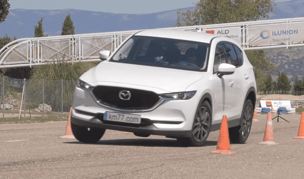

screenshot showing full compression of the front left, so much so that the rear right lifts (not good for an SUV)

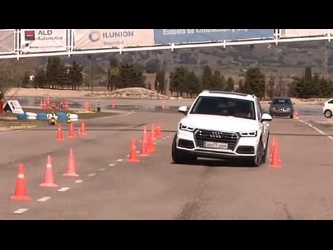

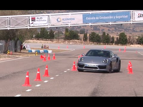

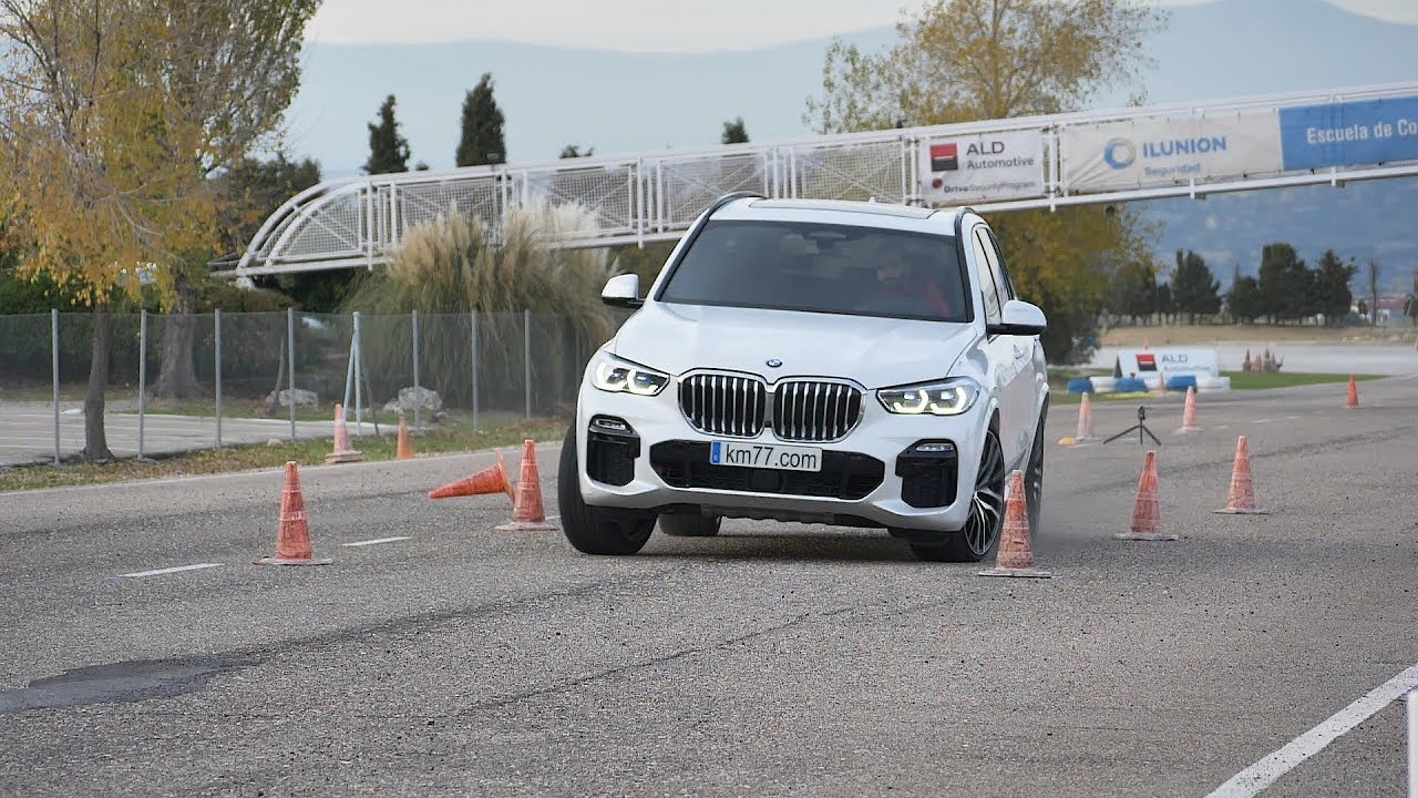

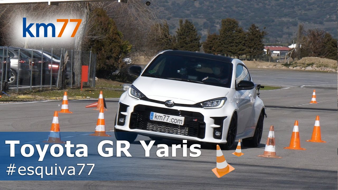

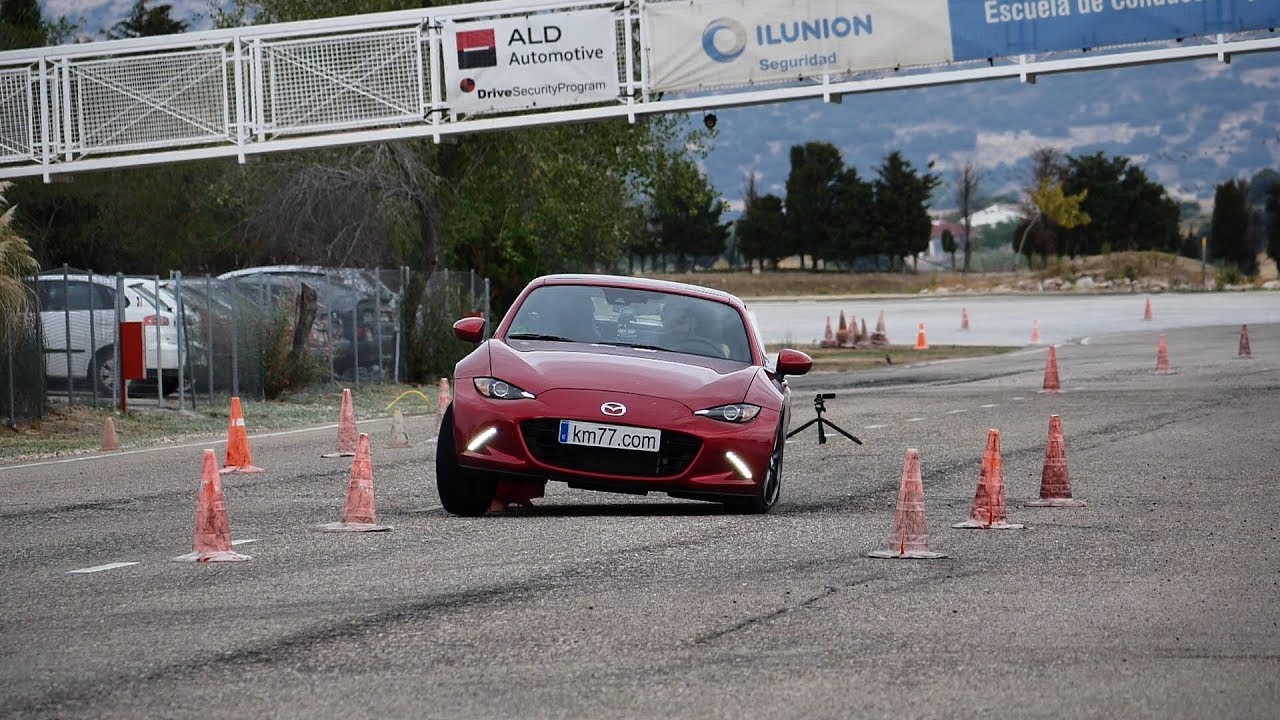

Based on the 'moose tests' 47 mph swerve/lane change, the CX-5 seemed to have fared pretty well compared to other vehicles. But, it still dives pretty hard, and raising a tire on an SUV is not a good thing.
Several moose test videos to see/compare how the different vehicles respond.
CX5
BMW x3
BMW X5
Audi Q5
Mazda Miata
VW GTI
Toyota GR Yaris
Porsche Turbo S
My plan is a 2" drop with bilistein b6 setup and a rear bar. Wheels are going from 19x7 to 19x8.5. Tires from 225 to either 245 or 255. Then I will be moose testing.

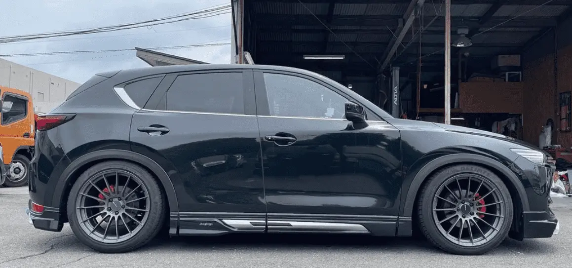

I'm chasing the same setup I have the Corksport spings, Bilstein B6, and adjustable control arms ready to be installed later in the spring along with the JB4. I'm also researching wheel options, probably going for 20" with 245/45R20.
Digging these, but $600/wheel isn't in the budget
CX5
BMW x3
BMW X5
Audi Q5
Mazda Miata

That's why I tell people a RSB on a stock height car is a waste. There is still too much suspension travel. A lowering set even the H&R (which work well with stock dampers) work fine.
The body roll in that video is laughable. With the right set up you can pretty much eliminate the chance of that happening, aside from impacting something.
