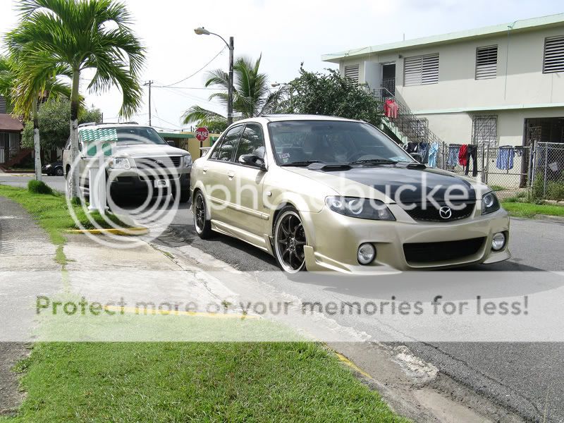

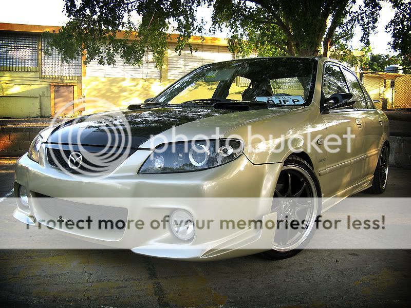

And the results
^^^Nice! Is that your car?? Yah, I have the MSP front lip so I dont have any stock fogs so I am going to have to do something different. I might mount two rectangle style fogs on my lower grille instead. Cheaper and less time consuming. lol
Yup, that's my car.
Should have the fogs in as well as the projector headlights in late next week.
