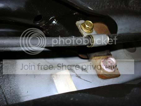

when you're under the car you'll see the brake cable and bracket are in the way of getting to one of the 17mm bolts, remove the bracket with a 12mm. after that un-bolt the 17mm bolt above it.
go nearly about a foot towards the rear of the car after and un-bolt this 17mm bolt as well. don't lost the washers, it's best to re-use them along with the old washers.
