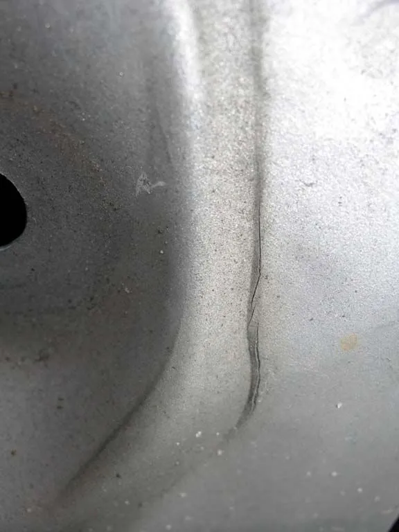

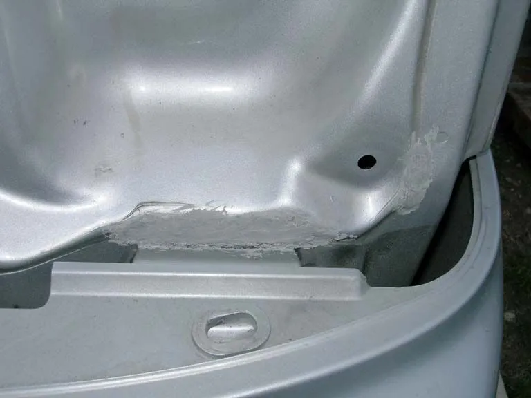

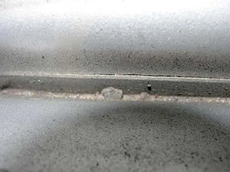

anyway, according to M-Tip 3245, trunk leaks on the 3rd gens usually are the result of the body seams being cracked due to a minor collision, not the weather strip itself.... my car had a love tap a couple of years ago and so I decided to get off my ass and pull the tail light out and check because the rainy season is here..... :eek:

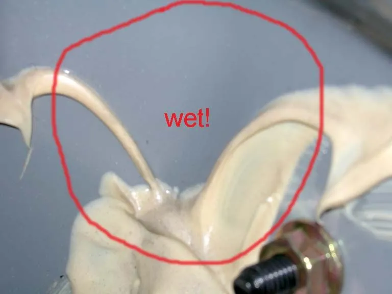

as you can see, the seam sealant had cracked resulting in water leakage...

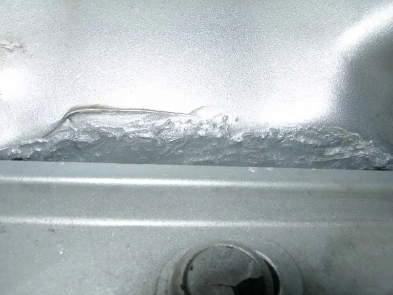

first I sprayed the area with adhesive cleaner to remove whatever oil and dirt there was
and very quickly I was able to see that the cleaner went into the trunk... it's hard to see in this pic but it was wet when I took it!

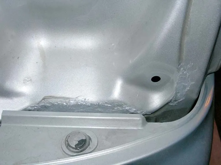

next I applied body seam sealer around the affected areas and smoothed it out with a putty knife... yes, I half assed it because you won't be able to see it once you put the tail light back on

finally, after letting it dry for about an hour (it takes 6 hours to cure), I applied liberal amounts of touch up paint over the sealer to prevent erosion
I'll see in the next few days when it rains again if this really fixed it, I'm pretty sure it's fixed

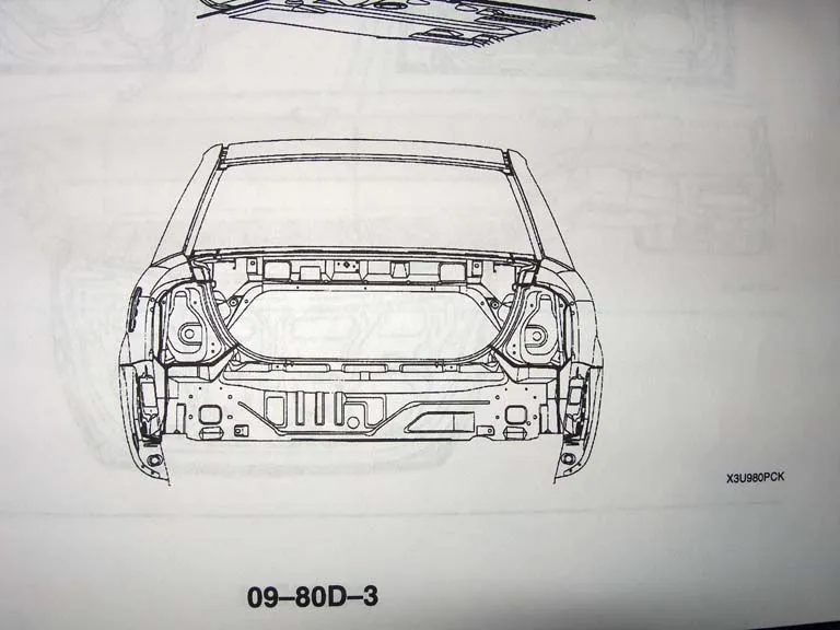

this is where seam sealant exists in the rear end of the car... check those areas and fix as needed

1: in that picture from post #5, are the bold black lines where the seam sealant is?
2. I assume once you take the tail lights out that the stripping used for them will need replacing? what do I use to replace it?

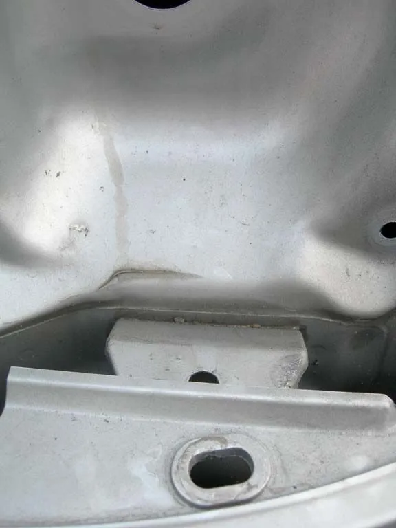

When I was cleaning out my trunk on my Protege and vacuuming, I noticed that there was some water on the drivers side indent of the trunk. I vacuumed the water out, and after a car wash it was fine. After a couple of rain storms I noticed a bit of moisture had occurred in the spot again. It was only a quarter or half inch or so of water in that one spot shown in picture 2. Just wondering if any of you have had this occur, or know of where the water could be coming from. Thanks!
Here is a picture of the general area on the Protege where the moisture is.
Here is a closer view of the area which is wet.
