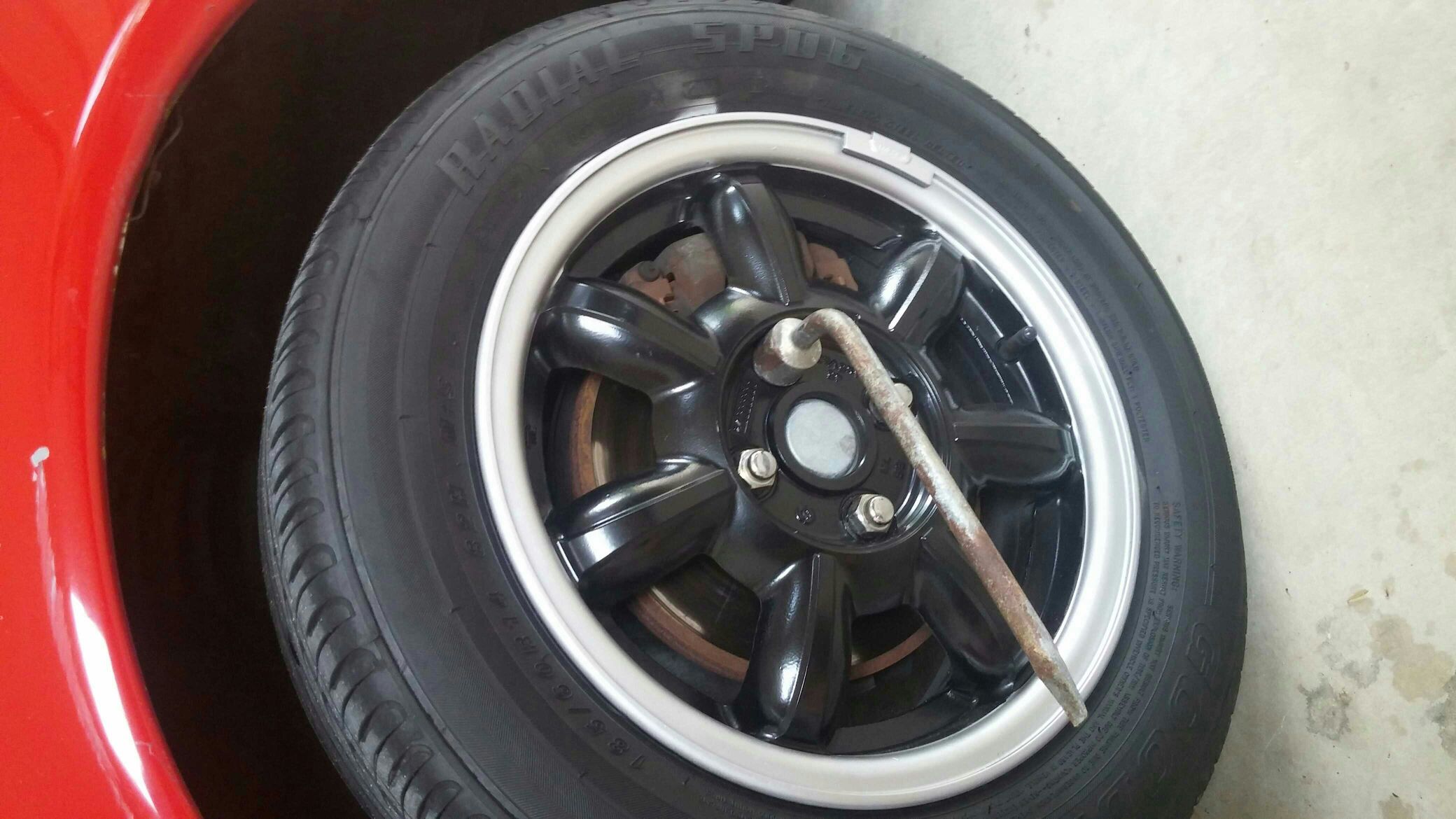

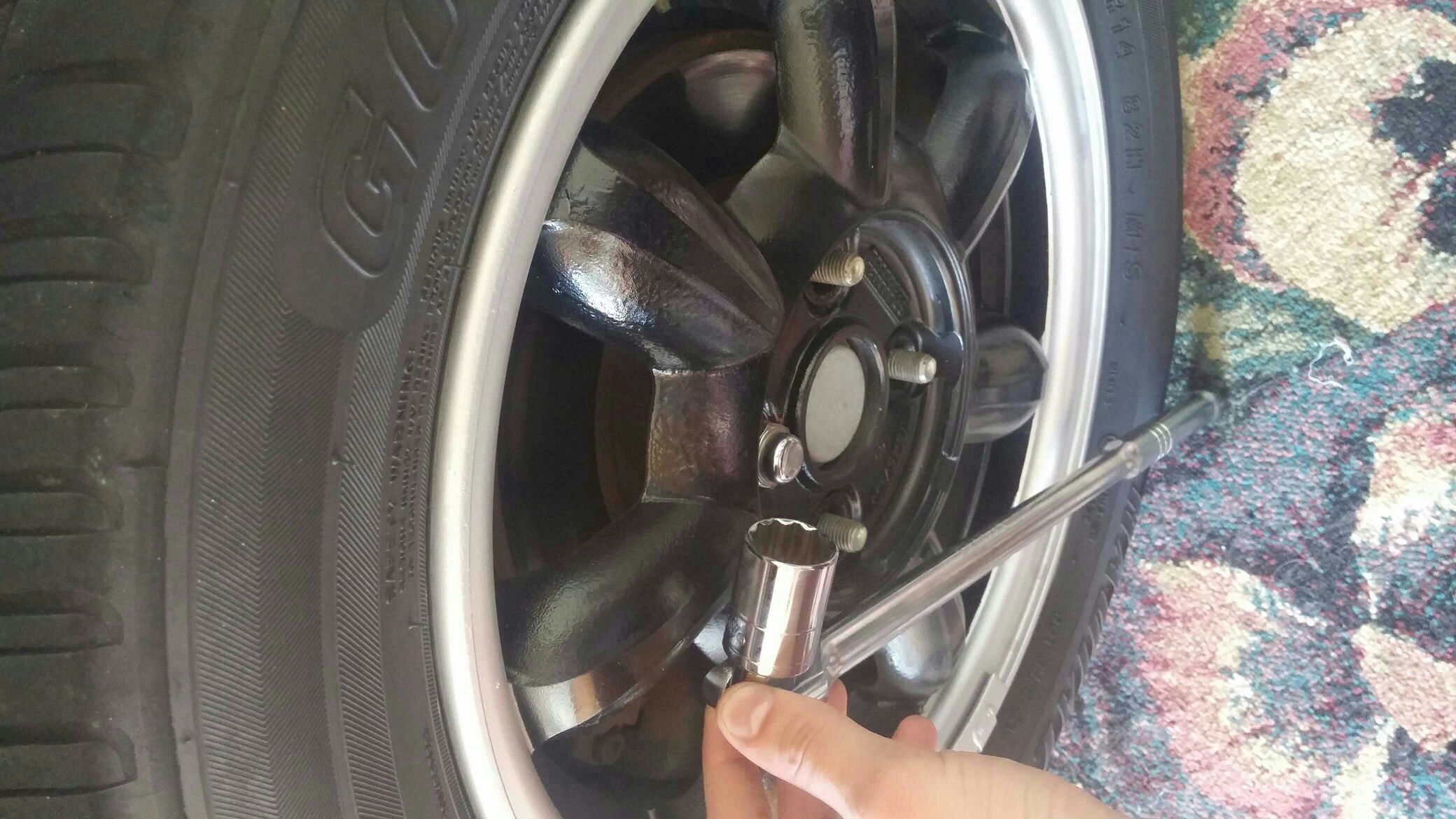

Now, your going to want to remove the wheels to get access to under the bumper. So get out that tire wrench and knock those lugs lose.
remember to leave the top lugnut on till the last one, to keep the wheels from falling off.
Now I wasn't able to use the lug wrench, so I used a 21mm with an extention, but if you have the muscle power....go for it,

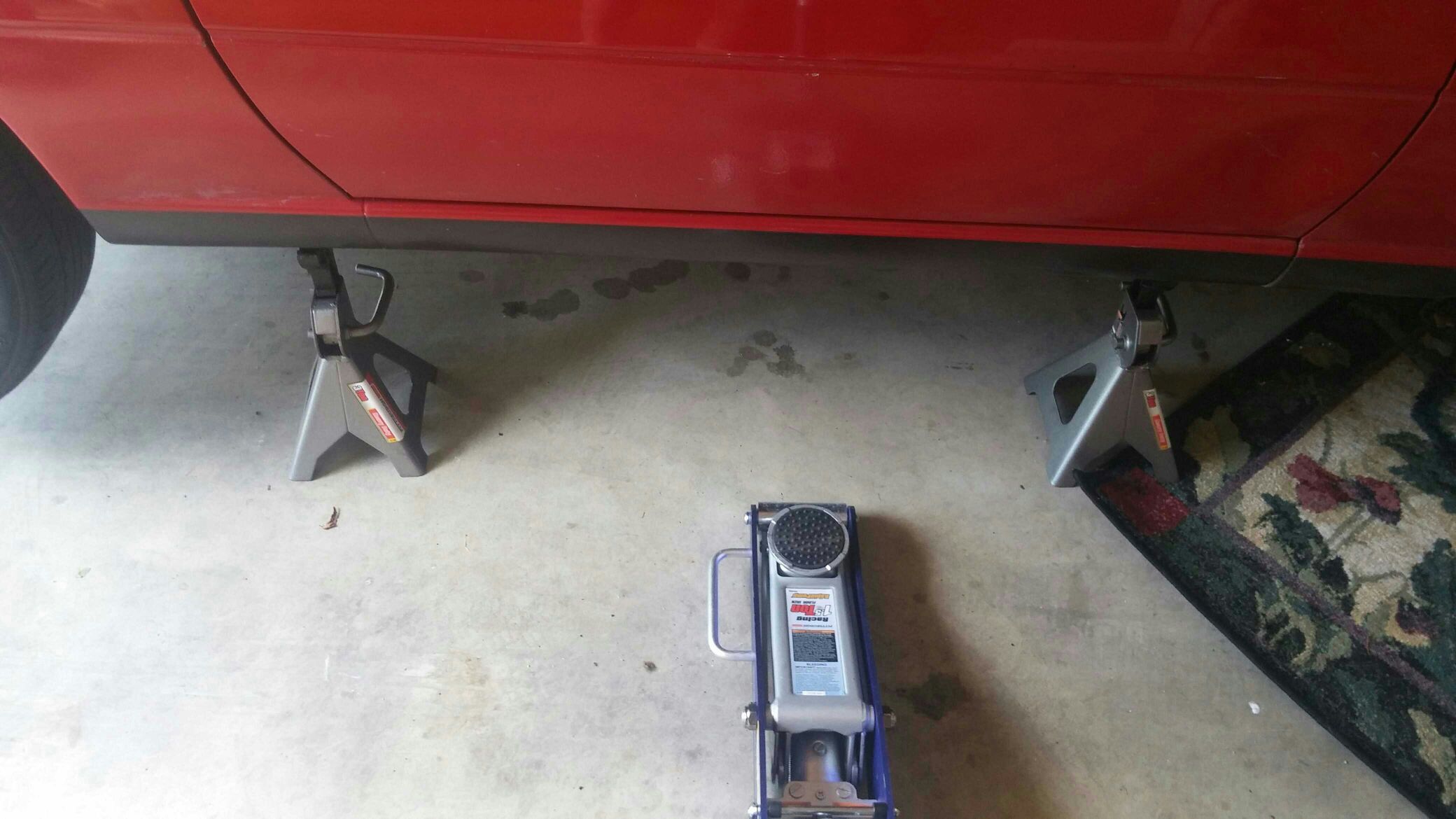

Now your going to Jack the car up, I used a 1.5 ton low profile jack and 4 Jack stands. I used the pinch welds to hold it up because my frame rails don't look the best (rusty and bent)
Jack it up to a height comfortable for you, and put the stands down under the pinch welds.

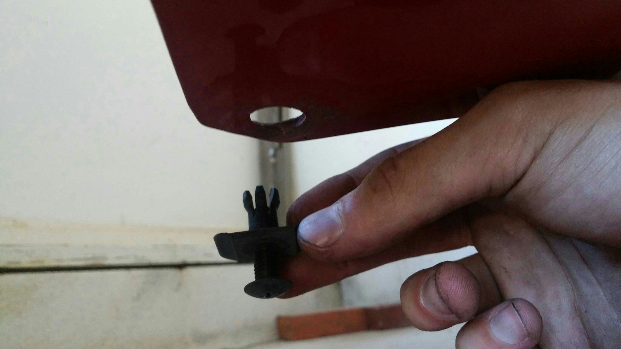

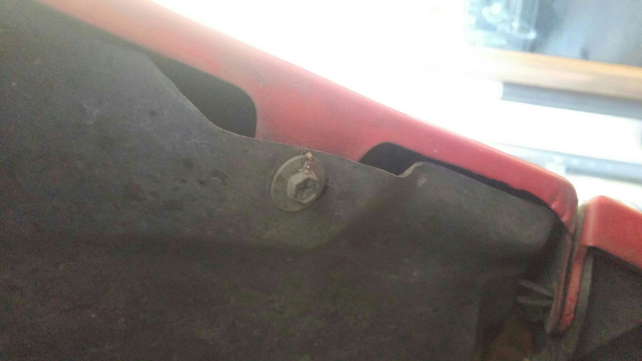

there are 4 screw clip things to get out, to take the top air guide out.
I unscrewed them, and used a flat head screwdriver to pry them out. Now remove cowl. Now you exposed 6 10mm bolts along the top.

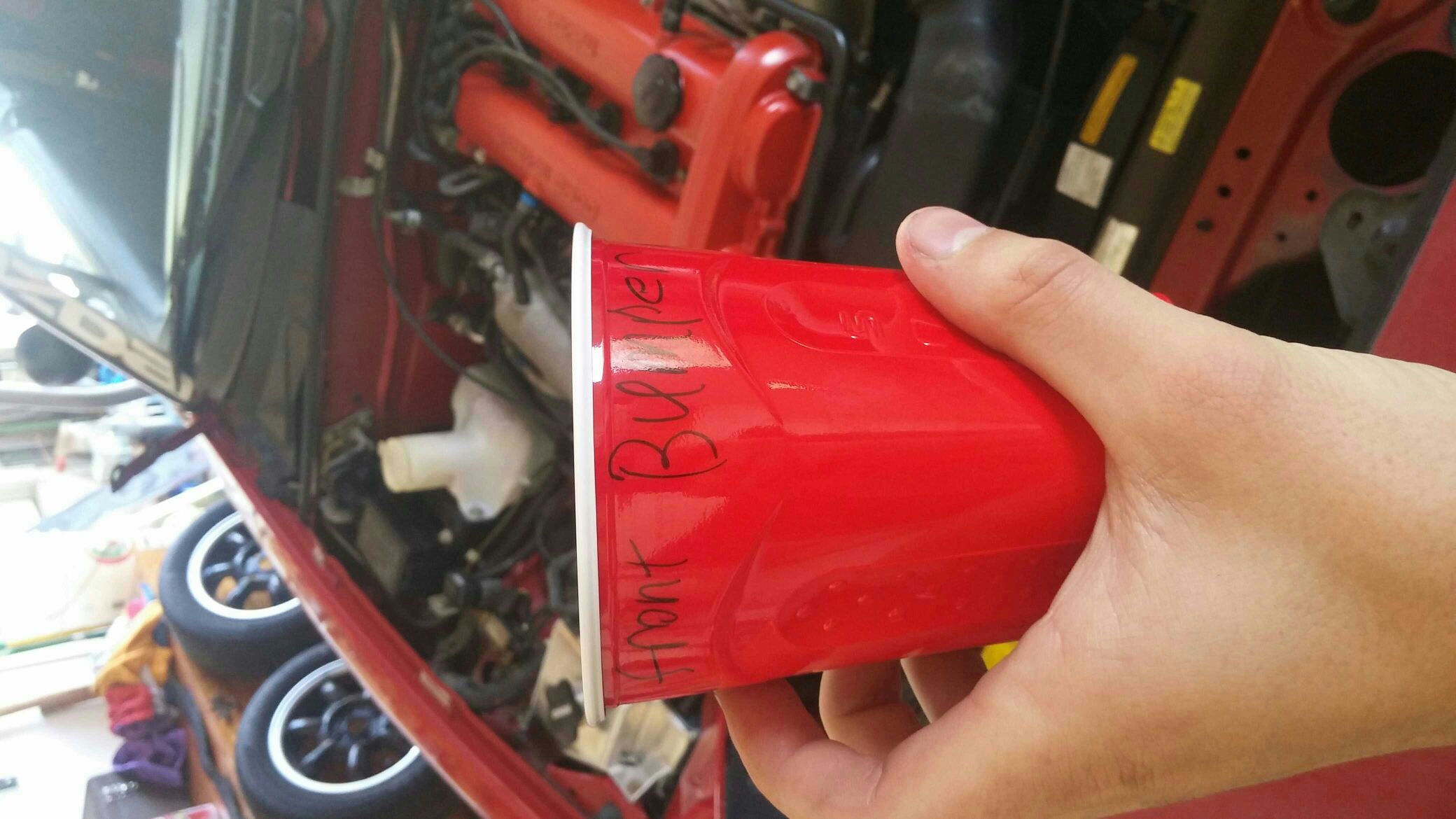

remember to keep track of all your bolts, I put mine in labled red solo cups. 😉

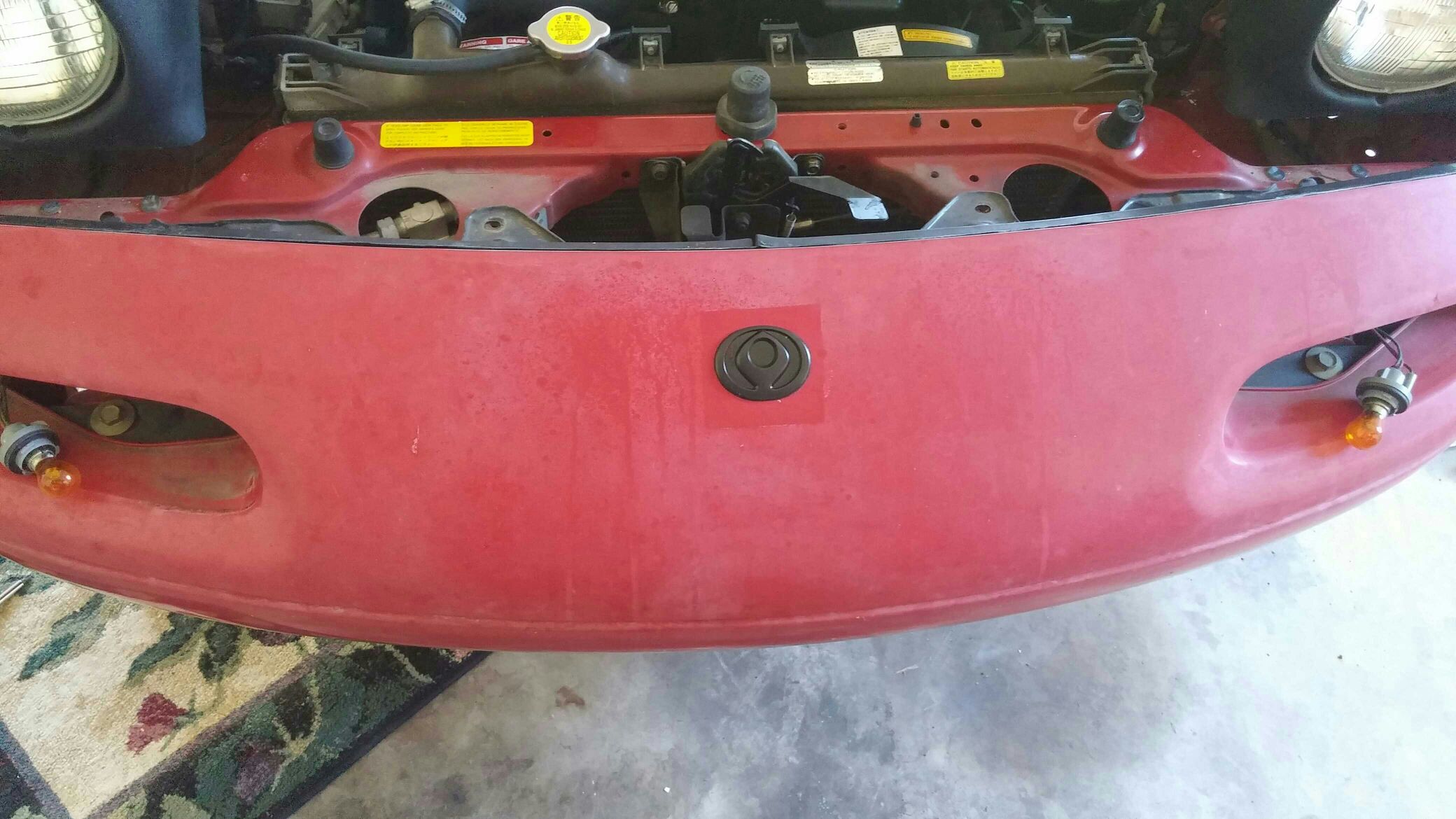

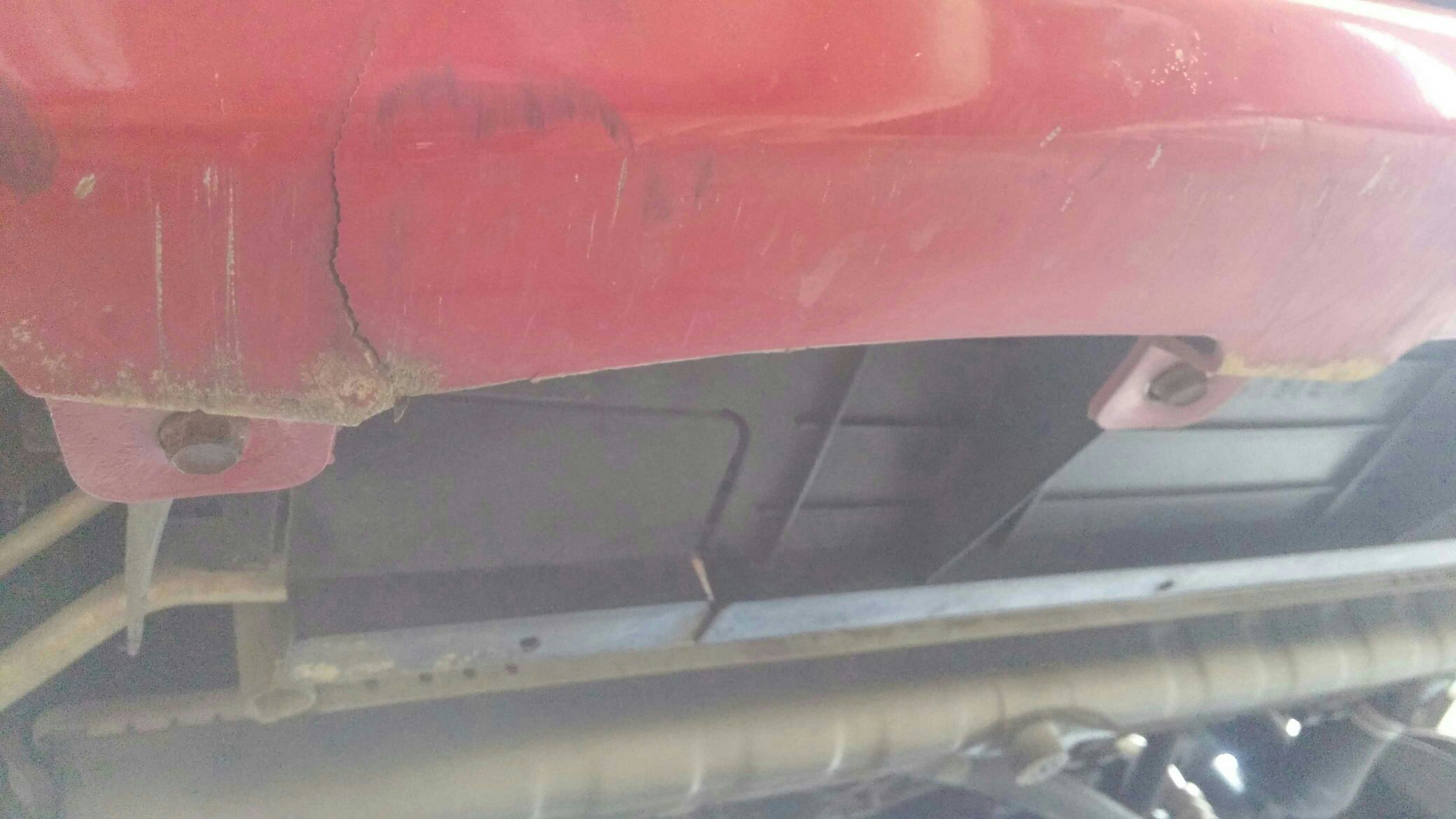

Now there are 4 10mm bolts under the front bumper in the middle. So 10 in all. Don't worry about the bolts to the sides, with the cross bars.

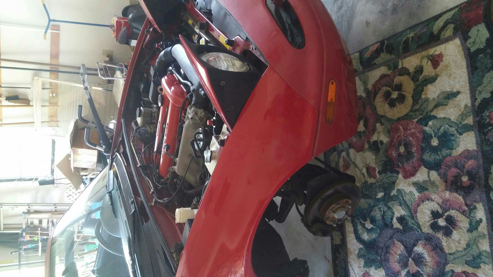

I found a crack in my bumper, so I'm adding that to the list of parts to replace. Now under the wheel well, your going to remove a cover on the top, with 5 8mm bolts with one hiding under the side skirt, one 10mm bolt on a crosbar, and 5 screw clips. And it's the same on both sides.
with both covers out of the car, you should be able to see up into the fenders.

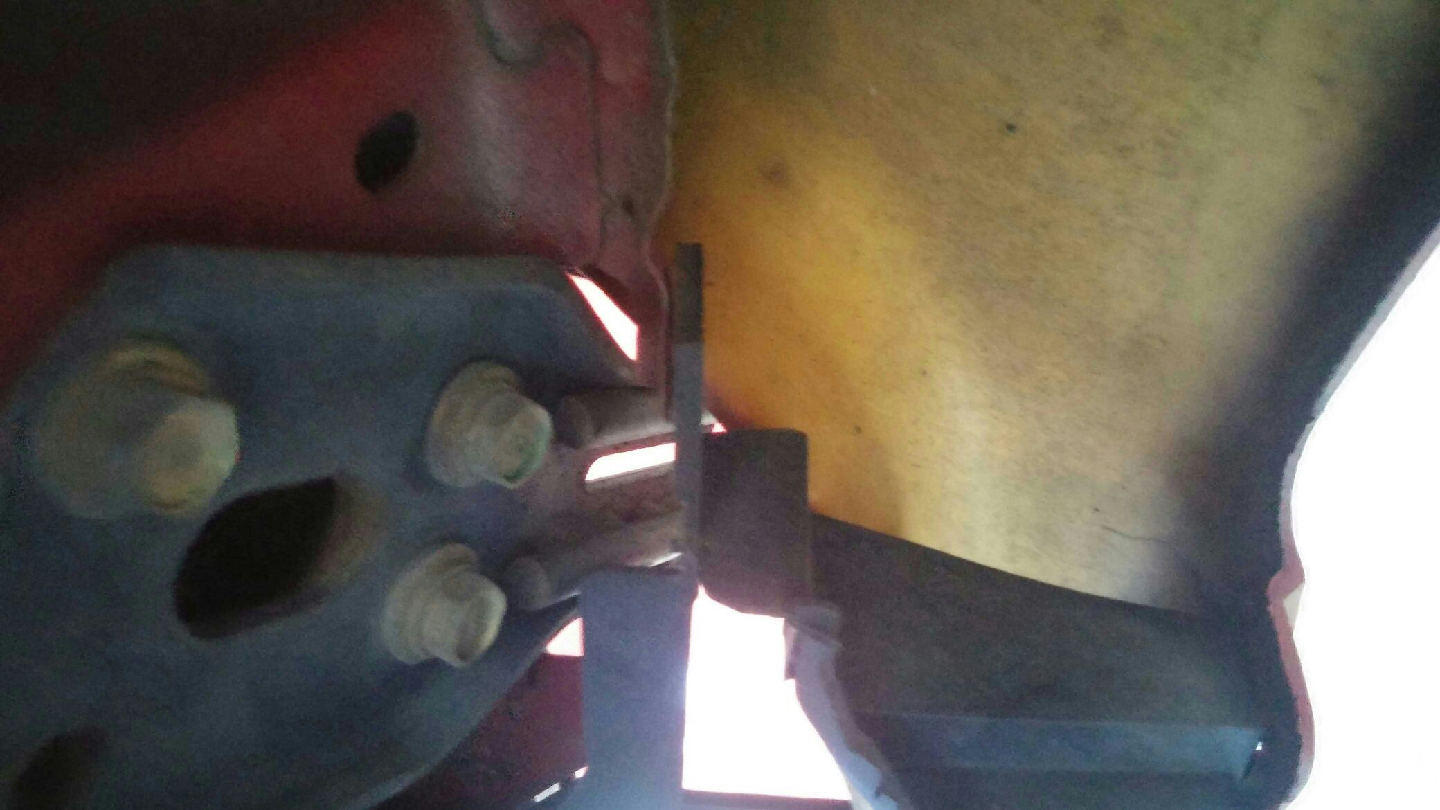

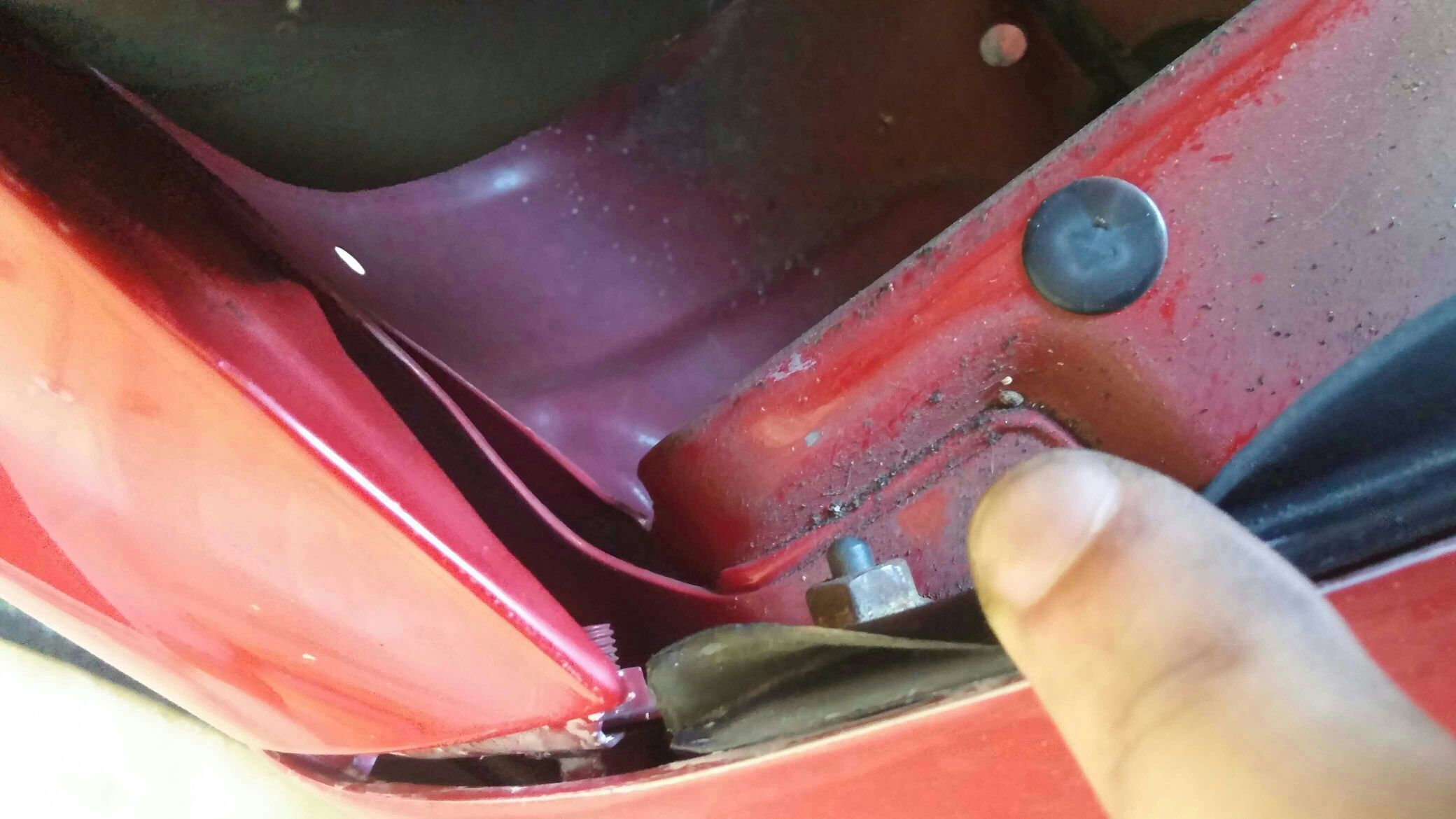

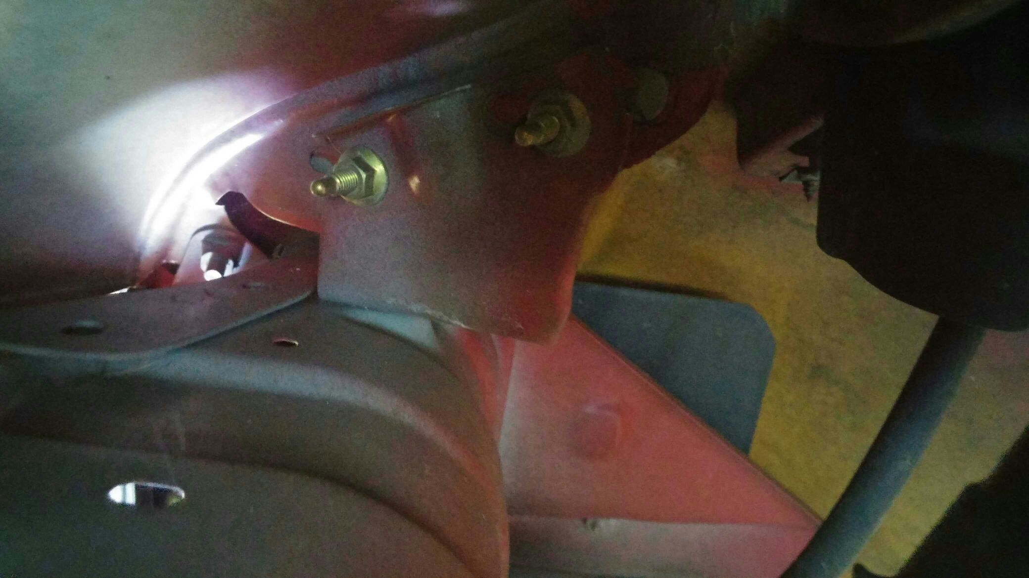

you can't see it vary well, but there are 2 gold bolts up there. These bolts are indeed, size 10mm your going to need an extension with these. I used one a bit less than a foot. After those, there is also another 10mm bolt right here, under the tow hook. Both sides the same.

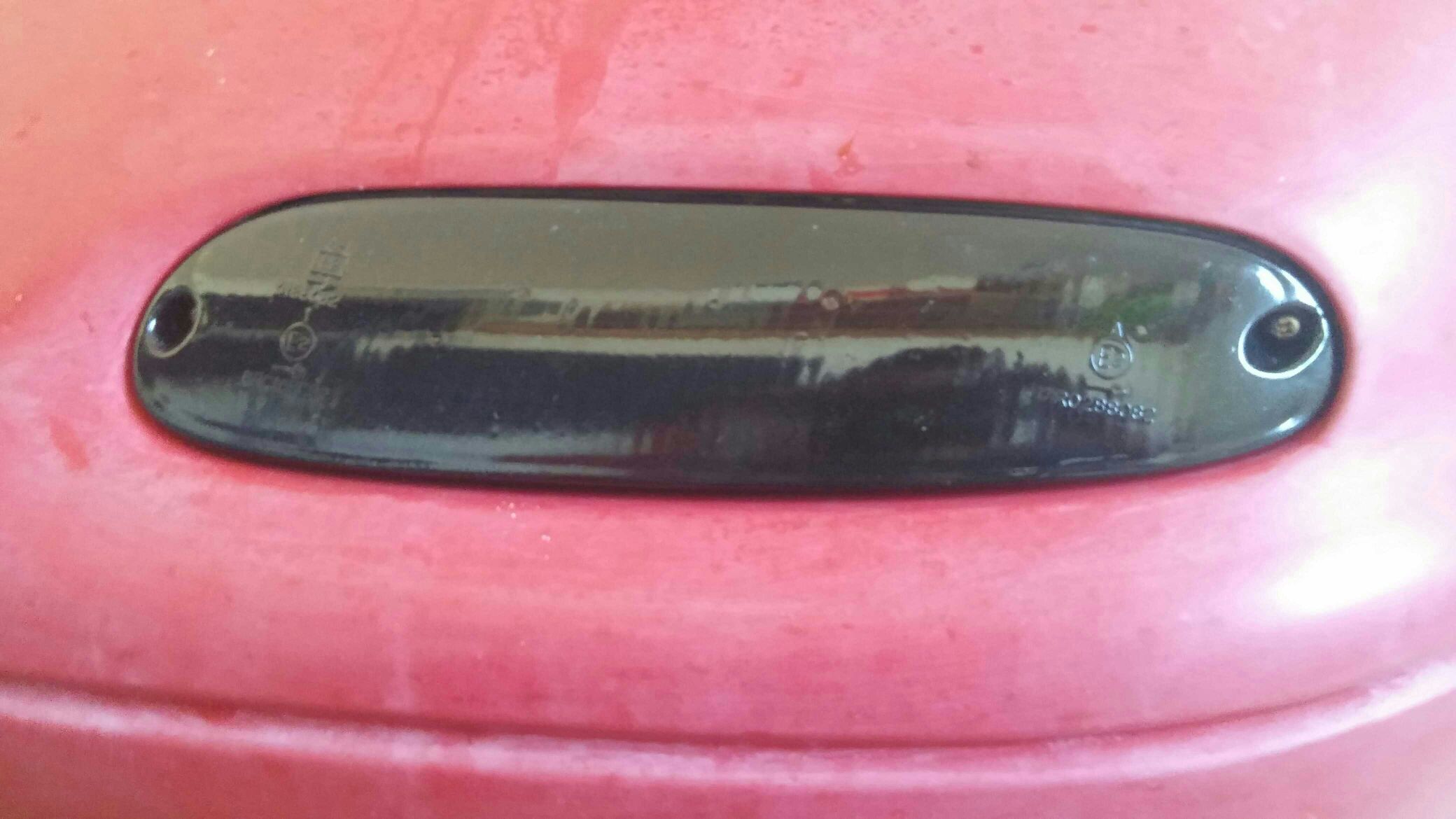

nows your chance to remove any lights you want to take off, all the light removals are pretty easy,

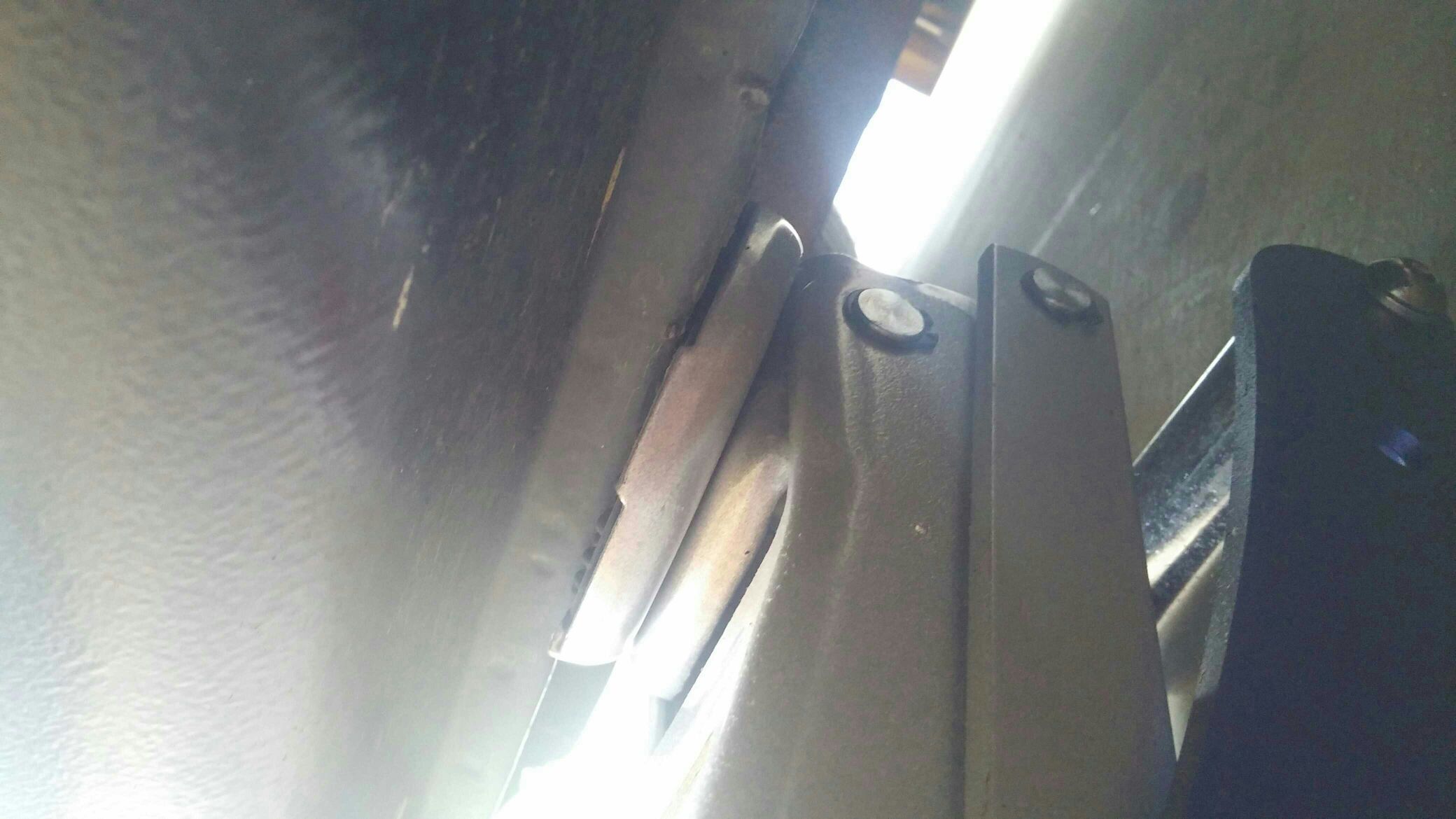

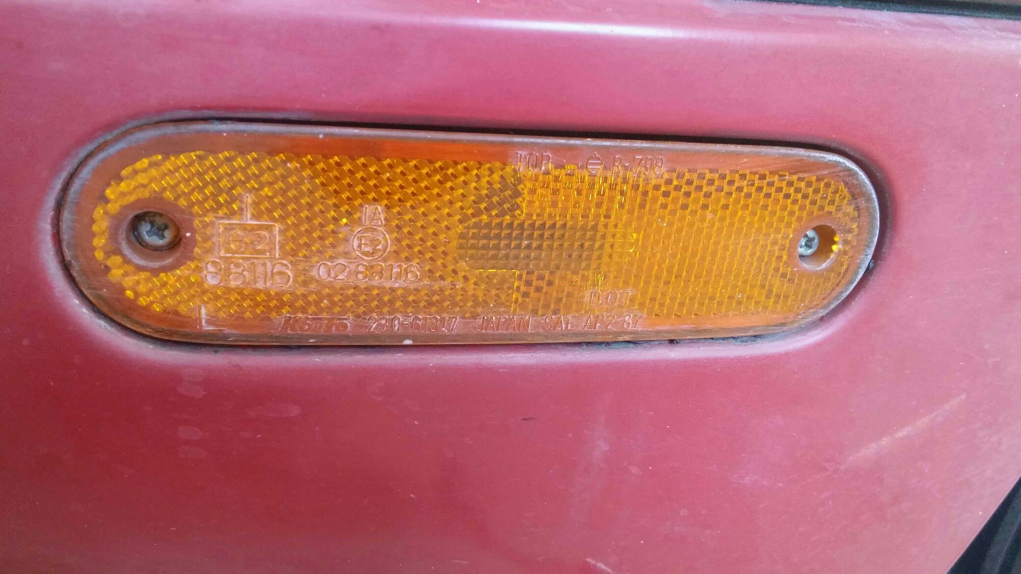

2 screws here,
And two screws here,
all Phillips. Now is a great time to change bulbs too. I'm not doing that now. I am removing all the lights though. Now that your car looks like a parts car,
make sure you get these screw clips in the top of the grill, I don't have pictures, but I have to rip them out Because they wouldn't turn.
there are only 2 bolts left. In front of the headlights, in the vary corner are....you guessed it! 10mm bolts
Now the bumper is off. What a project. Sit back, grab a coke, and enjoy.
