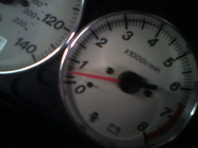

let me show you guys picture... I think it's pretty low..
Chris, that's actually where the idler is set for the automatic. I asked my dealer about this as well - 600-800 rpm idle is the norm for auto's after being warmed up.

really? that relieves me little..but my rpm is at about that level when it's parked and when it's in drive mode it drops 1 line below.
:( if it was just low idle then I wouldn't really mind but my engine tried to stall when I was at parking lot and when I was at stop sign...
do you know if EGR valve is covered under emission warranty(80k)? and how do you read rpm below 1K?

My idle is lower with the car in drive than with the car sitting in park as well. If it's trying to die, I would seriously get that EGR valve looked at.
But 500-600 on a manual tranny car... and if I rev it when the RPMs drop they drop too low and it stalls.
