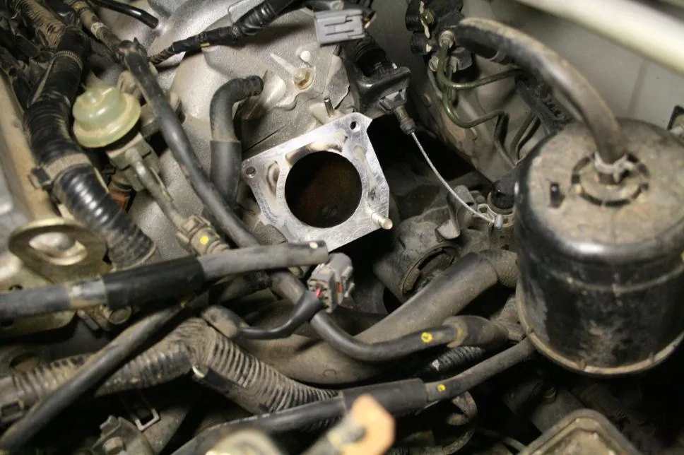

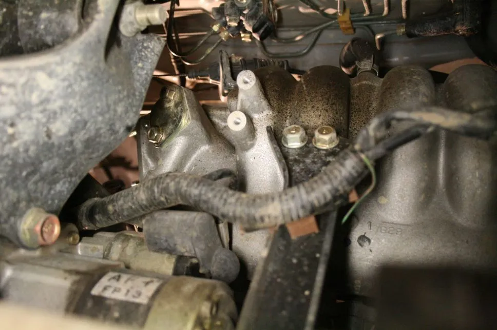

Hi all,
I'm new here, just been having some idle problems in my 323.. I figured it might be my EGR, but upon inspection, it seems to have been removed by the previous owner? can someone confirm to make sure I'm not crazy?
I guess it will be time to consider other possibilities, it drives fine, but at idle it sounds terrible and really rough...
