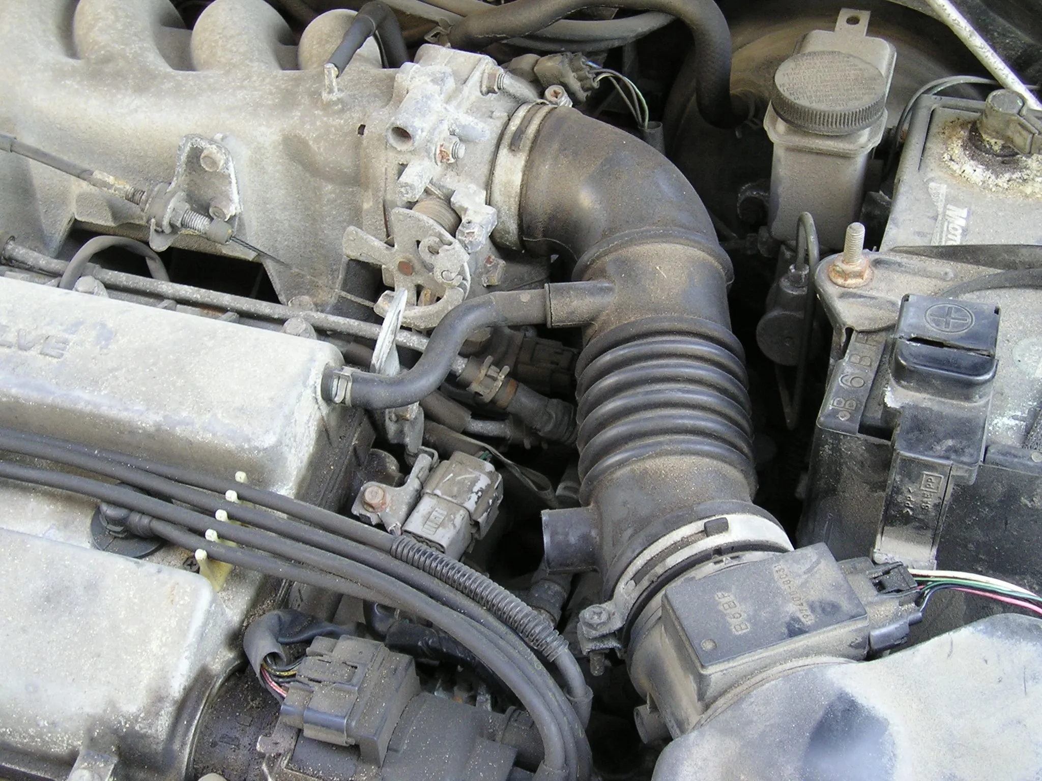

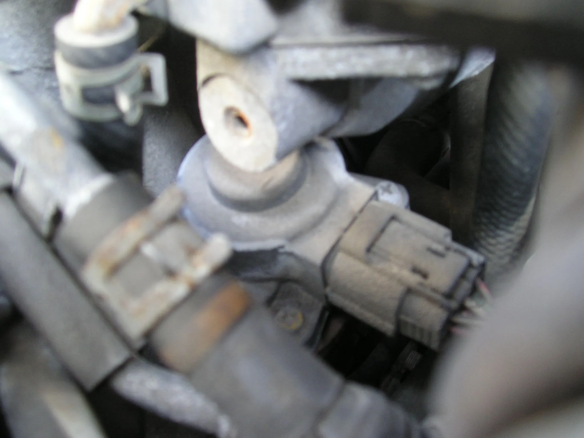

Hello everyone;
I am a newbie here posting but I do a lot of reading in this forum. I do enough to have 230,000kms on my 98 protege. I feel proud to keep it out of the dealerships hands or any other mechanic for that matter. I have had the random cylinder misfire code two over the past year. I want to go ahead and clean my EGR because it has never been done to date. I also am get some rough idling now and when I am at a stop light. Coincidently two weeks ago i passed my emissions just before i starting getting this rough idle.
I do have a couple of questions:
1) Is that my EGR in the first picture. I am pretty sure it is.
2) can I reuse the gasket after I pull it off?
3) I would rather not use a liquid cleaner but a simple wire brush bit. Is this ok?
4) Can i take the black plastic air intake pipe off of the aluminum casting (throttle body?) without any ramifications? This will give me much better access.I do know that anytime I do something I am scraping knuckles so i need the room.
I always want to be prepared first with knowledge before i touch the car. I learned how to change my thermostat thanks to this site and I think it would be similar in time and challenge. I would appreciate some input.
Thanks.

it looks like you have a 2nd gen and i really dont know much about 2ndgen as i only had first gen and 3rd. but i can tell you that my first gen had 250k miles without doing egr valve so it may not be it for you. my first gen had some problem with carbon build up where i had to get top engine cleaner from mazda and have it slowly sucked up into the intake manifiold thru a vacuum hose to clean it. not sure if this is your problems but im giving you some ideas. wire brush should be fine as long as you dont grind off any extra metal on the egr piston shaft as that will only have more exhaust blow by the cracks. when i replaced my egr valve on 3rd gen i removed thestrut bar, intake hose and battery to have more room. removing the battery will also reset your ecu and check engine light so its recommended.

im not saying this to be an asshole but you should go into the user control panel and fill out some info about your car and make a signature so it will be easier for people to help you knowing what exactly is the car you have.
