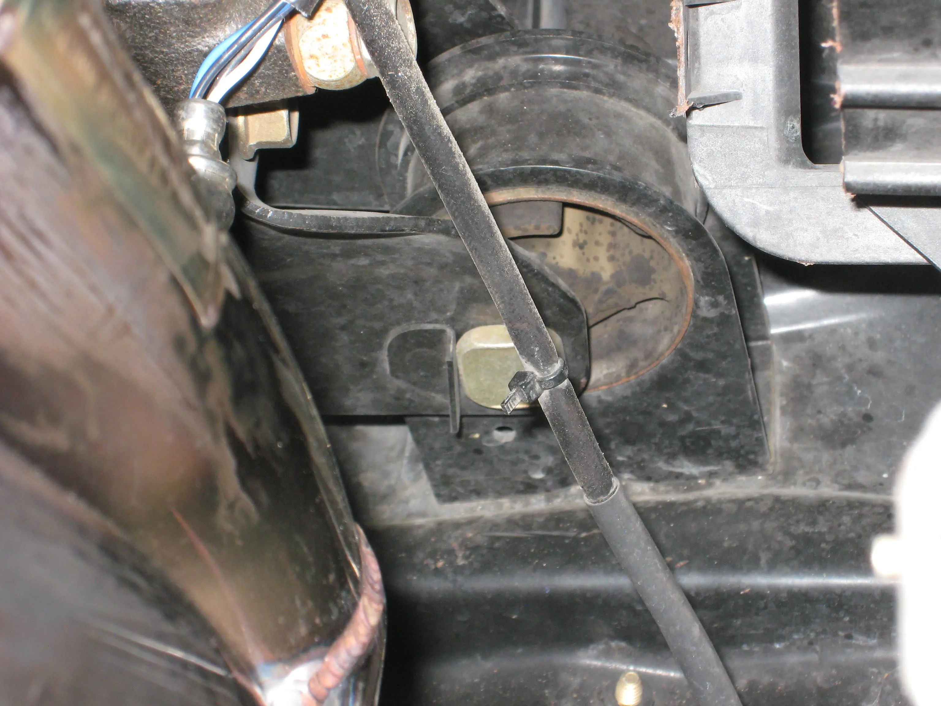

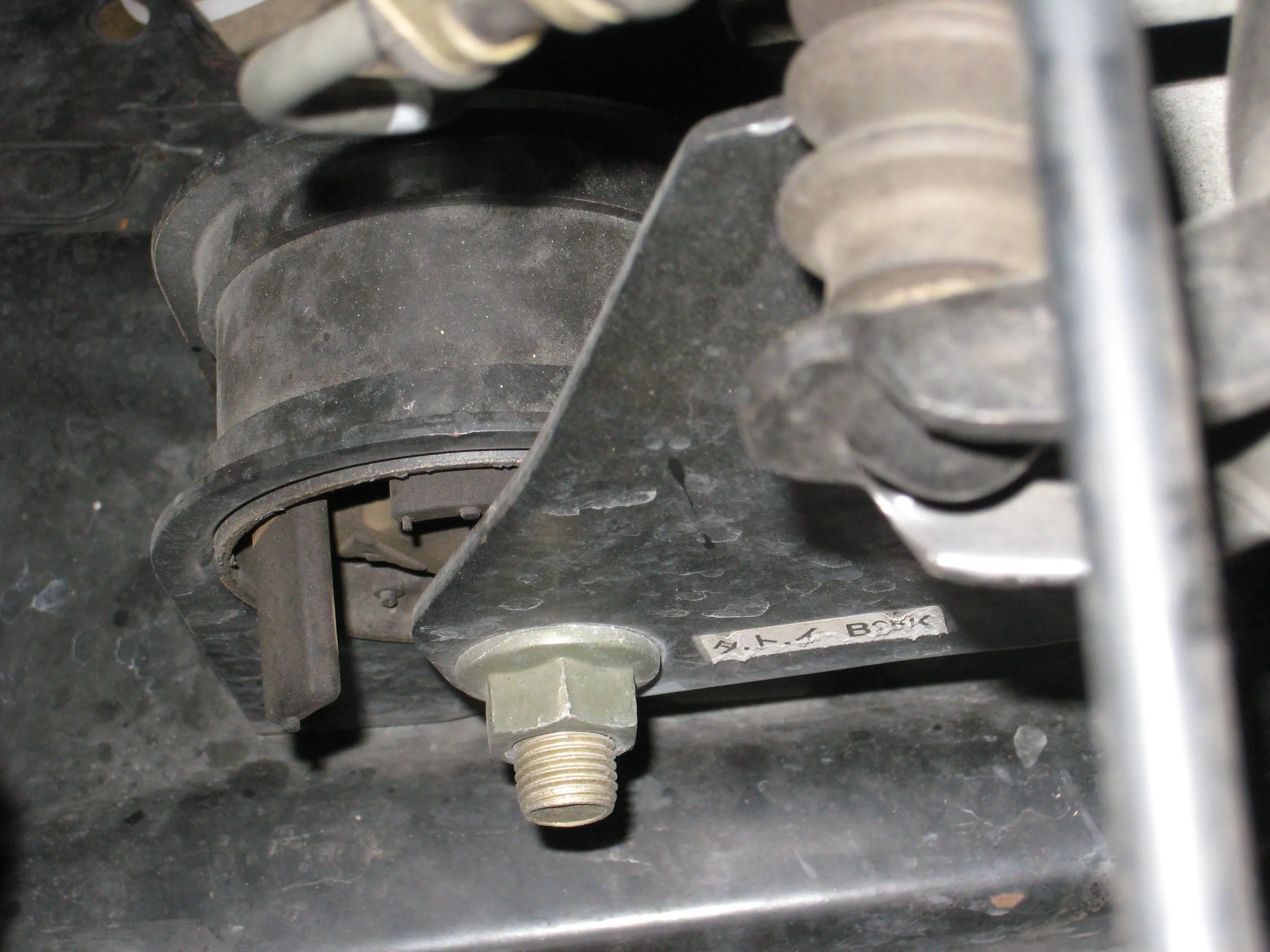

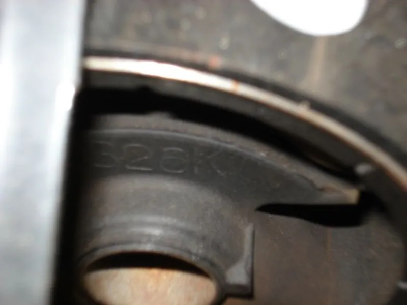

well i found a leak on the 2nd o2 sensor, i seafoamed it again to check for leaks and found that one, fixed it...didn't do anything. i think i may have town mount(s).
i got some pix and videos of what it is doing, so here they are
engine shaking- hard to tell but if you watch the wires and coil packs you can see, its easier to see in person

i dont think the muffler is supposed to shake like this?

and attached pic of passenger side mount and front mount. would the mounts be causing all this hell?? i dont see why the mounts would cause the engine to idle at the 2nd tach and make the shifter and cabin vibrate like hell and also the muffler....?
EDIT: added pictures
