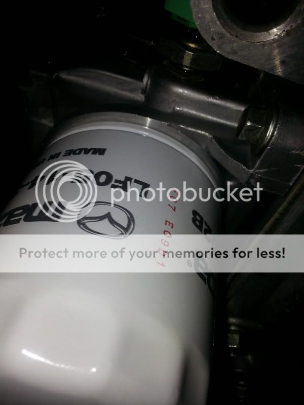

Did you by chance to take a pic of the conversion base up close?? I wonder if it might be slightly different than the Mazda one to allow the mega big filter.

I did not take a picture for comparison but I'll try to remember to the next oil change though it will be a while. I do agree about the FMC products. The FL100S filter is within less than 1/2 an inch of the underpan, so I'm sure the mega one won't fit.

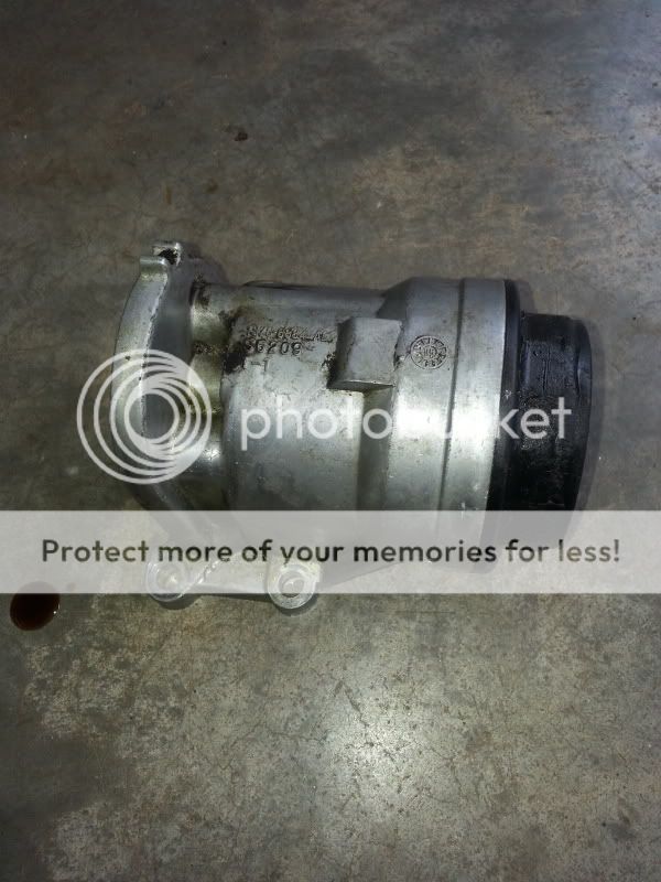

In case you want to be adventurous and try the mega filter (knowing that it "may" hang low) or just want the have an expanded/wider mounting base, here's bugger that needs grinding out. IMO, it should have came this way.

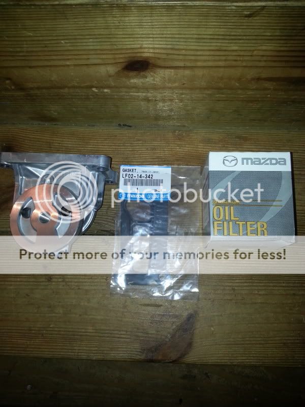

After more research I found out that the oil filter adapter for Ford 2.3L Duratec is identical for less than the cost of Mazda.
Adapter: 3S7Z-6881-AA
Gasket: 1S7Z-6840-AA

What is this 'infamous' oil filter leak, you're referring too?? The infamous leak is due to failed gasket that mates the oil cooler housing to the oil filter housing (regardless of canister or cartridge filter).
1st gen gasket, < 2010 MY
2nd gen gasket, > 2012 MY
I've never had issues with the oil filter conversion. Yes, the Ford parts are what I used.
thanks Flcrusing for the confirmation. I can also confirm that the Adapter: 3S7Z-6881-AA replaces the Mazda5 cartridge housing. I was able to replace the old original cartridge with a new spin-on housing and stop my leak. I thought the pressure sensor was leaking, so I replaced it with a new one.

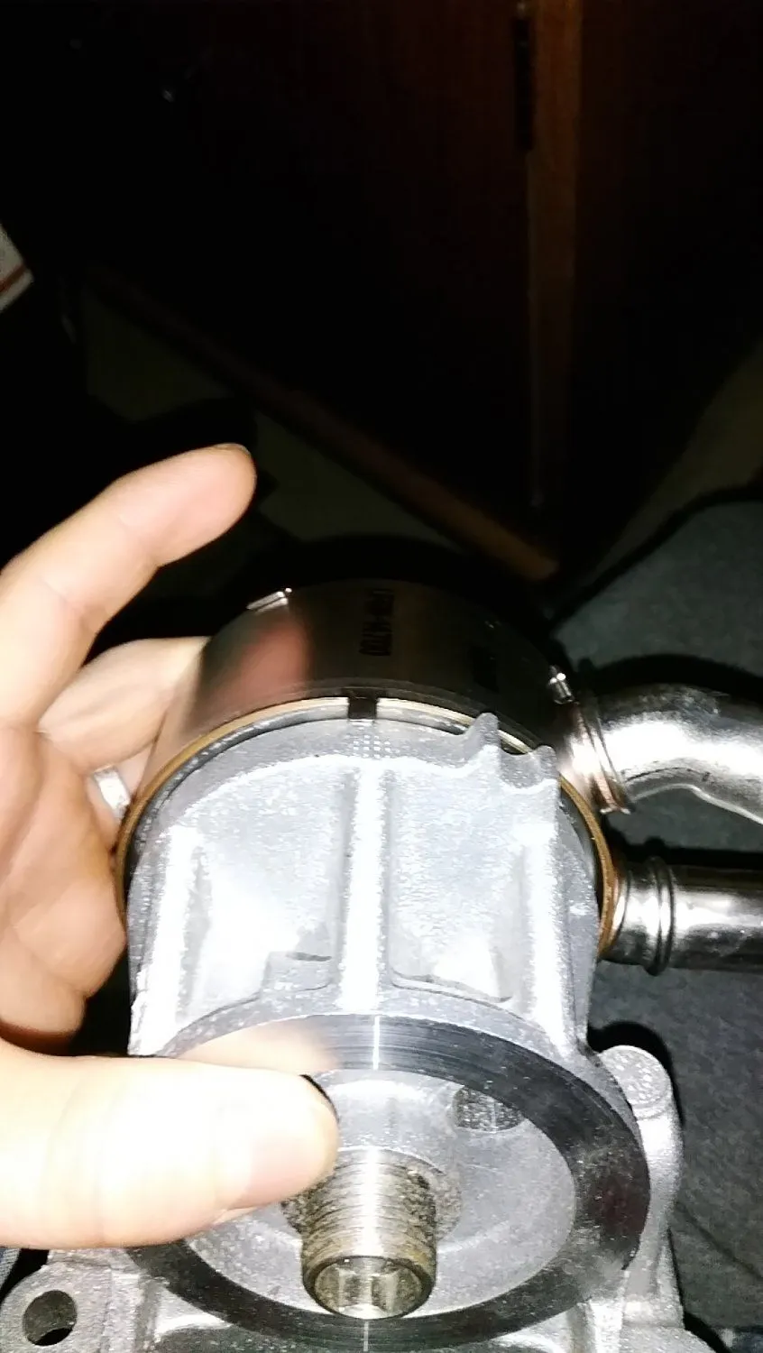

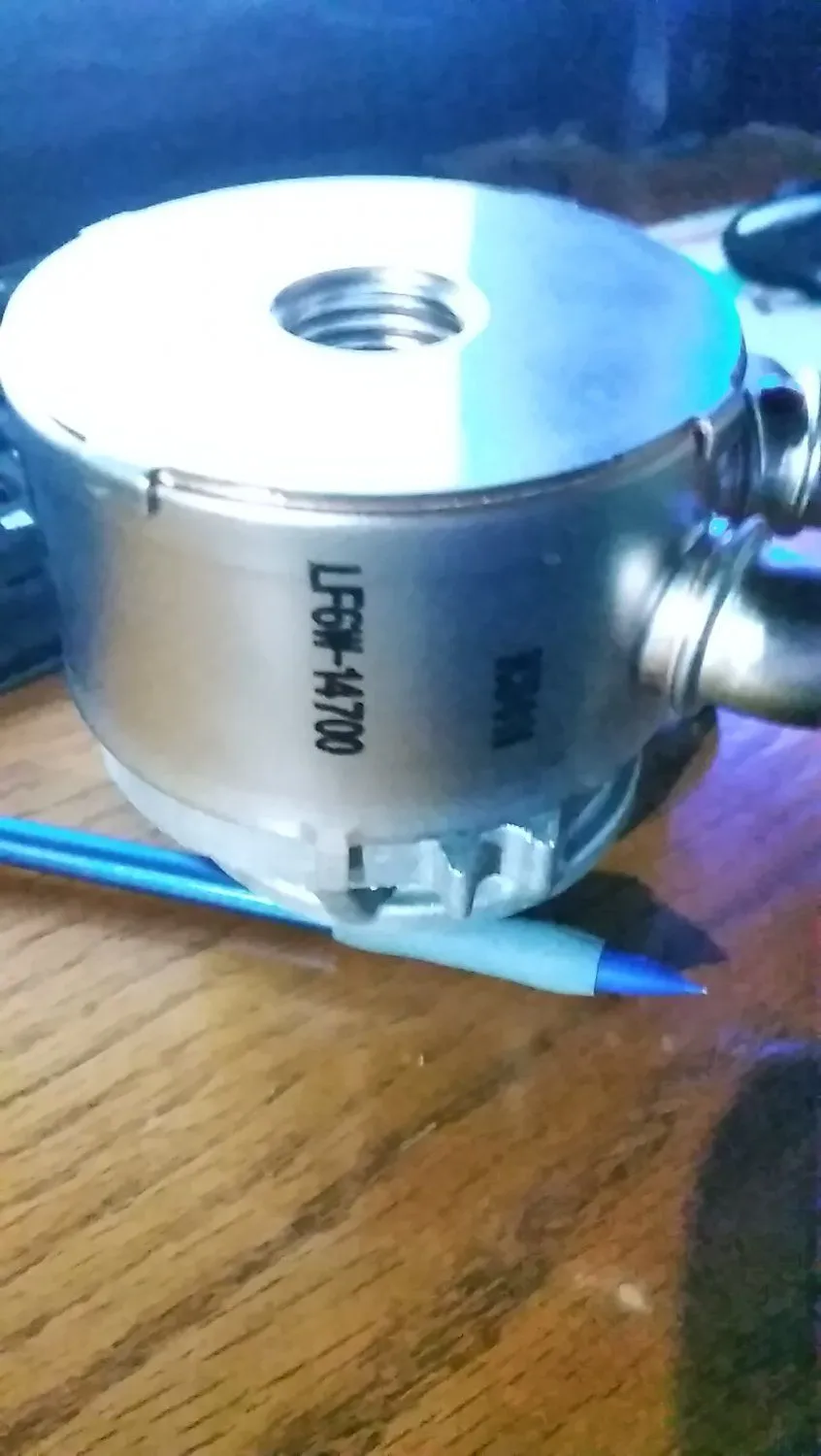

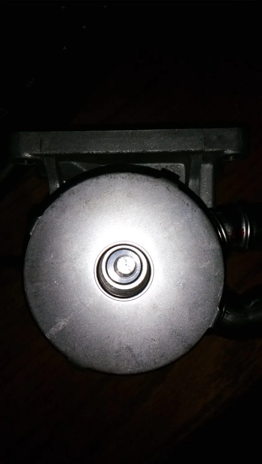

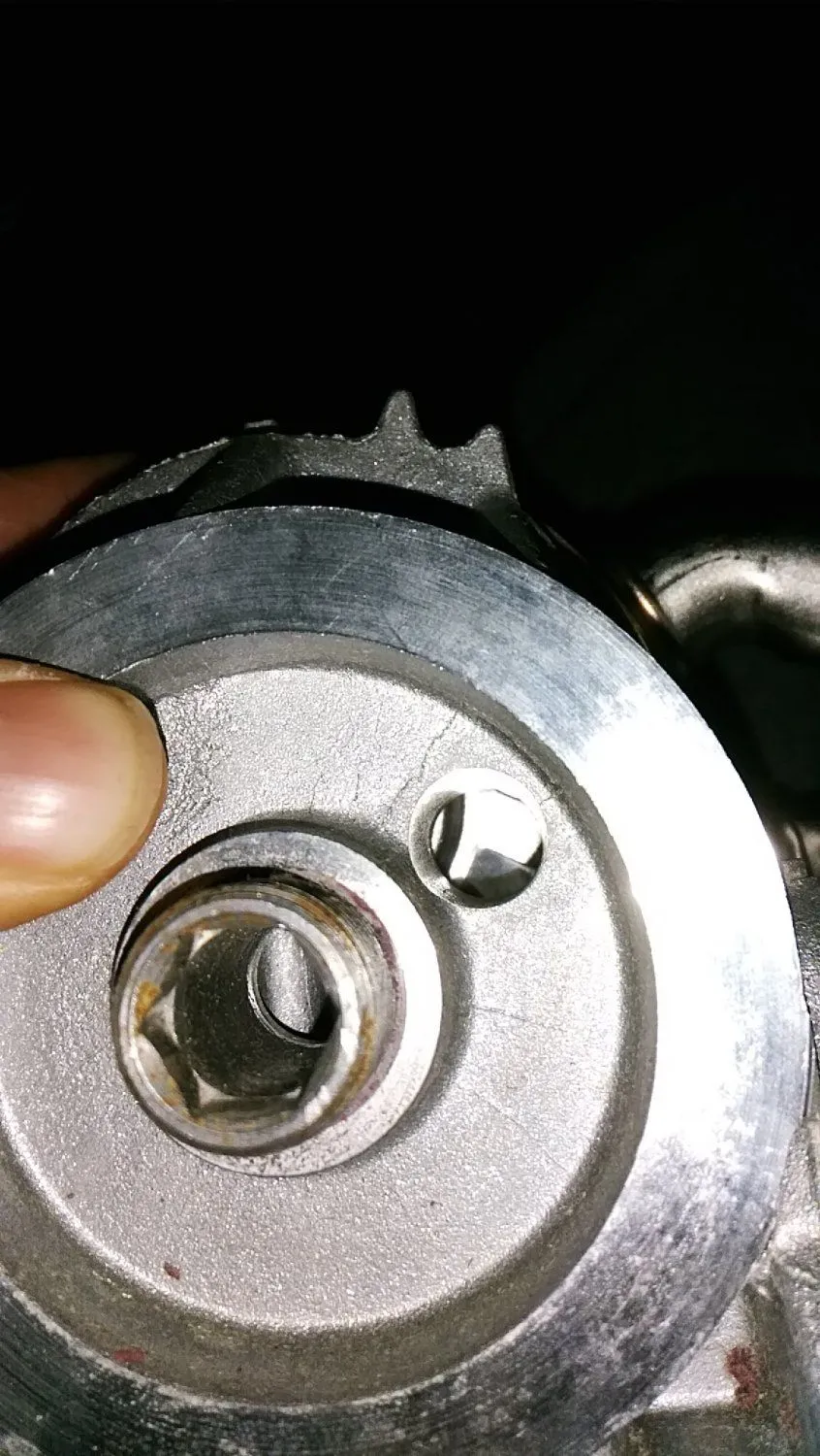

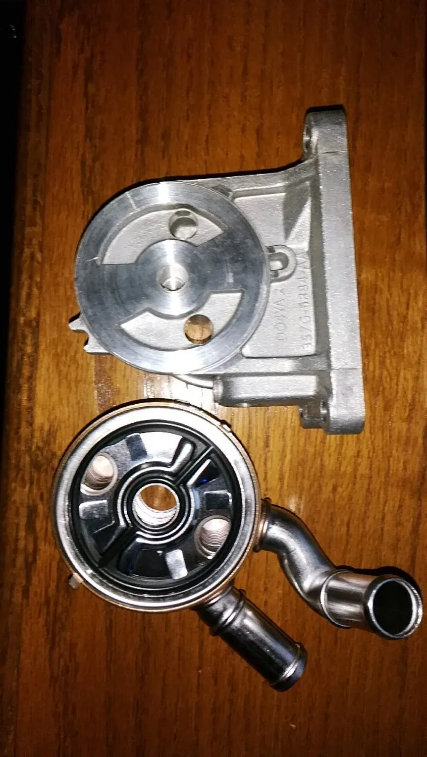

Has anyone replaced the old black cooler with the new silver one and mated that with the Ford spin-on adapter? I have both but when I put them together I'm not entirely sure it will work. One of the little tabs on the cooler doesn't fall into the space on the side of the adapter. I'm also not sure about the two holes inside the cooler and inside the adapter....are they supposed to line up? The adapter is 3S7Z-6881-AA and cooler is LF6W-14-700A. I have a 2006 Mazda 5.
