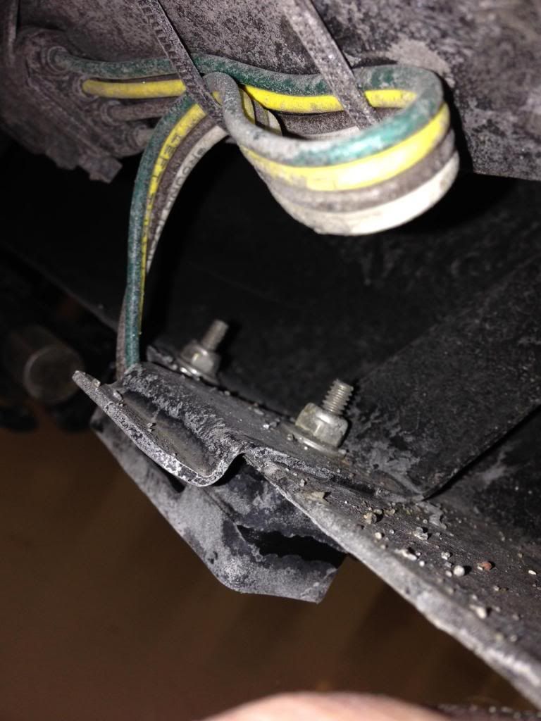

I mounted it to the car with this (there are two metal brackets on the forward side of the rear bumper that provide support, they are attached to the bumper with those black plastic rivet things. I removed one rivet thing and ran a bolt through the Hopkins mounting bracket, the bumper, and the metal support bracket. For the second hole in the mounting bracket I drilled a hole in the bumper and ran a bolt through with a large washer and a nut):

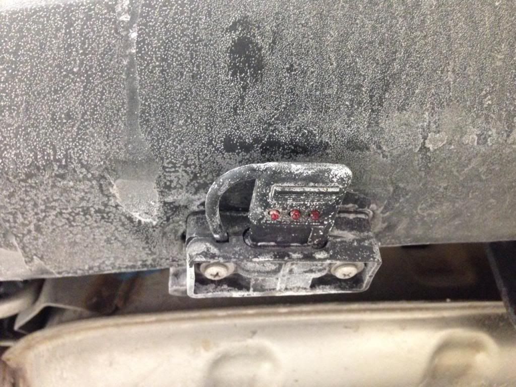

The tester I have has a lanyard on it (just like the one pictured on Amazon) that works perfectly with the Hopkins plug and Hopkins mounting bracket. Basically I plug it in as a dust plug and when not in use it just dangles out of the way.

This is the hardware holding the mounting bracket on. When it is run through the existing bumper support bracket it is very solid and secure.

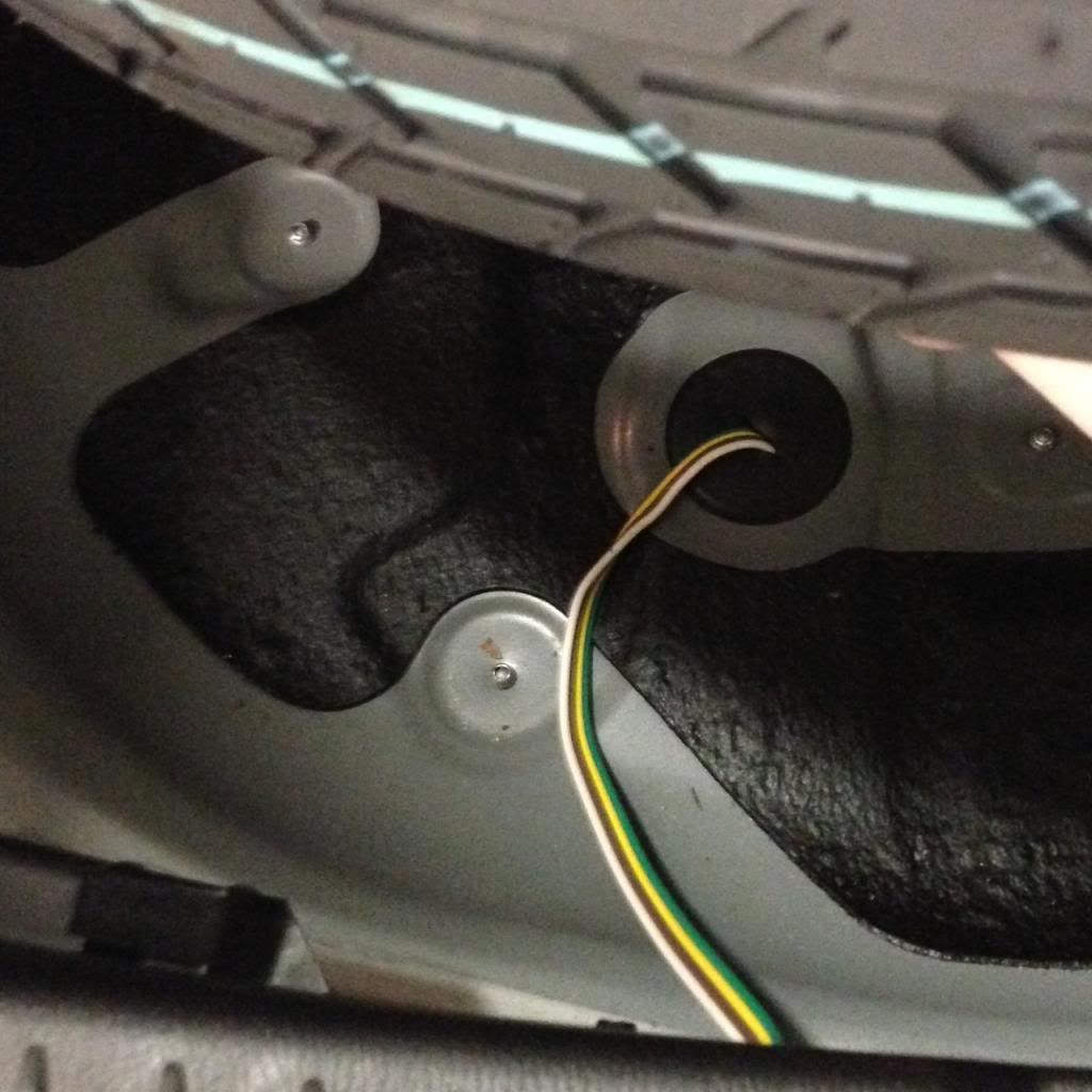

This is the pre-existing hole and grommet under the spare tire. Just remove the grommet, slit it halfway with a razor blade, run the wire through, and re-install.

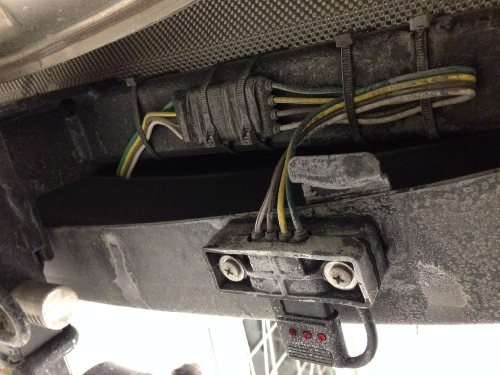

This picture shows the Hopkins extension connected and tie wrapped to the hitch.
The light tester/dust cover installed from below/behind.

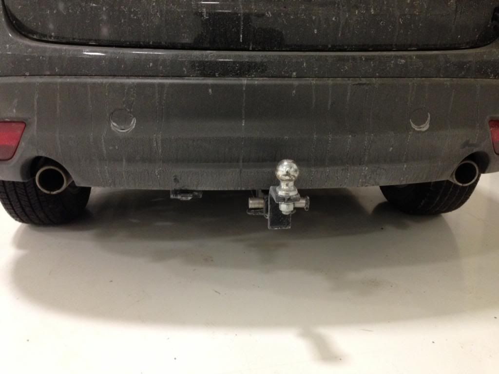

Overview.

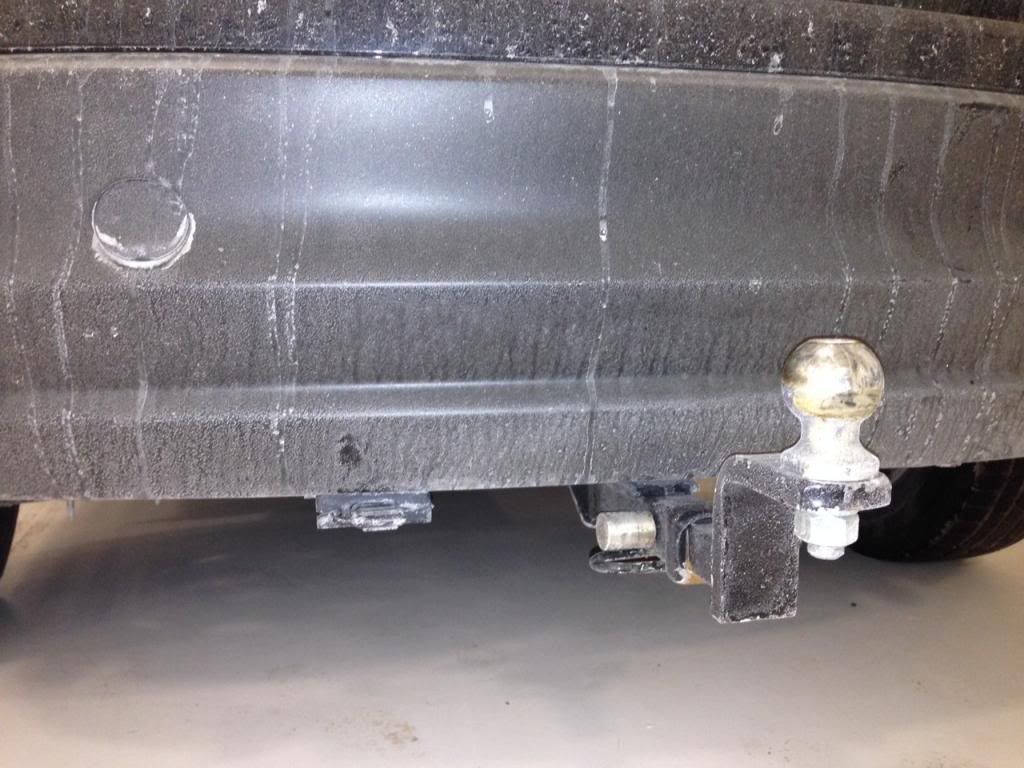

Up closer.

Anyone put some silicon or sealant on the sliced grommet under tire?
Do you mean for extra sealing? I did not, as the rubber grommet provides a good enough seal as it's squeezed into the hole, and assuming you don't make too big a hole for the wires. But, I can't see how any extra sealing can hurt. Maybe just a little messier ;)

Thanks!! Probably gonna do that project next week. I'll see how it looks before I worry about it. I imagine water intrusion from that area is highly likely unless one was fording streams. :-)
Sure no prob, if you get stuck on a section, gimme a shout! Like mentioned above, there is a heat shield right below the grommetted hole. Good luck (thumb)

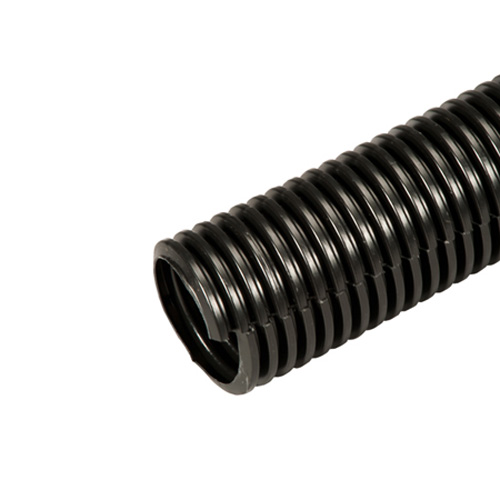

I picked up a bunch of wire loom at HF for the project. It's dirt cheap there for that stuff.
I'm always paranoid of shorts due to wire abrasion.
