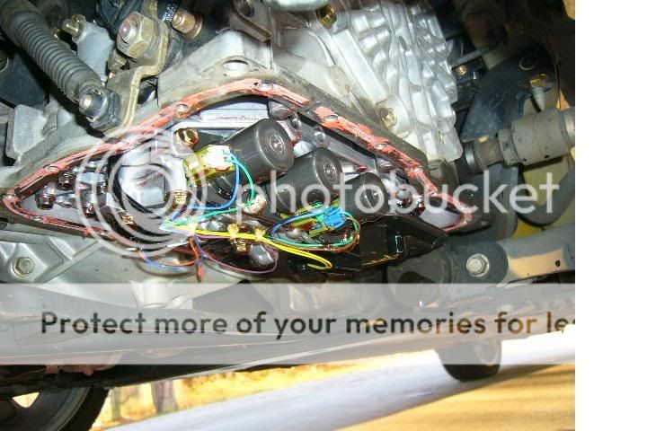

4. Once you have the oil pan off it should look like this.

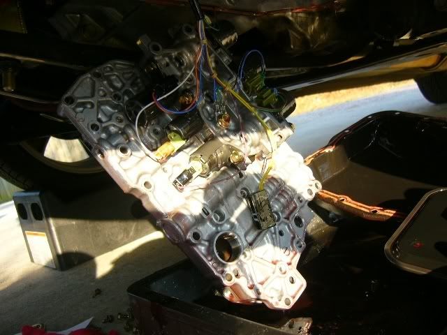

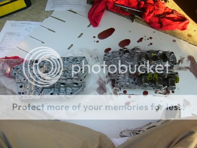

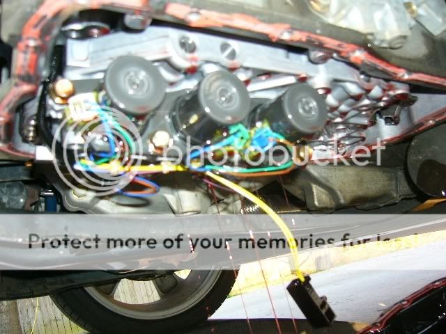

9. Now using the oil drain pan, or something about 8-9” high rest the valve body on it at an angle and start studying the valve body. Like this.

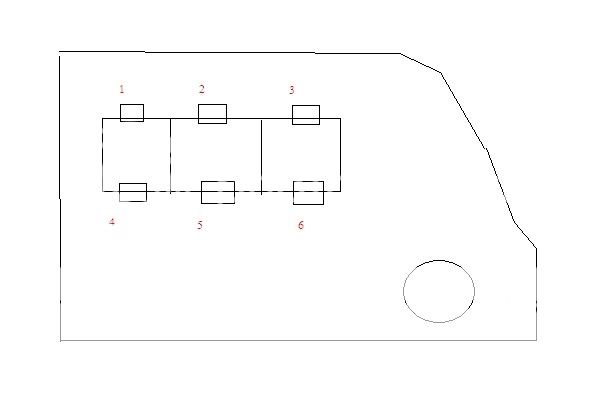

10. Take note of the colors of the plugs and wires that go to each solenoid. You can write them out yourself or you can go by this.
1.White Plug- two wires- green and blue
2.Green Plug- two wires- black and blue
3.Blue Plug- two wires- green and brown
4.Black Plug- two wires- orange and blue
5.Brown Plug- one wire- white
6.Black Plug- one wire- purple
11. Once you have this information and you are sure it is correct go ahead and unplug all the connectors. Using the 10mm socket remove the bolt that is being used to hold the ground on. Now put the valve body on a rag or piece of cardboard next to the new one. Lay it in the same position as the new one to avoid confusion.

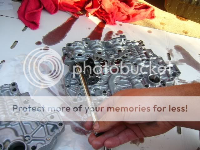

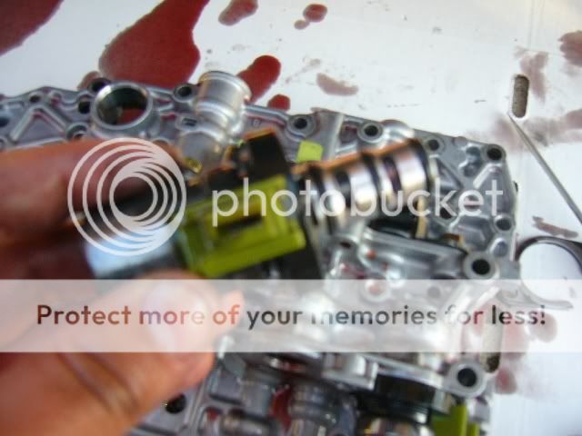

12. Now using a 10mm socket remove the bolts that are holding the metal plate down on top of the solenoids. There should be four to five bolts holding the plate on.

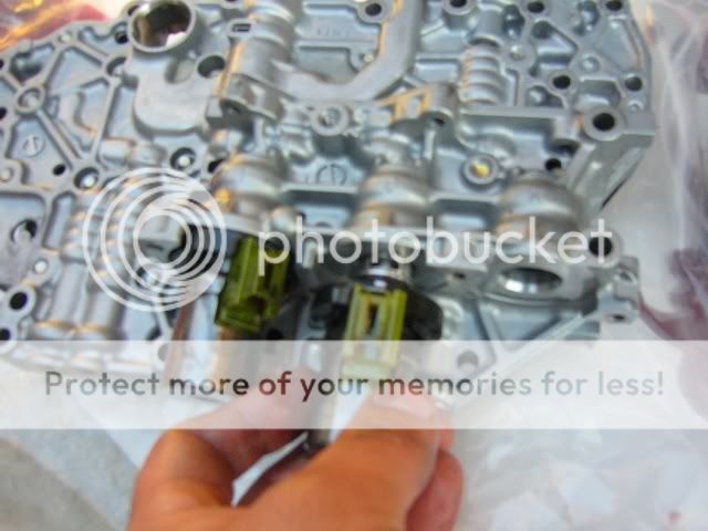

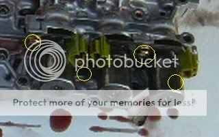

13. Once the plate is removed, insert a small flat head screwdriver in between the rubber seal on the solenoid and the actual metal on the valve body and pry it loose then once it is loose you can pull it out with your hands.

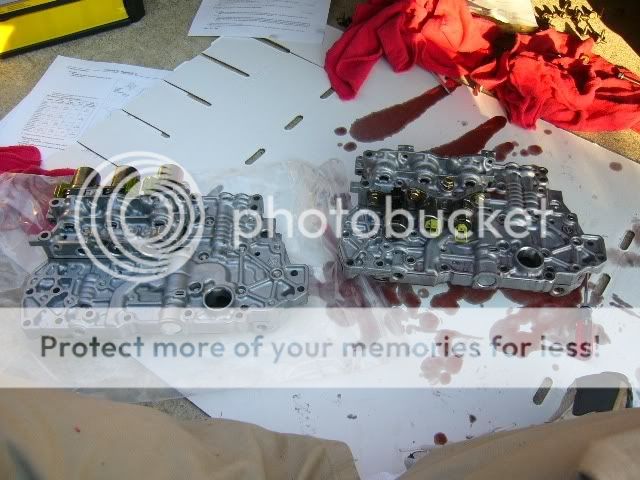

14. As you take each one out, put it in its new home in the corresponding hole on the new valve body. After you have put all of them in fit the plate back over them and turn the solenoids until the connectors are in the correct place and re install the bolts and tighten.

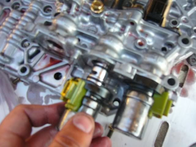

15. Now flip your valve body around to make for easier access to the remaining solenoids and to not mix them up as well.
16. Using a 10mm socket remove each bolt that holds the other solenoids on. You will notice there is no plate on this side. Just a bolt to take out and then pry each solenoid out and put it in its new home just like the others and re install the bolts and tighten.
17. Once you are done with that, you can take a break or keep going. Now, remember when I said something might have fallen out of your tranny when you took the valve body came off. If nothing fell out for you, still listen to this. Those things are called accumulators. There will be a metal thing that looks like a socket and a bigger and a smaller spring in each one. Hopefully you didn’t mix the springs up.

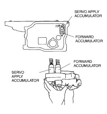

18. This is where it gets a bit tricky, but not too bad. There are two ways to do it. You can balance the accumulators on the top side of the valve body to install them or you can go ahead and stick them in and hold them until you have the valve body back on. I chose to stick them in and hold them. Here’s a pic of them.
19. One of these has a very tightly wound center spring, around 17 winds. This is the servo apply accumulator and it goes in the outer hole where these things are installed. The other one goes in the other hole. Check diagram and chart.
20. Go ahead and let the valve body rest on the prop right under your transmission again, just like in step 9. Plug all the connectors back up, like they are supposed to go.
21. Once you push the accumulators up in their home and push the valve body up onto the transmission, don’t put any bolts in yet. I didn’t get a picture of this step and I don’t have a very good diagram. You may have noticed a little metal rod with a 90 degree bend on it when you were messing with the valve body. That is the parking assist lever. Look for it towards the rear of the valve body. It is right around the yellow circle in the picture. Make sure it lines up in the metal plate that is right there at it.
22. When you have made sure that parking assist lever is in the right place and the accumulators are in the right place and the valve body seems to fit flush to the transmission, go ahead and start putting the bolts back in by hand. Put one in on each side and tighten those finger tight, so you can let go of the valve body. Finish installing all the bolts and tightening them, using the two longest bolts on top of the solenoid housing.

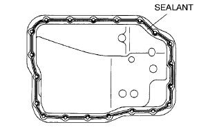

24. Scrape and clean the old silicone off of both the oil pan and the transmission. Re apply RTV Blue Silicone onto the oil pan like so.
25. Reinstall the oil pan and put all the bolts back in and tighten them. Reinsert drain plug and fill up with 5-6 quarts of tranny fluid.
