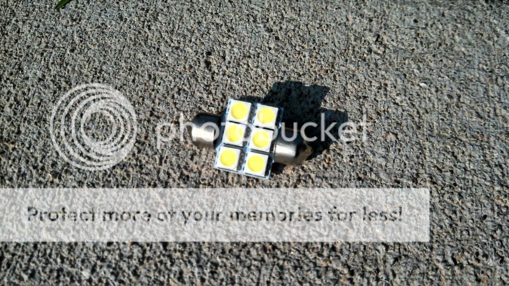

This is the style smd unit that I used for the interior dome lights.
