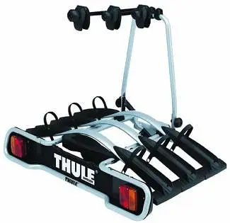

How about three bikes on the towbar and one on the roof together with a roofbox?
