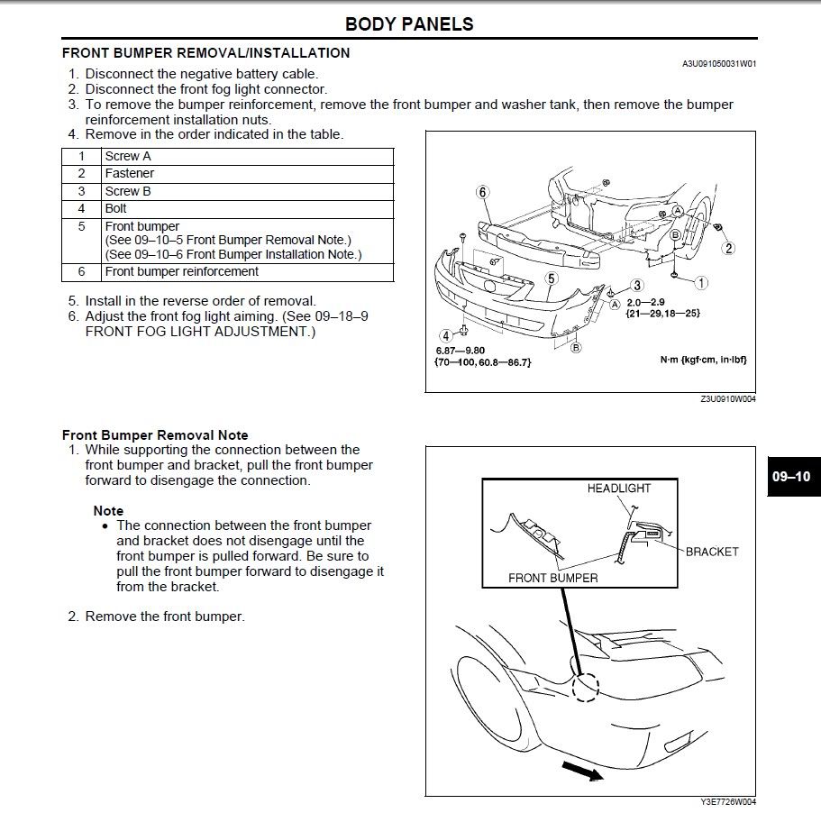

The brackets that are on the headlights where the two holes of the bumper sit on may be tricky for some folks. In another How-To, the OP broke the little tabs since he just yanked the bumper off. You have to lift up and then pull towards the front of the car. Here's the page from the Service Manual on taking off the front bumper. Maybe it can be an aid to your How-To:
