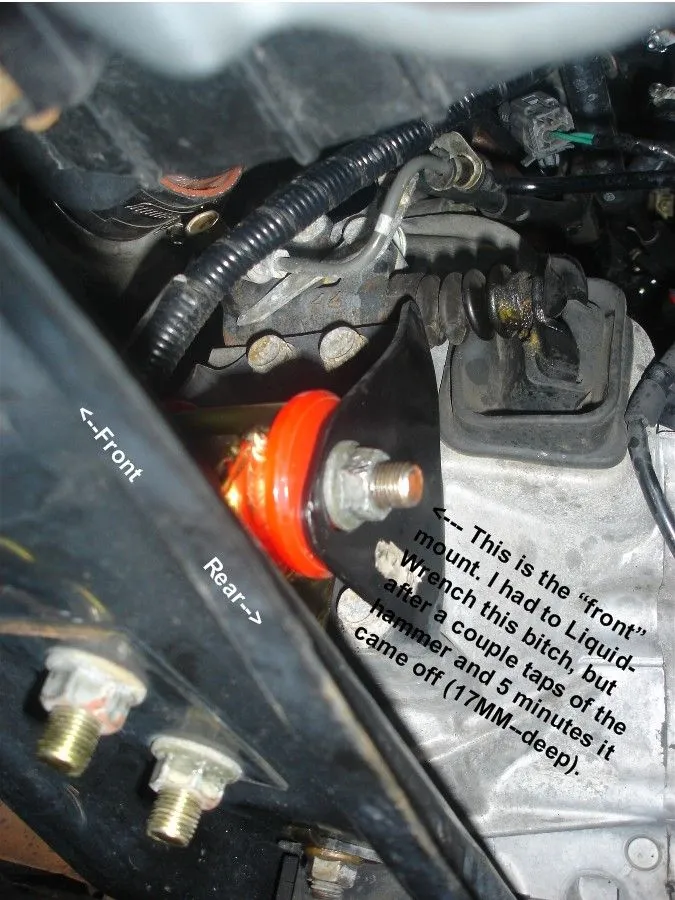

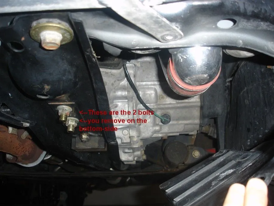

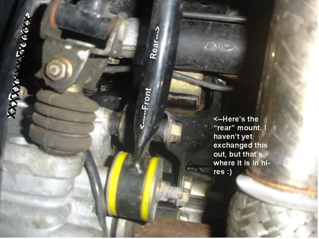

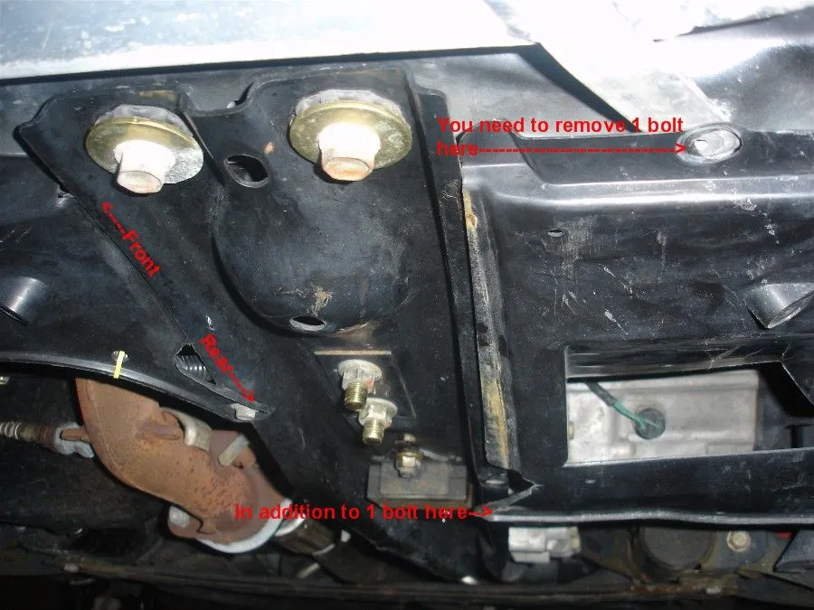

Just did the front mount this past weekend, and I rear some of you would like some better photos to help for point of referrence. I hope they help. On a side note, the car vibrates more with just the front mount changed out--like I'm driving over those cuts in the road before you come to the toll booth or something...except that's when I'm at idle. When driving I feel little more vibration through the car. If it means I don't have to replace anymore cracked midpipes, I'll be a happy camper.

i have more pic.s of install for the rear and even tools needed. i think now that youve done the front only, the rear stock will be more likely to fail. if ur good and have all the tools, u can do the rear in 2 hours. you can also come over to my house and ill help? i dont know... BUT, get the right tools and do the rear also. wat durometer did u install? not the 95 i hope...
