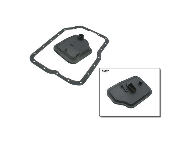

has anyone changed out their filter? how about any pics? I'm going to be doing this. I guess I could take pics of the procedure... :)
Just shopping on the web, and came across this filter kit.
http://www.autobarn.net/worldpac.html

For anyone changing the filter, advance auto parts has the kit pictured above for 20 bucks and they usually have it in stock right there. Autozone or any other of those stores should have it too.
