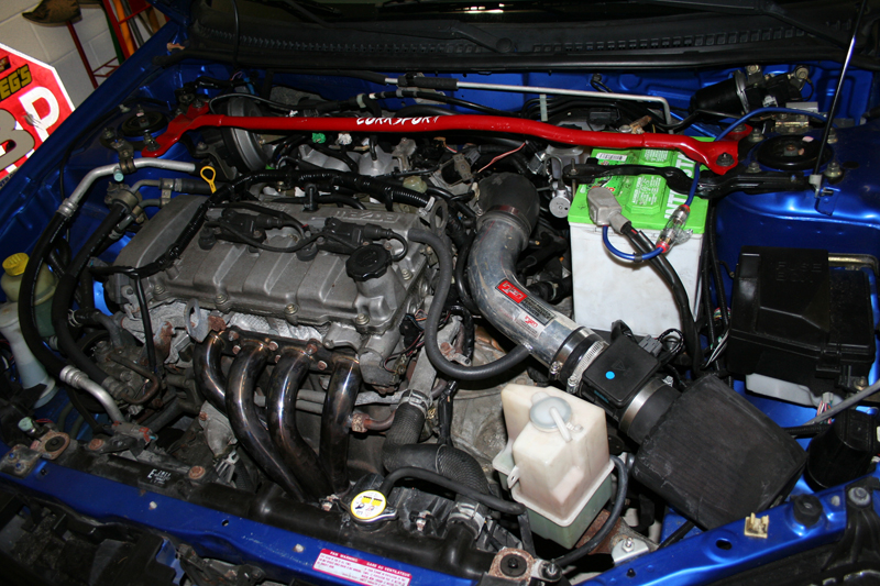

Went from stock to obx to stock and now to Ractive
OBX:
And now Ractive Long Tube
