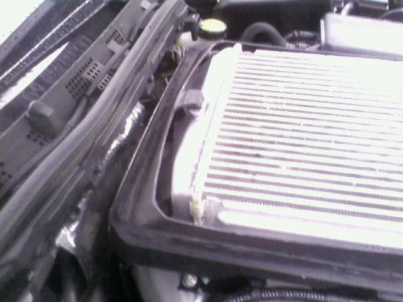

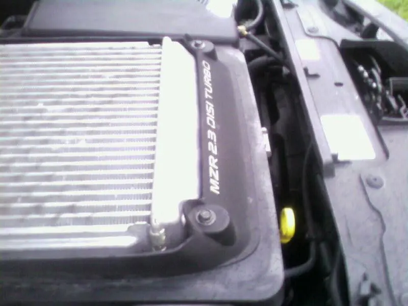

Basicly the easiest way i found is i wanted to keep the lettering in the front of the cover. you can cut it how you like but i liked the engine letters in the front so i cut around it. Take your straight edge or ruler and sharpie and for the sides you want to cut just alittle was down from the top i think i measured like 1 1/4 -1 3/4 " i believe but basicly you still want some of the side of the cover left to give the rubber seal on the hood a good seal. if you cut too low the hood will loose some effect. for the front i drew a line with my sharpie and ruler just above the letters and connected the line to the ones i already drew on the sides. NOW PAY CLOSE ATTENTION. IF you cut the rear and don't heed my warraning your cover won't fit right anymore cause there is a little plastic tab in the back that slides onto the I/C to help keep it still. You want to draw your line the same distance from the bottom of the cover as the front BUT when you get to the center where the plastic tab is you want to cleanly cut around making a hump so to say.
Now that all your lines are drawn you can start cutting. the corners are a little tricky and if you used a air saw like me the plastic can clog up and cause the saw to stall but all in all it took me from start to finish about 30-45 minutes with clean up time where you have to clean the edges so it looks good. Here's my pictures below sorry i only have a cell phone camera but they should give you a idea of what it's suppose to look like.

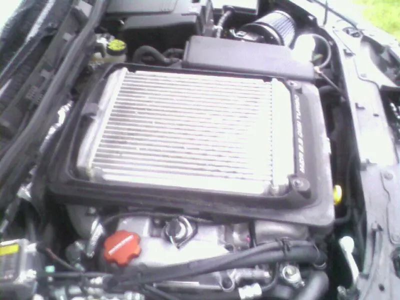

You may not or probally won't notice a BIG difference but it's on 10-15 HP not 30. But this is dyno proven before and now i'm clearing things up and telling you they're right. The factory cover like everything else on the car is super restrictive and block air from gettting to the whole intercooler and because of the style of the stock I/C you need as much air there as possible. I noticed a big difference in heat soaking. Where before after alittle harsh driving the cold side of my i/c would be hot as balls. Now afterwards not the case anymore. I drove it hard at 80MPH on the highway for about 30 minutes then 15-20 around my house on the streets ( NO i wasn't doing 80MPH anymore once i got off the highway ) so all in all about 45-50 minutes of some good WOT driving and when i pope my hood my cool side of my i/c was nice and cool like it's suppose to be not hot anymore so your engine will thank you. here's some pics of how mine looks

here's a close up of the rear. notice how i left the little notch for the bracket in rear

Hey man that actually looks pretty good! BTW if you make the pics jpgs they will be a lot smaller and a lot easier for people to see. I converted them all to jpegs for ya.

Looks like you did a nice job. It is easy to astray when cutting plastic. Maybe you didn't need to remove so much from the front and rear, who knows. Wonder what the effect would be if you created a seal between the shroud and the ic to make all air flow through the fins, not around the sides (or is it already like this?)
