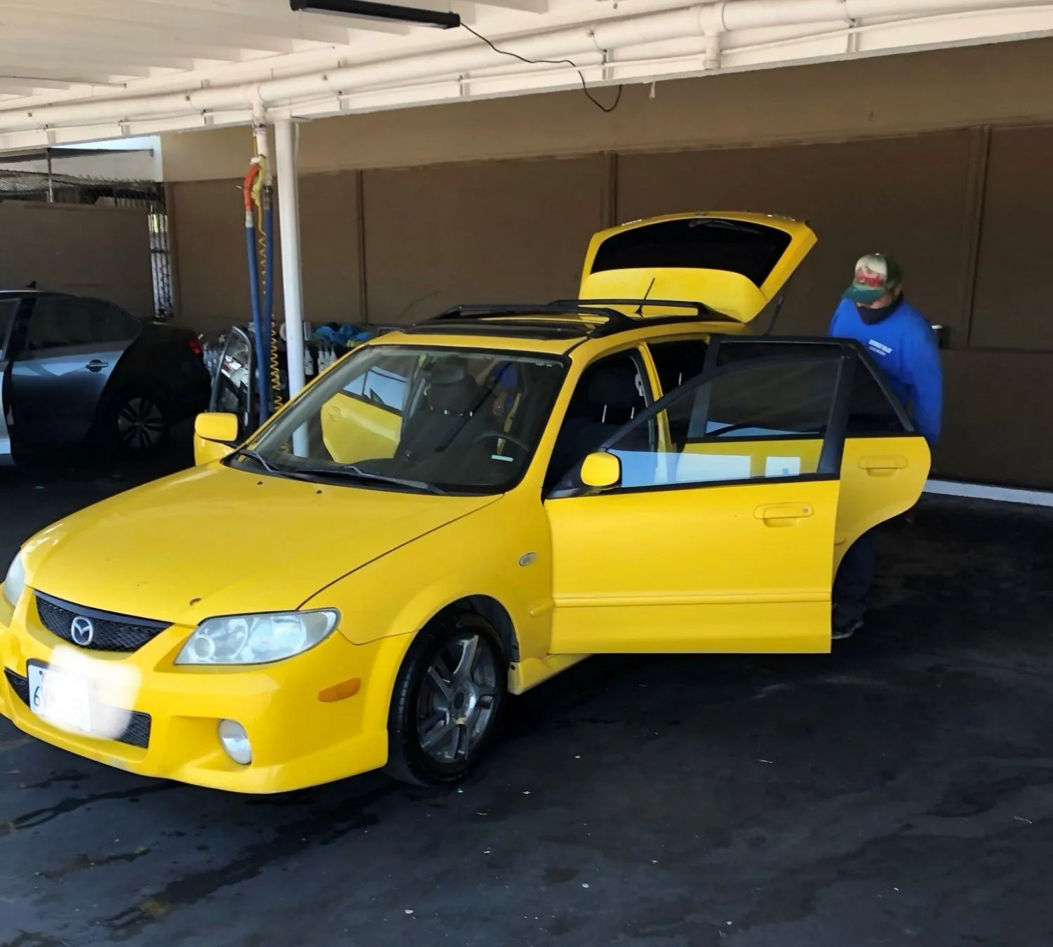

240,000 miles and still runs great. Yes, they do burn oil at that mileage, but it's been a loyal soldier. It may be available for anyone interested.
