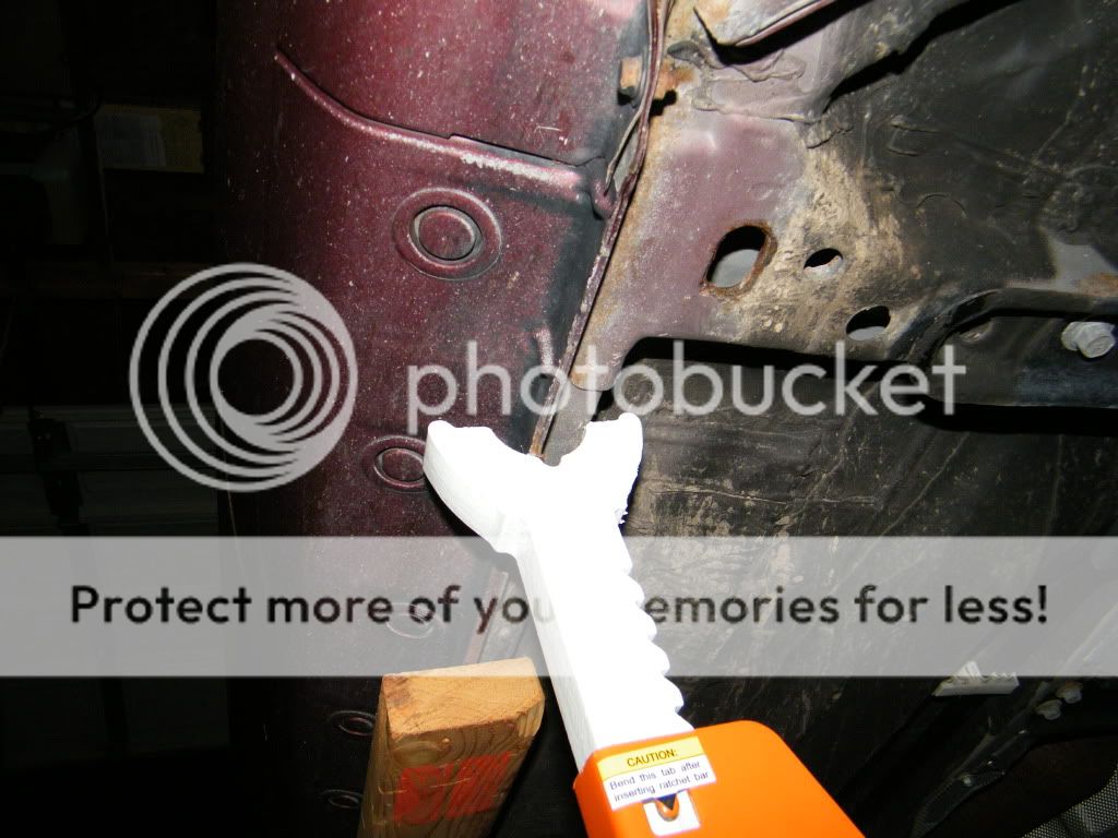

There is a "pinch weld" seam that runs along the side of the car at the bottom(might be harder to see if you have the side-skirts). This is the structural point for jacking up the car. READ YOUR OWNER'S MANUAL and you'll see that this pinch seam at the front and back are the factory jacking points... this is where a 2 post lift would be used, or your spare jack in an emergency.

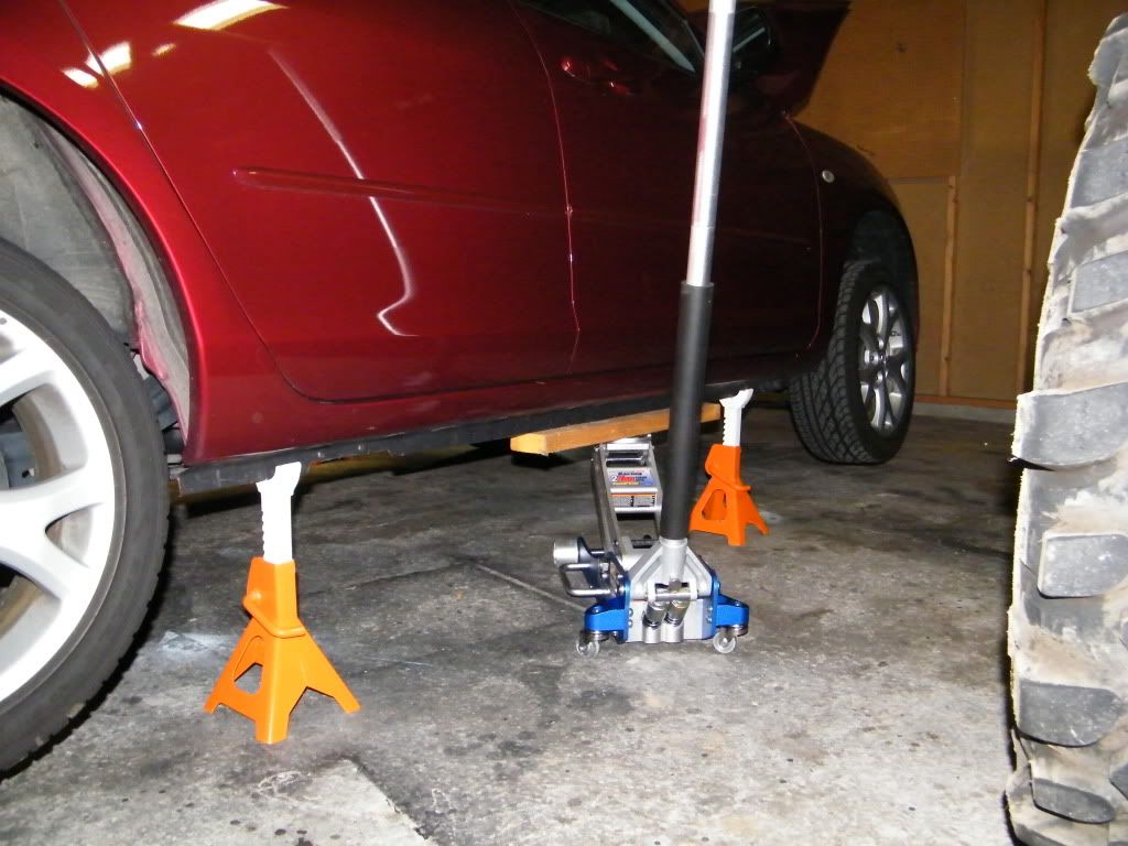

I put a 2x4 on the pad of the jack(MY jack has a large pad that can fully support the block of wood... I would NOT recommend one of the little trolley-jacks with a 2.5" wide pad) and raise it up a bit forward of the middle(because of the car's weight distribution). About 3-4" forward of the exterior door handle is about right. You'll know if it's off if it feels super unstable or starts to lean forward/backwards slightly.
The wood makes the jack spread it's force across a longer surface area so it will not damage or bend the pinch weld. Without it you'll probably put small indents into the pinch weld or bend it.
Notice that the minute I got the car high enough, I slide the jackstands under the car. NEVER trust a hydraulic jack to hold 3000lbs over your head.

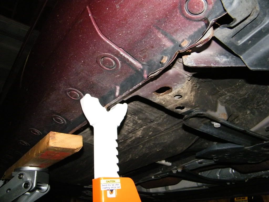

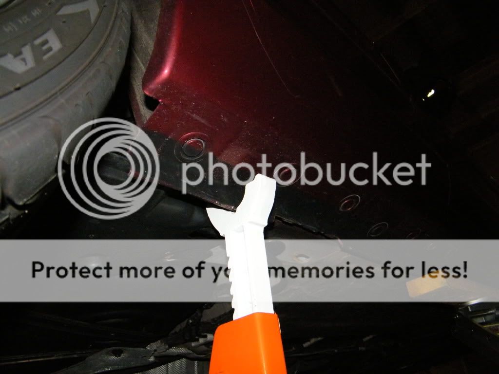

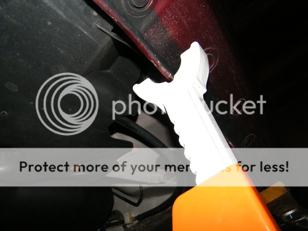

Because of the shape of my jack stands(and most others), and the way the sheet metal is on the MZ3, you'll want to put them slightly off from where the normal emergency jacking points are. Peek under and you'll see why. You want the pinch weld to rest in the groove of the jack stands.
This is the front of the car... notice I am avoiding stabbing a hole through the lower "structural" shaped stamped sheet metal with the jack stand:
And this is the rear... notice it is forward of the plastic piece so it doesn't get broken:
Couple more front and rear from different angles:

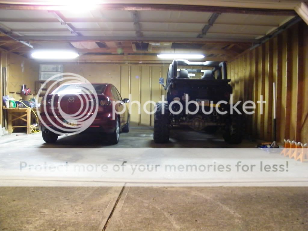

And for the hell of it, this is the Jeep that I tested the jack out on overnight.
