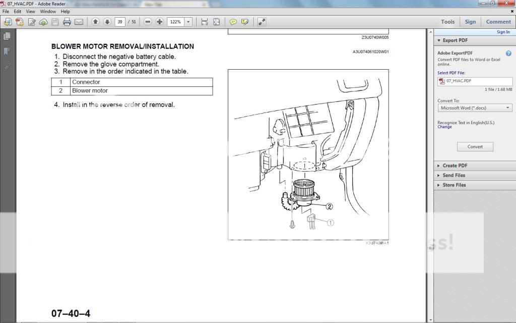

pull out the glove box, unscrew a couple screws and the blower motor comes right out the bottom of the whole assembly. if you get under you'll see everything with a flashlight, it'll take max 5 minutes to take out.
Good to know.. I think just about everyone is about due for a blower motor cleaning if they haven't already.
to add to my instructions, here is the page from the service manual

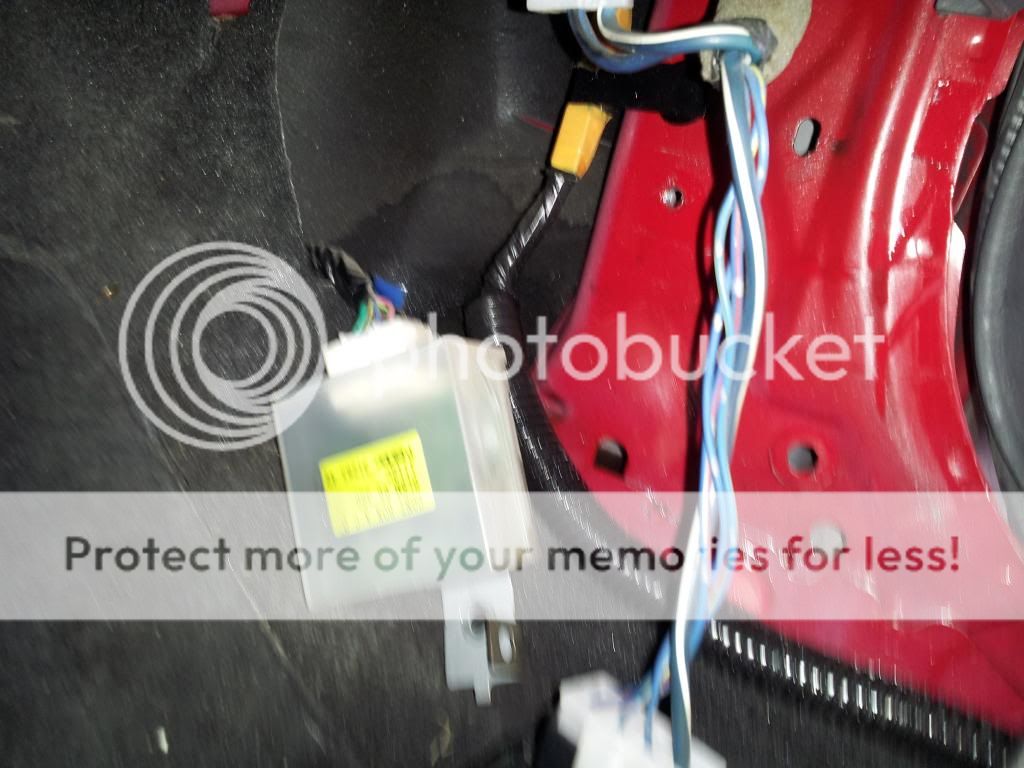

Funny you asked about this. I almost took mine apart yesterday. There's a plug that's near the front I think its the amplifier. I should think you can put a vac hose in there and suck the crap out. There was a ton of junk in there that I pulled out by hand. Glass too, from when it was in an accident ..

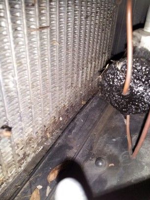

Well I managed to get my duct work cleaned out.

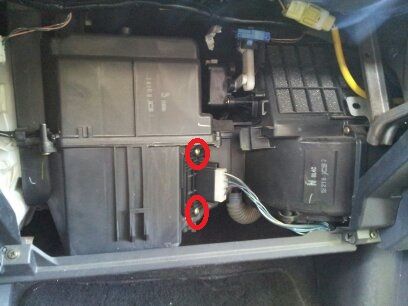

Start with removing the glove box, then remove the two screws holding the resistor pack.

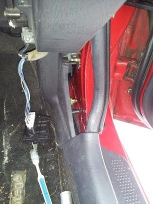

Then remove the two screws holding the box around the AC condensor together. This allows the box to open up far enough to get inside. I used a toothbrush to clean the fins. It wasn't nearly as bad in there as I expected.

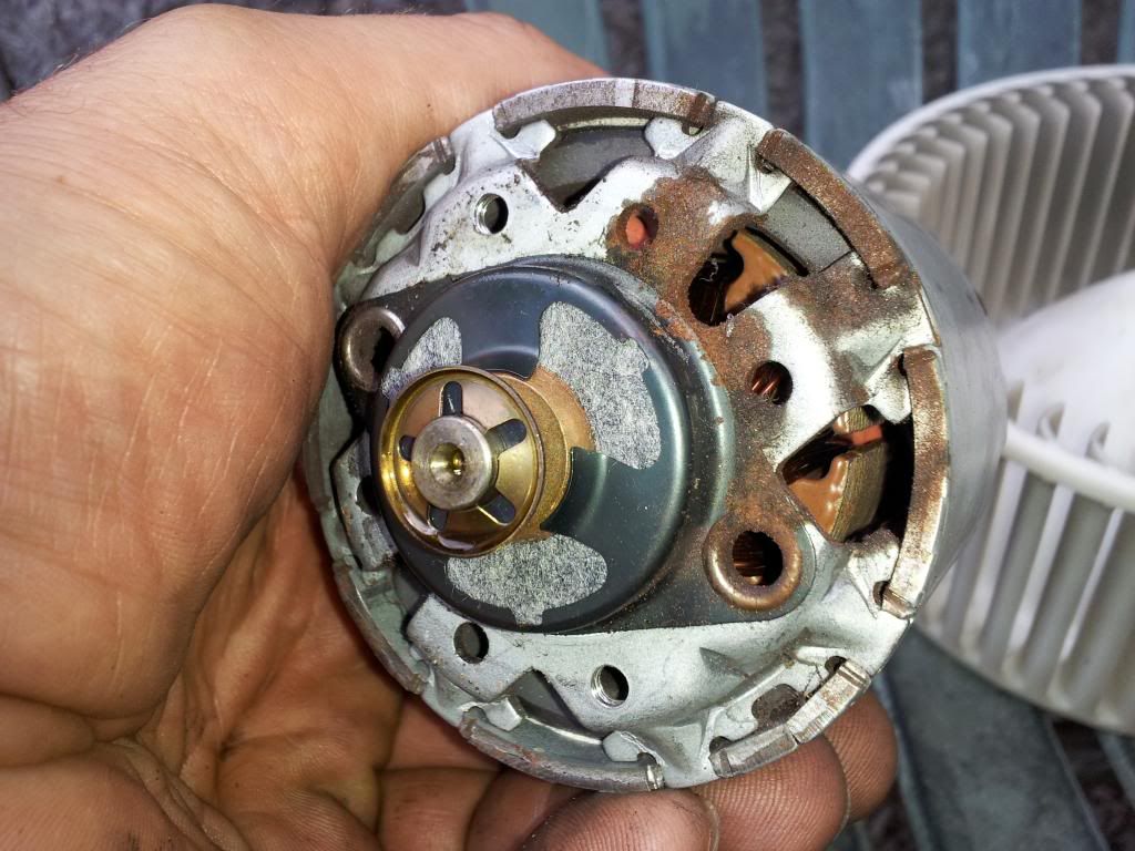

Then I removed the blower motor and it too was in really good shape. I had to remove the side trim and a relay thing to gain access to the three screws holding in the blower.

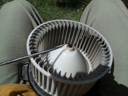

But then I decided to get all carried away and remove the squirrel cage (impeller, fan blades) to service the motor.

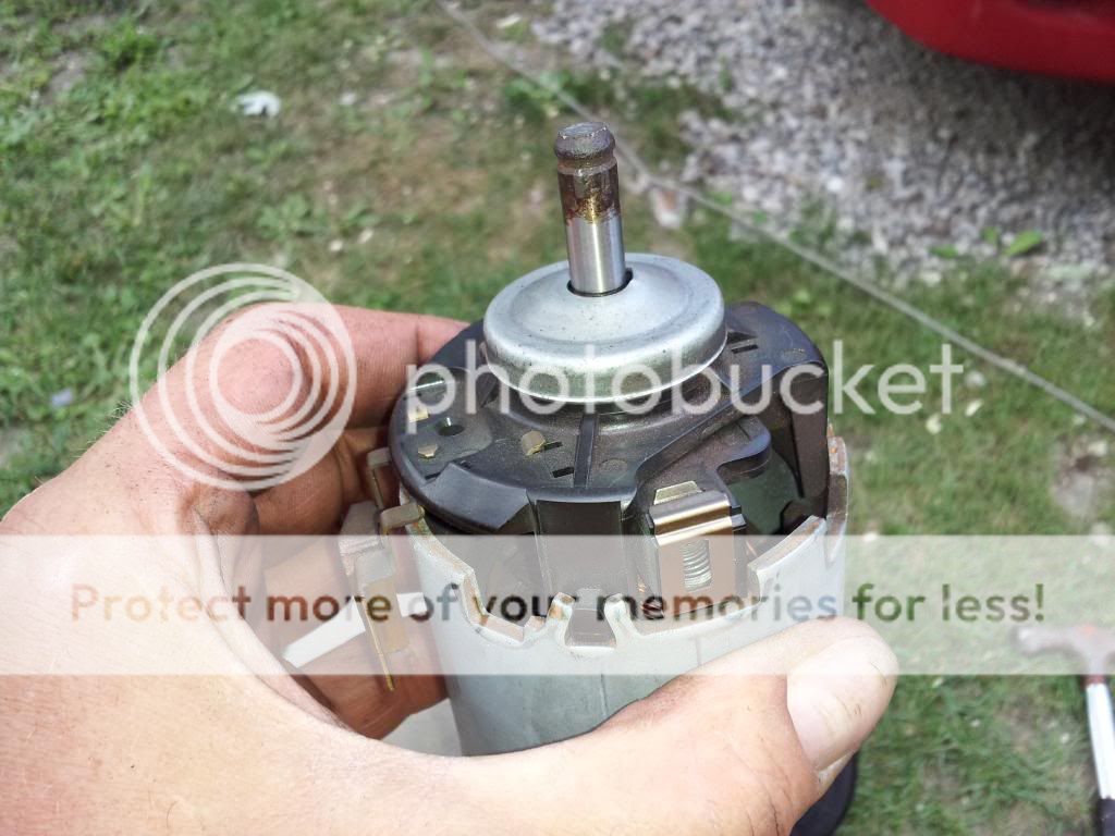

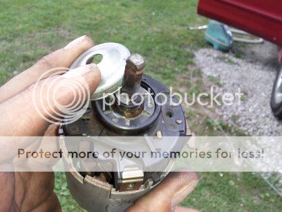

That's when things kinda went south and I almost ended up with no wind at all due to breaking the squirrel cage. The rod from the motor was all rusty and didn't want to let the squirrel cage slide off.

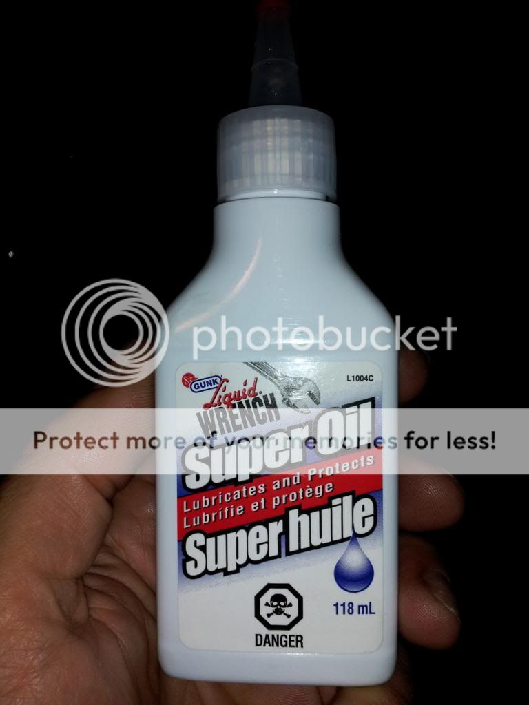

Then I removed the dust cap to expose the felt and saturated the felt with oil. I bought this oil for the motor,.. it say's it's for electric motors and sewing machines.
Then I put everything back together and it's all working.
