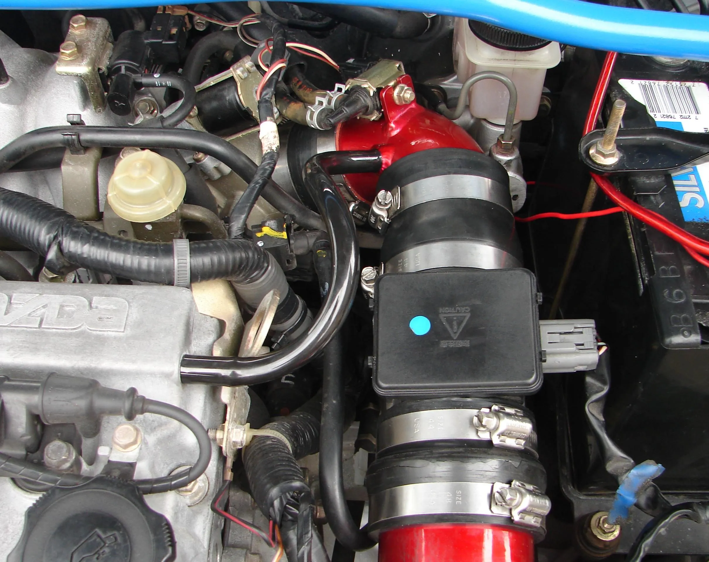

Mine is close, I got mine used and I can see the rub marks, it dont rub on mine tho?

There is an easy (and cheap) fix for this problem.
Let me take a pic of mine tomorrow and show you how it's done.
All you have to do is mess around with it until you get clearance. Push the first fitting down over the ears on the throttle body instead of letting it stop at the ears. This will give you a little extra to get past the master cylinder. Gotta leave room for the clamp tho. Then just push the first elbow of pipe all the way in an angle it away from the master cylinder as much as possible while still pointing it forward where it needs to be. It's a balncing act but is doable. Also use the bracket thing to attach to one of the original MAF screw holes then attach it to something that moves with the motor so that there is no tug-of-war between the engine movement & a static point on the chassis/body. It's good stuff, enjoy, you can do IT. Get that K&N when you can. I use an RC4650 with the prefilter cover deal on it. I pointed mine where it ends up between the fuse box & driver headlight after relocating the overflow tank. Moving that is just unscrewing the bracket & choosing a different bolt hole on the body. You don't even have to disconnect the line to radiator.

and about the rubbing... ZIP TIES work wonders. just thought i'd throw that out there.
yea i have the bomz. and it works great. no probs with the filter. contrary to what others might say its actually pretty good. and yea i have mine ziptied to the engine crane hook thingy and to my radiator hose so it wont rub on the brake master cylinder. i can take pics tomorrow
