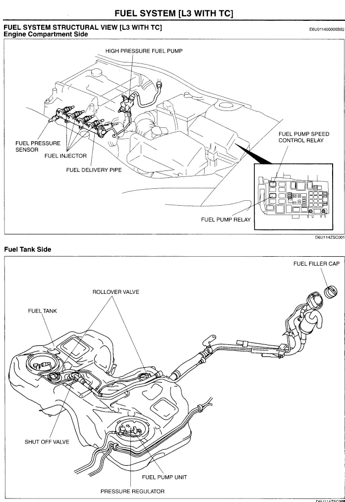

There is an electric intank pump that pressurizes the fuel to ~62 psi and sends it forward. The second (high pressure) fuel pump is driven off the intake camshaft it boosts the fuel pressure to between 435.2 and 1667 psi.
