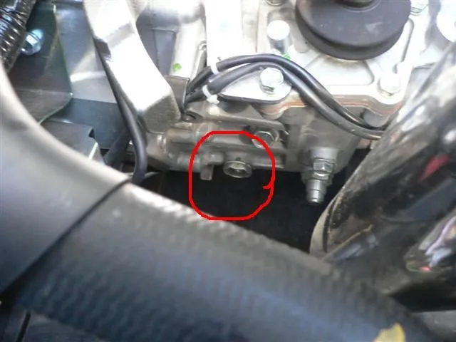

It sounds like my differential has been clunking a lot lately. I'm planning on taking her into the dealer next week, but I'm changing my oil now and would like to check the transmission fluid level. I looked through the manual and didn't find the answer, so any help will be much appreciated.

You have to remove the fill hole plug and stick a finger (or something) in the hole. With the car level, the oil should be within 1/2" of the hole.
The plug is on the front of the transmission. I tried to show where it is in the attached picture, taken from above.

isnt it the top plug? i would imagine the tranny fluid would come out of that hole if u took that screw out
Nope. The drain plug is on the side near the back. That's the one. If you are under the car you can see it is not at the bottom.
Thanks for the info Rotus. I had looked at that bolt so I knew right away from your picture. I stuck my finger in there and found fluid. It's hard to tell but it might have been more than a 1/2" down.

The drain plug looks identical to the fill plug. It is at back of the driver's side of the tranny. It is best to drain with the front wheels high, ramps are fine. I am a fan of RedLine MT-90.
To fill, the car should be level. You will need either a pump or a funnel with a long flexible or right angle spout so you can fill from above. Fill until is starts to spill out the fill hole, then put the plug in quick. It should take between 2.5 and 3 quarts.
