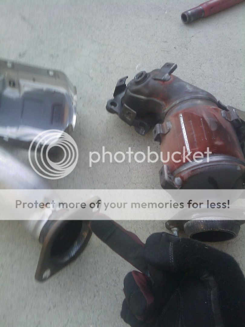

did anyone post a DIY/How To on any of the forums? about to tackle this myself. hopefully jackstands + ghetto tools will be sufficient, haha. i knew this kid that had a bmw and paid $500 just for INSTALLATION of his downpipes. **** that. imma ghetto rig my s*** and use the $500 on hoes.

I could post a how to, i didnt take any pictures but i could easily describe the steps i took to getting it out.
after i got the mani off, the rest took an hour and a half for re-assembly.
Someone make changes or additions as they see fit.
NEEDED: 14mm box end style ratchet wrench
14mm off set close ended wrench
22mm o2 sensor socket
lots of other misc sockets/extensions
a strap of some sort is necessary for removal of the bolts of the manifold.
THEY ARE NOT MAGNETIC SO DO NOT DROP THEM! lol
1.) Take off the hood.
2.) Take out your battery and the turbo inlet/intake setup.
3.) Jack up the car, remove the bottom oxygen sensor
4.) Remove the rear/second cat
5.) Remove the middle pipes, best description evar!!!!
6.) Crawl foreward and look for the plate holding the top cat in place, remove the two bolts.
7.) lower the car and take off all the heat shields you can see.
8.) take off the 4 bolts holding on the turbo, there is a bracket holding up that pos k04, and its like 12 lbs anyhow lol.
9.) Take off all the nuts holding on the mnifold, i think there was 11.
10.) Remove the oil line thats attatched to the manifold.
11.) pull out the manifold.
12.) undo the 5 bolts holding on the down pipe.
13.) remove, reinstall and reverse steps.
hope i got all the steps, i just has no pics!
