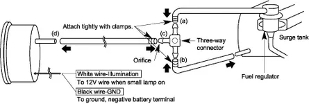

Maybe, its the place where we connect for boost source(unlikely). Defi's instruction say to cut the line between the surge tank fuel reg. Dose anyone have their gauges conected that way.
sabishii said:
Mine's hooked up according to the post in the How-To forum (http://www.msprotege.com/forum/showthread.php?t=50210&highlight=boost).
What are the vacuum hoses going to in my picture, by the way?
Mine is hooked up the same way. Are there boost gauges better that others. Im not looking at looks, since defi gauges look so sexy, but functionalty. When I turn my car off, and its been sitting over night the next day my boost gauge reads between 0-1psi, closer to 1. But over the summer it never did that. But when the car is on, it still reads the same boost as before.
