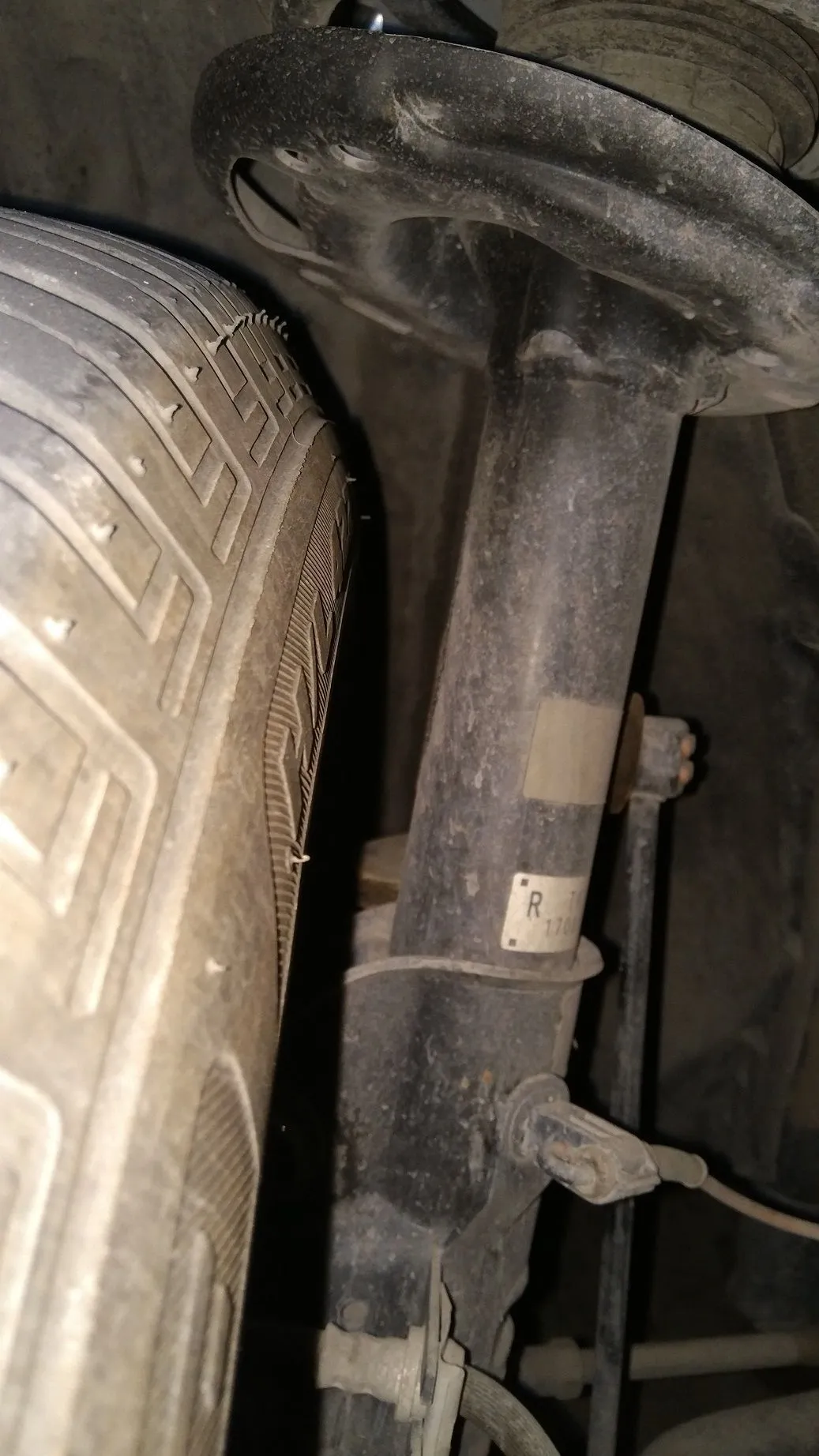

A 20 mm increase in width (10mm on both sides) will clear just fine based on this photo I took when I was shopping for summer wheels. I didn't measure the exact distance, but there looks to be approximately 1" of clearance with the OEM Ecopias.

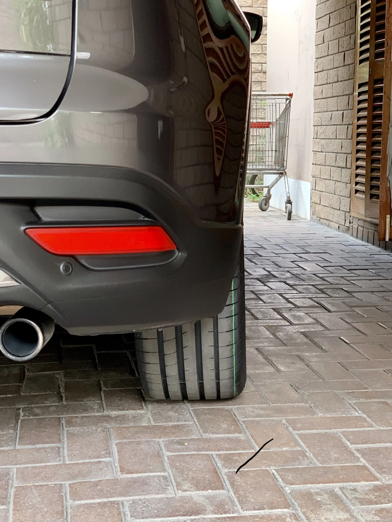

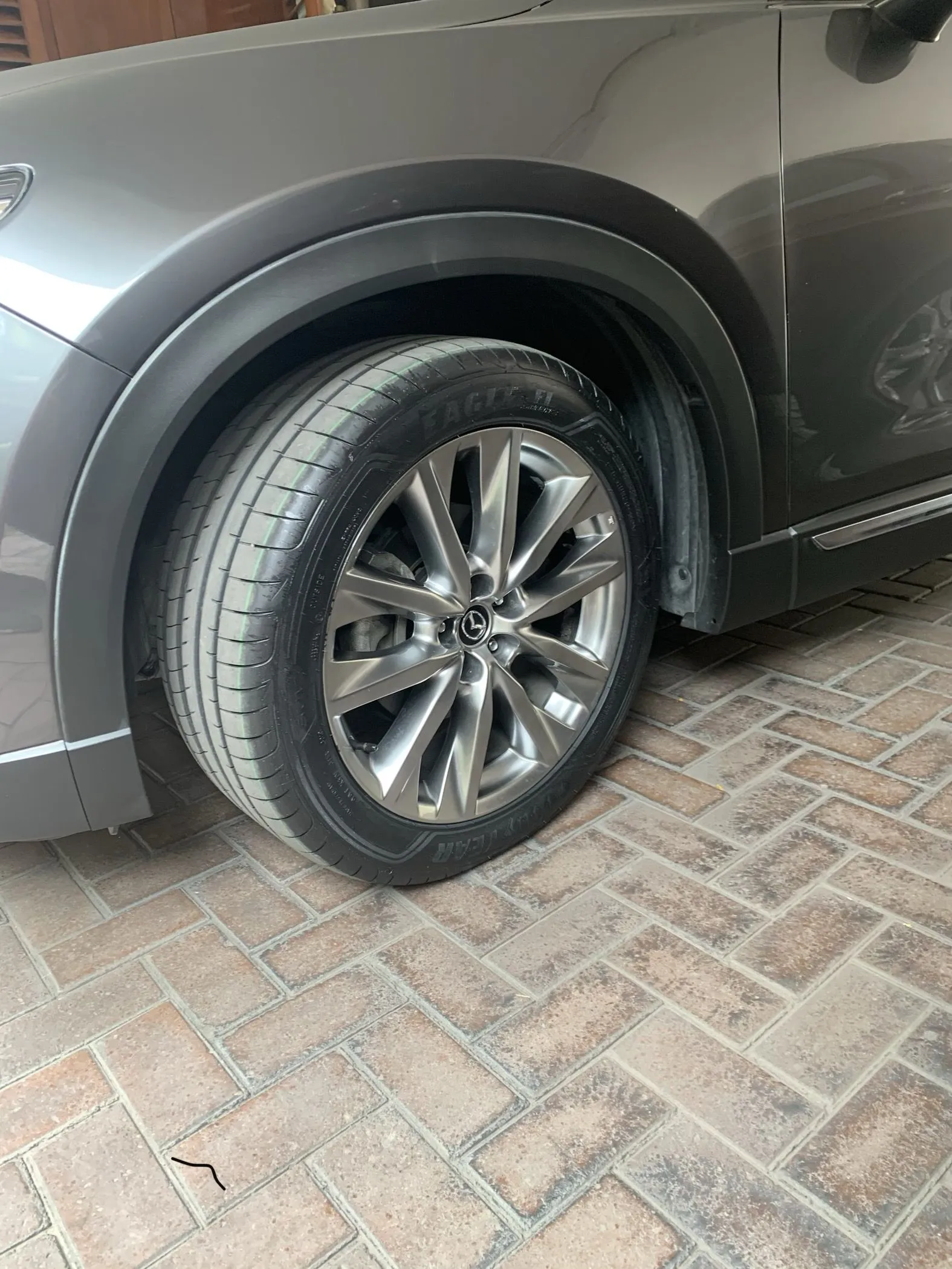

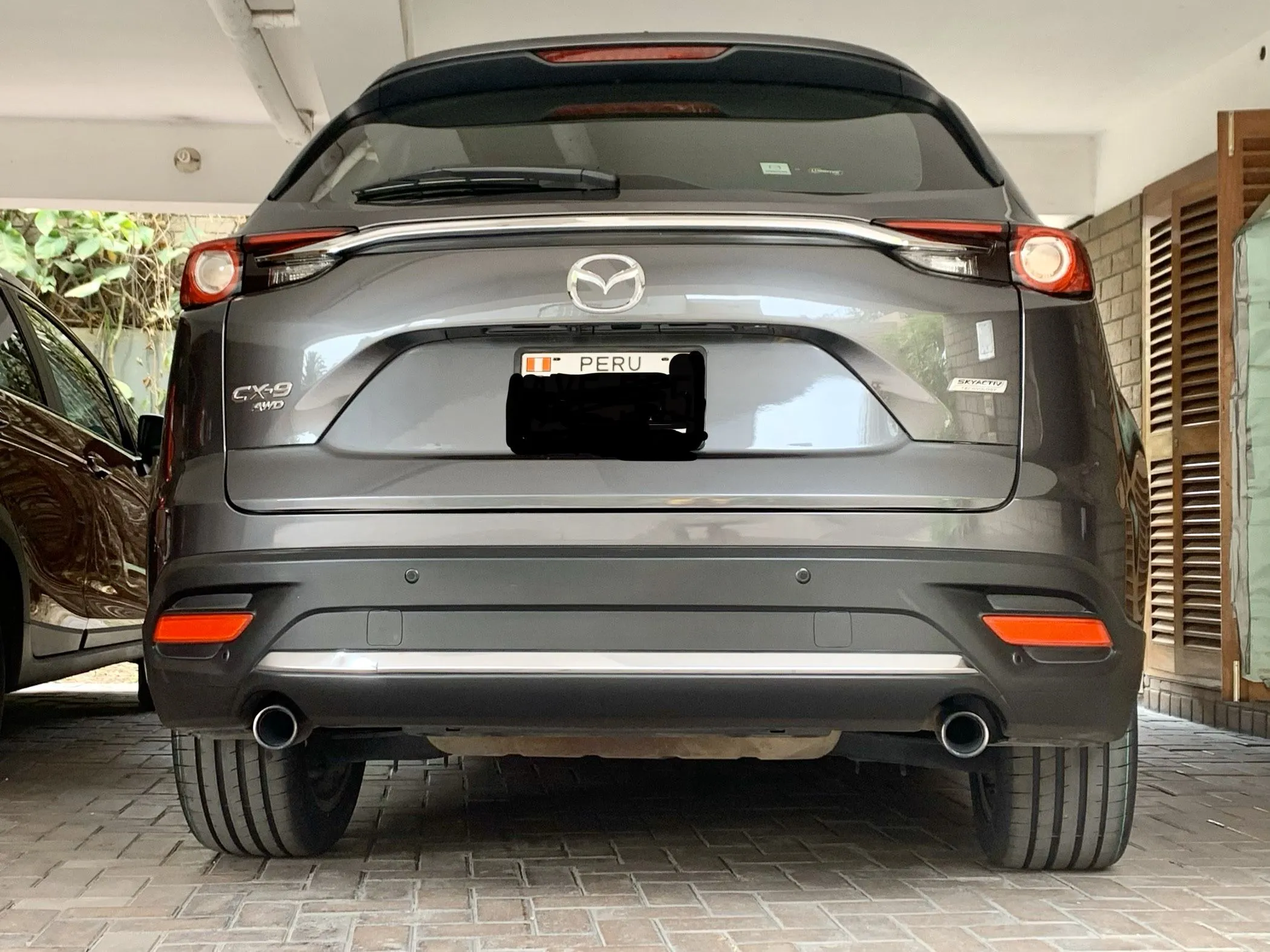

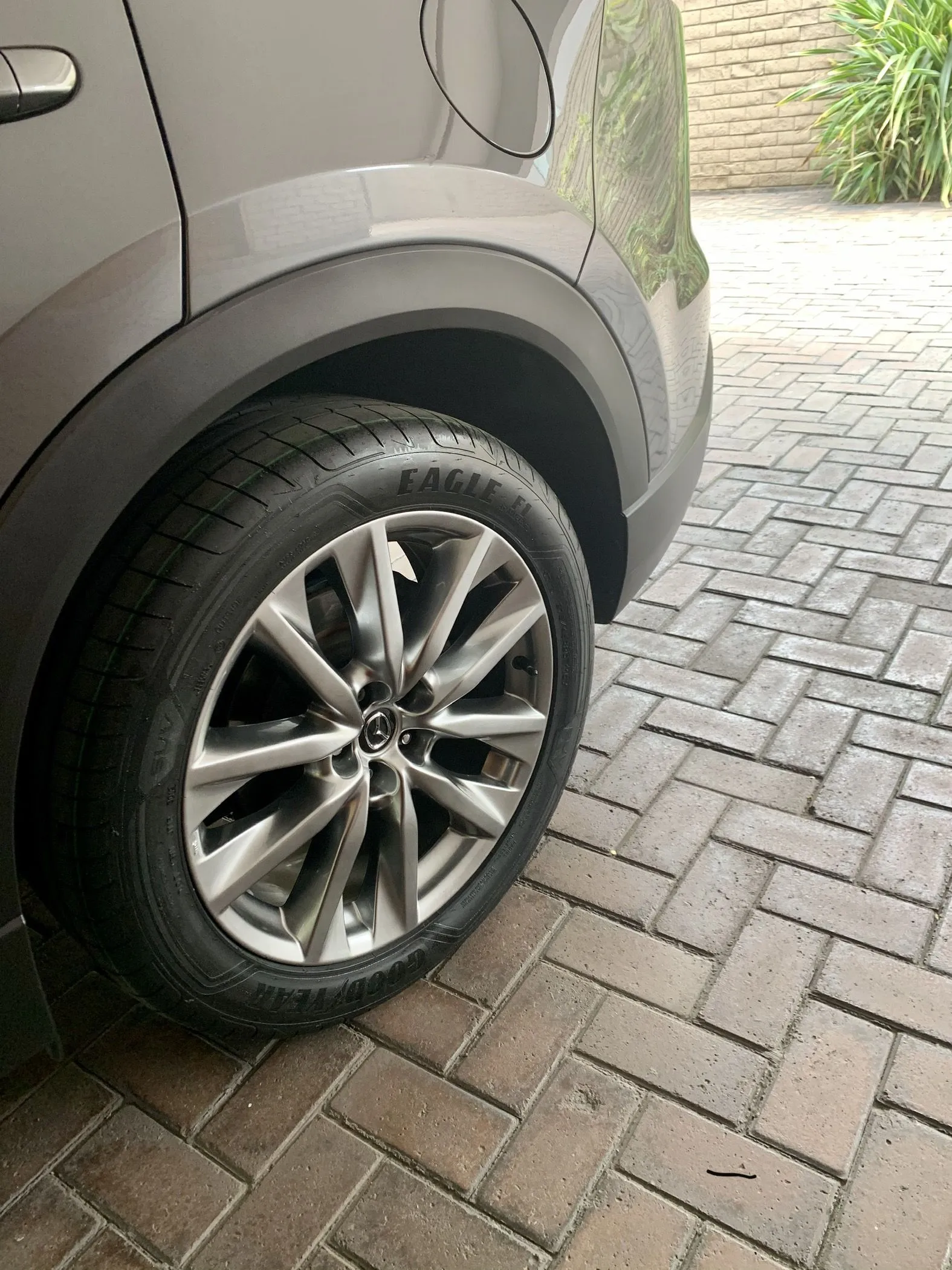

Hello all and thanks for the comments all very useful and helped me make may decision so.... ,
I got some news, this morning I got the asymmetric 3 SUV 275/45/20 s on my stock rims, tried them out on the front first to see if there was enough space, there is a lot of space down there so no problem on that side, after having all checked we put all the 4 new tires into the rims and balanced them.
First impressions:
a) There is a little more noise than with he Ecopias on smooth surfaces .
b) Instantly you can feel the steering faster ( i wasnt expecting that ) turn in is faster although the tire is wider
c) noise is down when driving on rough pavement, much much better now , this is where the Ecopias really sucked, vibration was all inside the cabin while driving on rough pavement ( not bad pavement just rough)
d) much smoother specially over potholes and as said before rough pavement.
e) Looks ; even though this is the minimum rim width for this size of tire it looks very flat ( squared) on the side walls , i was afraid it would look with a belly ( something that happens when u use a fat tire on a slim rim) but it doesn't, it just looks great. also when looking the CX9 from the back you can tell the tire looks wider and better than the Ecopias.
f) stickier? yes much stickier although i will let a few hundred miles for the tyre to adapt before putting it into their limits in cornering.
Yes , of course I'm thinking about putting new 10 inch wide rims LOL. !!!

Awesome, I new techinically they would work, and glad to see plenty of clearance. As I mentioned, there is a window within tire size standards, and some can be on the narrow end, or wide end for the section width (which you described as flat or belly for the sidewall profile) and also the tread arc width, which there is no standard for, and can vary depending on the tire design. The Goodyear Asym 3 is a narrower design, so probably not much wider in section width than the OE 255, so its a squarer looking tire on our relatively "narrow for this size" wheel. But the tread arc width is wider than the Ecopias since its a 275, so its a win!
Thanks for the feedback and pics.
yes, the tire will "relax" and break in, about 100 - 500 miles, as will mold release wear away from the tread surface if any was present, so handling will only improve. Thats the benefit of a UHP tire vs the low RR tire like the Ecopias. If you have only summer climate, then you are set!

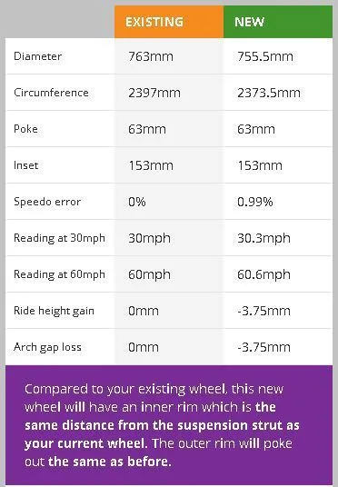

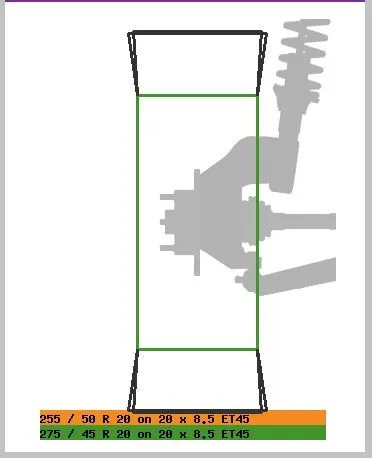

ALENZA SPORT A / S RFT 275/45/20 can fit CX-9?Can someone help answer?
Comparing OEM 255/50/20 to 275/45/20:
Looks like it would be fine. According to this, the specs say this size is best suited for a 9" wide rim, so you just need to be sure it will be okay with an 8.5" rim (should be fine).
