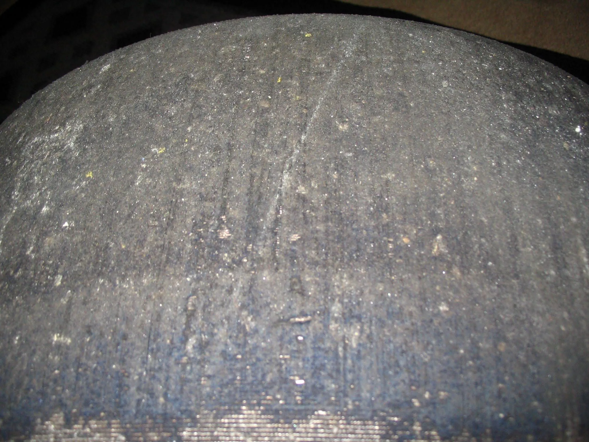

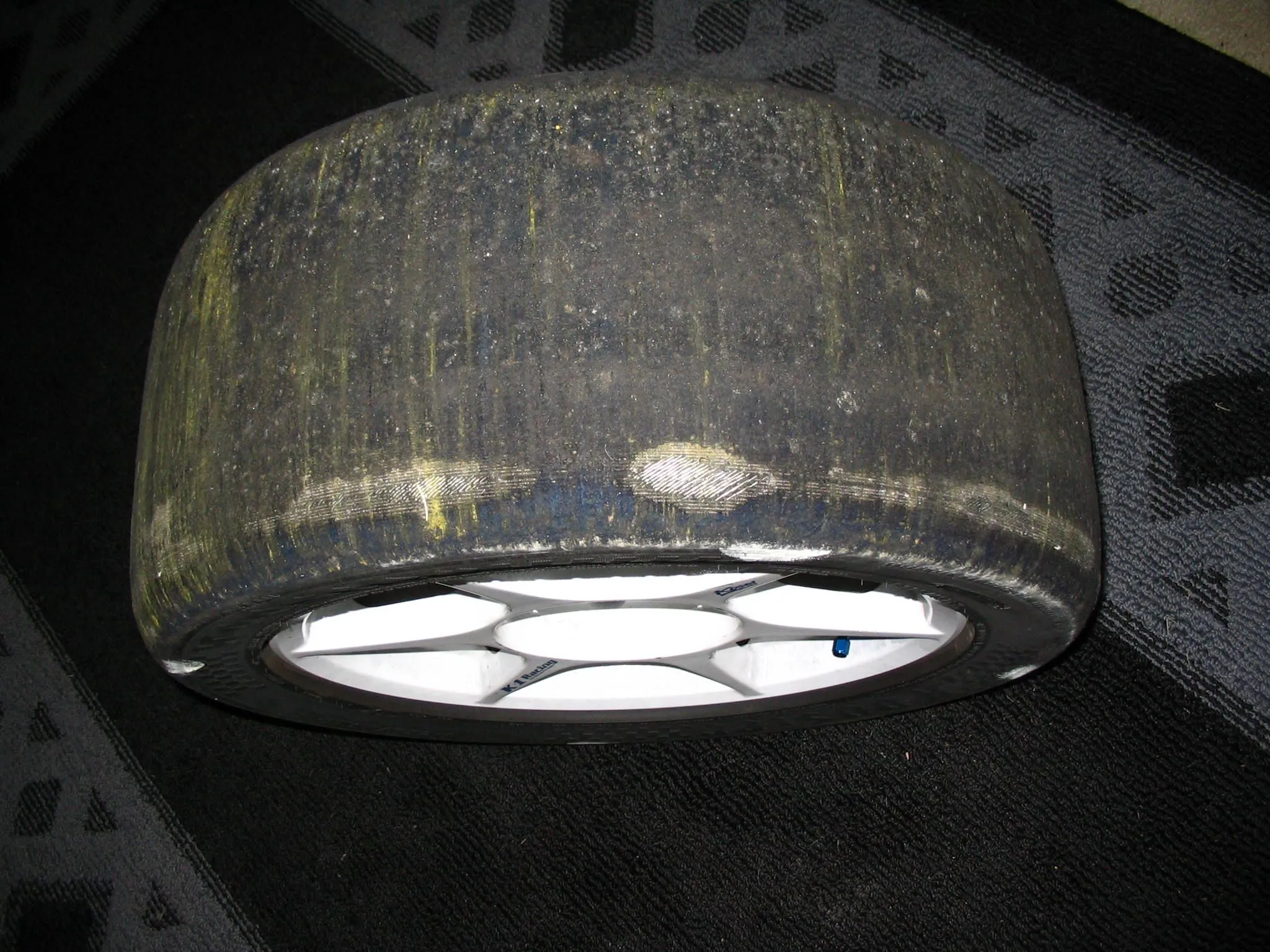

Here is a few pics. The second picture shows how the little tread is left over the whole tire, although the lateral groves came from when these tire were switched to the back and I spun out twice in one run.

Dang, what kind of surfaces are you running on? I have 20+ runs on my Avon TechR with less than 1degree of neg camber, and they are holding up fine. I will probably flip them on the rim after the next few events since I can see just a slight bit of "wedge" from inside to outside of the tread width.
Maybe that's what the Hoosiers are, grenade tires that you break-in and just use for 2 events and then they are done. Expensive.
I don't see your DOT grooves in the tire any longer at all?
