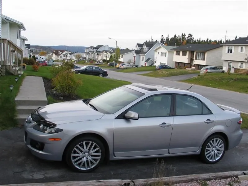

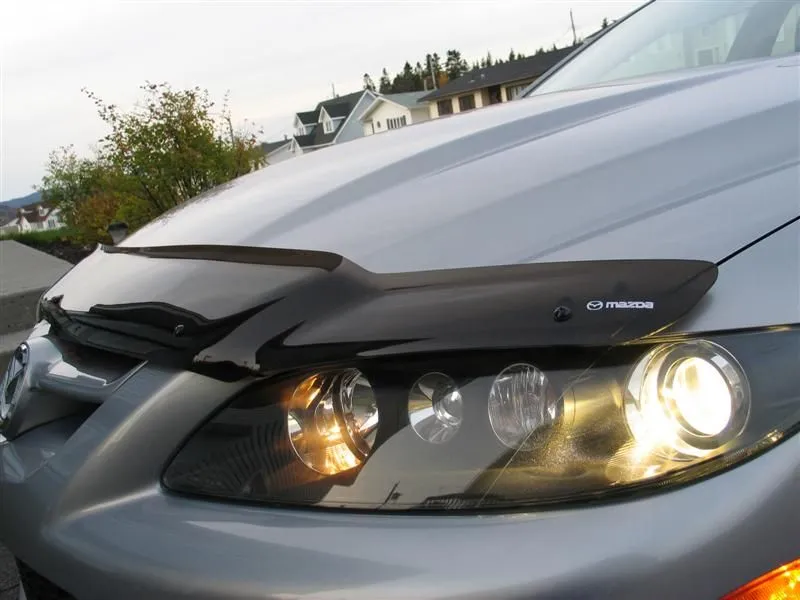

Called the dealer...they told me that it's the regular 6 bug deflector that is installed on their MS6 and it was a perfect fit (I saw it myself). You can go ahead and order that.
quick pic

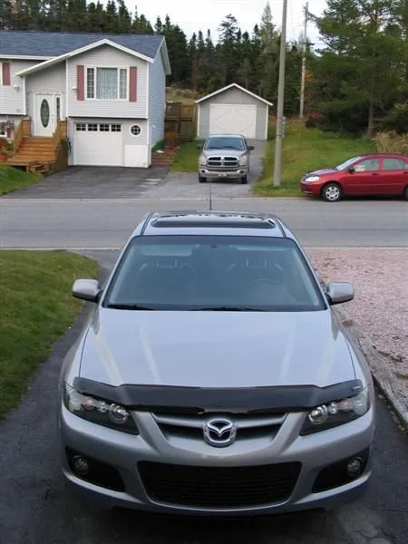

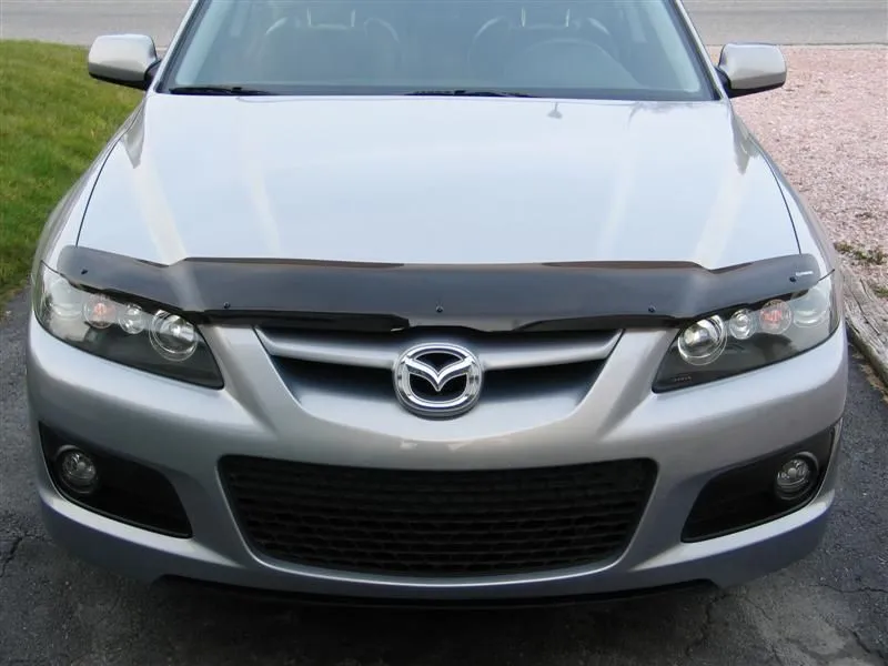

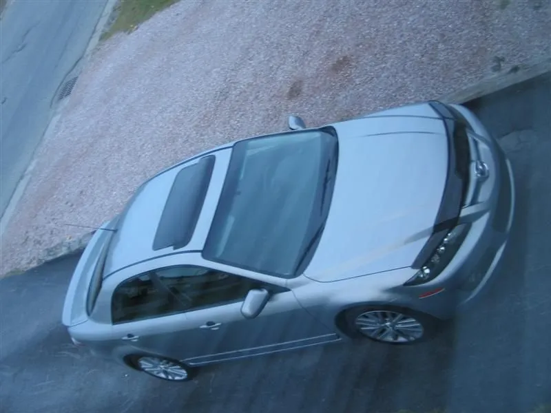

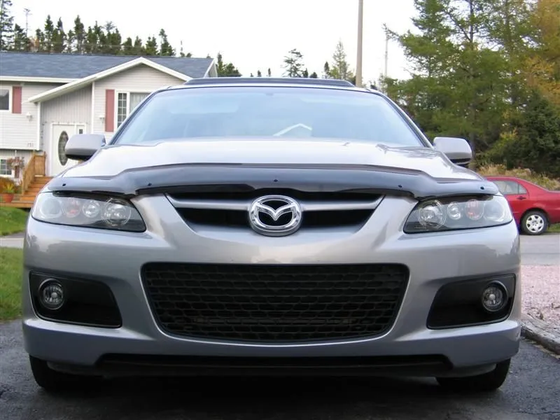

Is it a perfect fit? Nope. The hood bulge makes it a tight fit in the middle. Luckily the plastic has some give in it. Once it is on right though it seems ok. I'm hoping it still has enough flex in it for bumps and change in temps so it doesn't crack. I might be over thinking this a little.
Tip: Clean hood before installing. And put small towel or cloth over center of hood ( on the bulge) because until you put the rubber bumpers under neath it to hold up the center, it will touch and possibly scratch hood.
