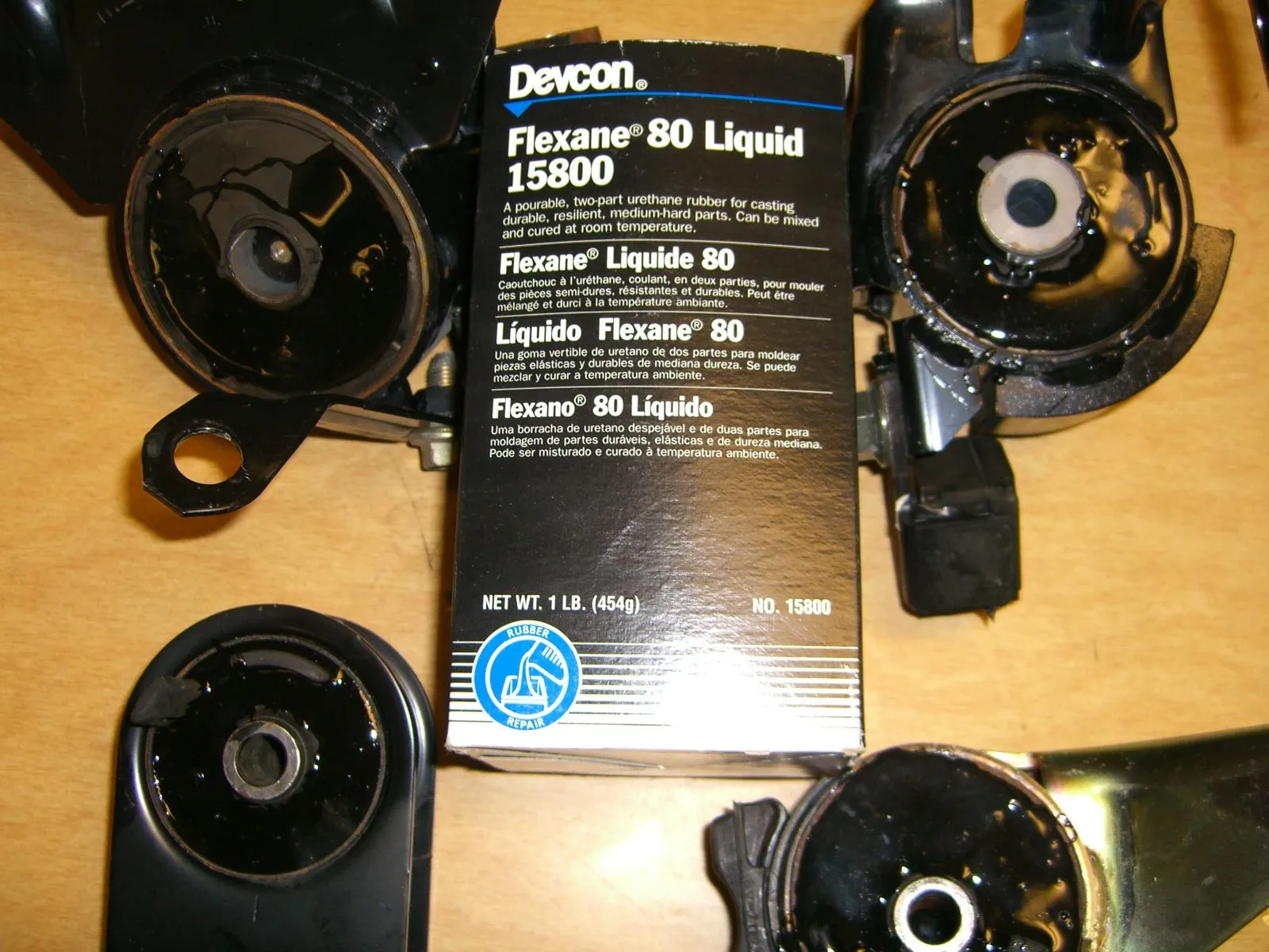

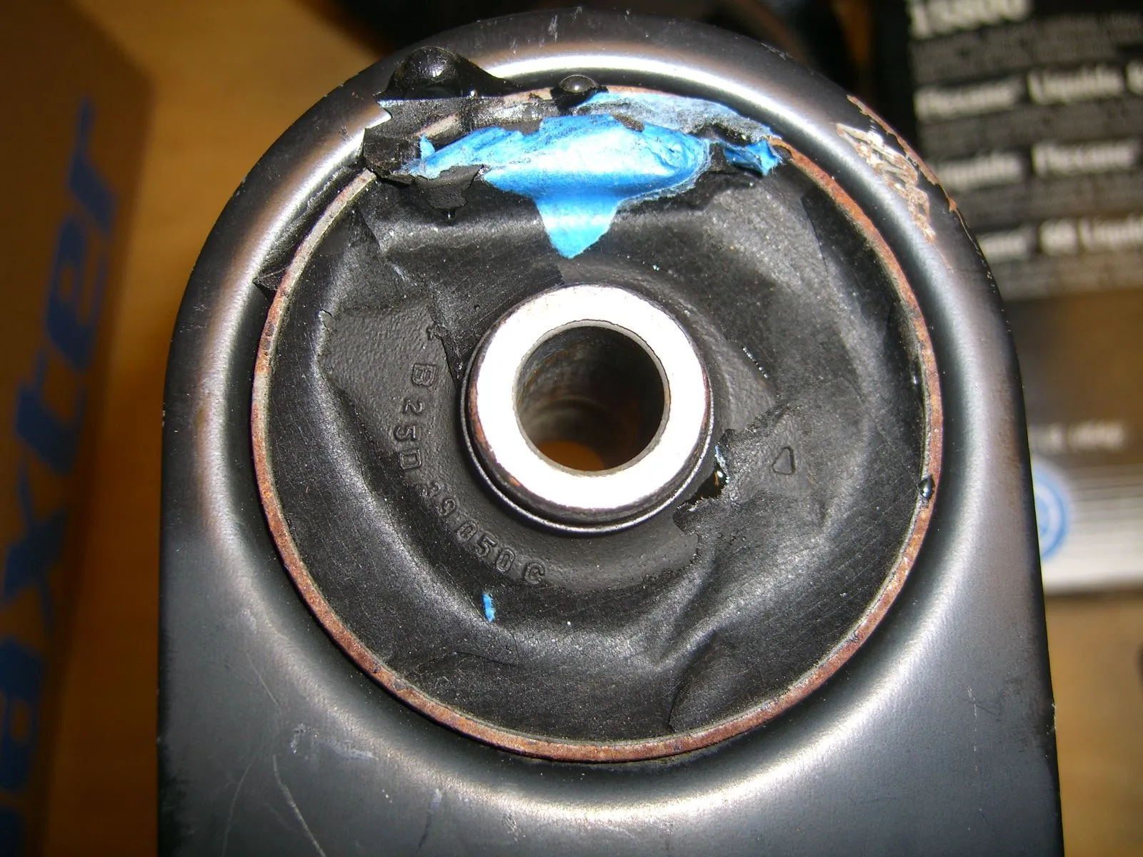

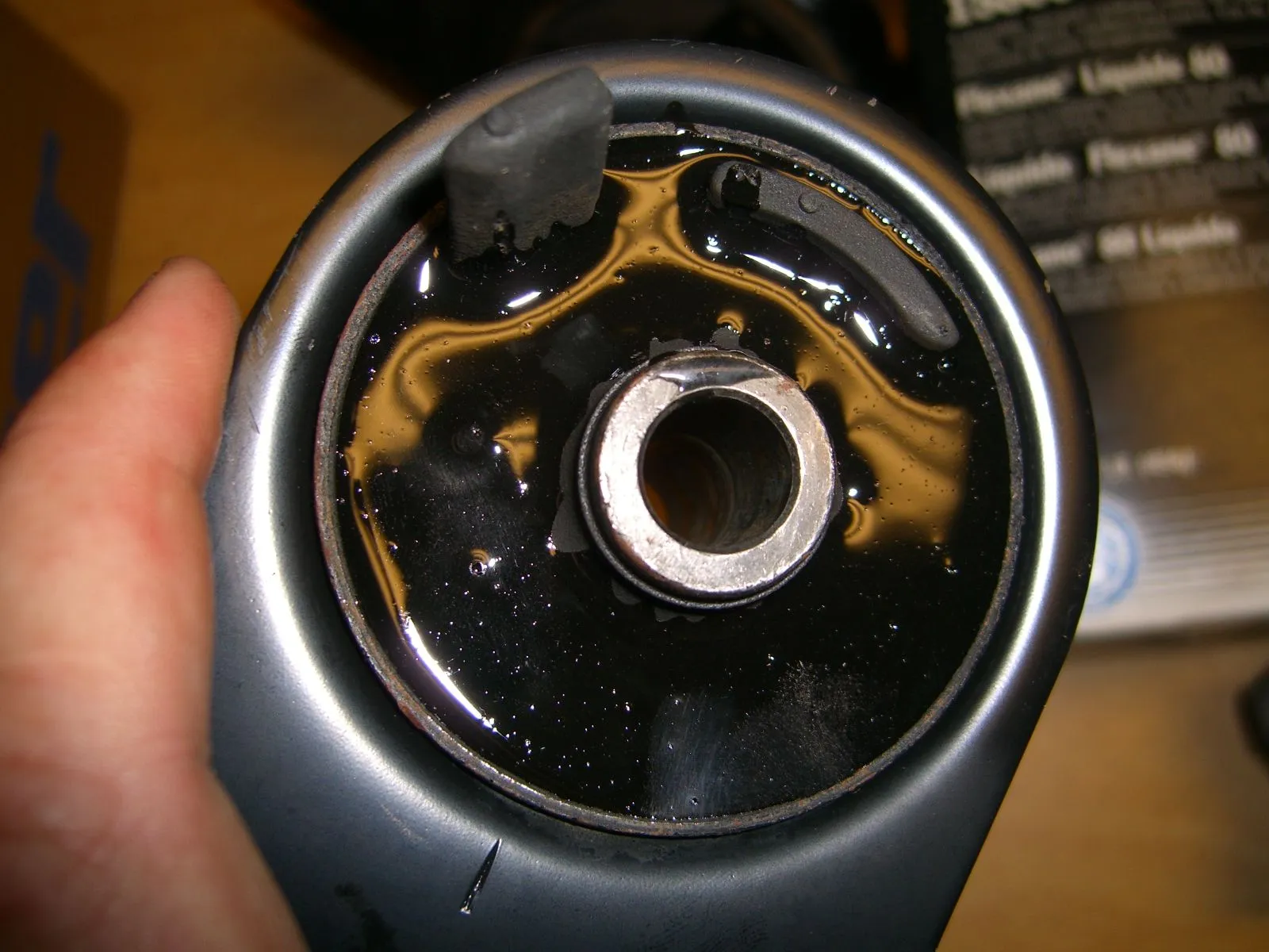

Well, I had some Devcon Flexane 80 shore lying around for over a year now and I finally got a chance to do my mounts. I spent $15 for a pound of this stuff and I would say that 1lb is just enough to do eight mounts (yeah, I had a lot of waste). Unfortunately, I got a good deal on this stuff, it is normally about $40-50. I blue-taped up one side of the mounts and then poured in the other side. This might be how Turfburn does his, I don't know...(Don't worry Steve, I'm not selling these!) :)
You can see how the urethane perfectly matches the stock rubber when I remove the tape. Where there is no tape, it is nice and shiny! Enjoy!
