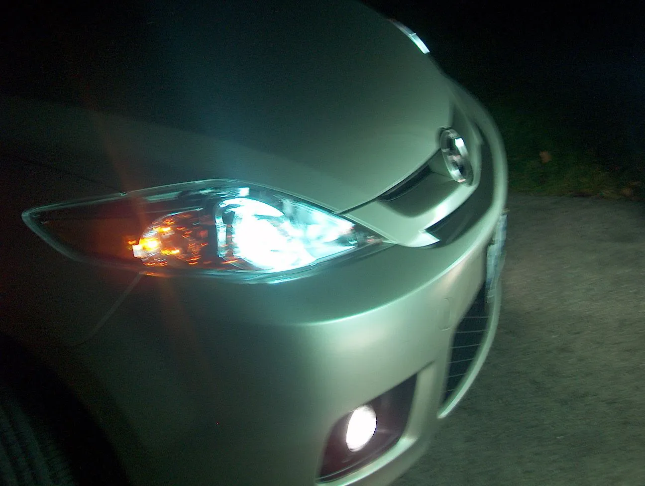

Installed a MTEC HID kit this weekend. Quite easy once you know which wire to use to activate the relay for the DRL modual. I have everything hidden very nice in the engine compartment. The wire to give the signal to the relay to deactivate the DRL's is the grey and black wire that is plugged into a connector beside the driver headlight. There are three wires in the connector, grey and purpule, black and pink and grey and black. I will take pictures this week and post them. With this install, the lights work in the auto function, but no day times yet. Eventually, going to hook up the fogs for my day time running lights.

There are three wires for your turn running lights. 2 power wires and one signal wire. To disable your DRL's, the only way i figured out how to do it was with a relay kit. The relay kit has instructions on how to hook it up, but requires on signal wire, so the relay know when to power up. The three wires I talked about orignially, one of those wires is the signal wire you need to have your HID's run like your regular headlights (leave the switch on Auto and never worry about them). Negitive is that this deactivates your DRL's. I have not has time to figure out how to run my DRL's to fogs yet. If you want more information, you can email me at my98neon@hotmail.com. I will try to help out the best I can.
