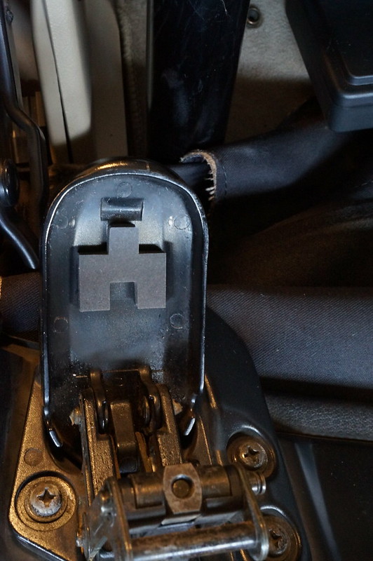

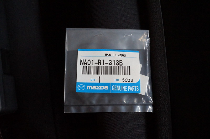

A while back I put some new foam pads on the soft top latches to keep them from rattling when I didn't have the boot cover on. I cut these from some adhesive foam I had on hand. After that I found that you can actually buy new pads from Mazda, so I did that. Here is the number:

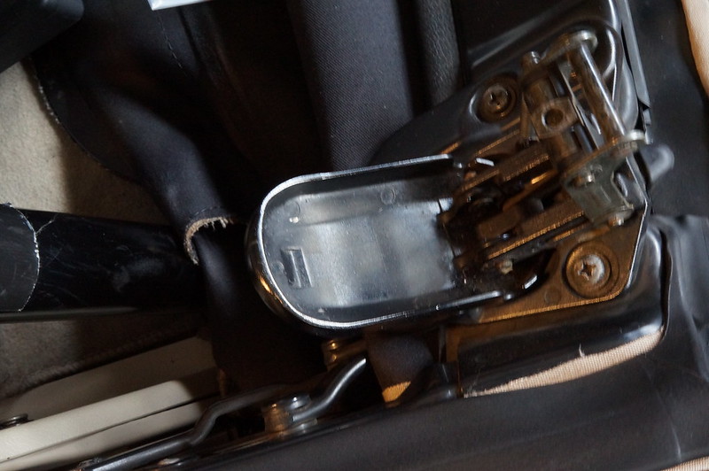

In the morning I got around to installing these. The foam I made mine out of was about 2mm in thickness. As you can see the factory ones are much thicker:
I removed the old ones from here (in case you are not sure of what I am talking about) and then after a good cleaning installed the new ones:

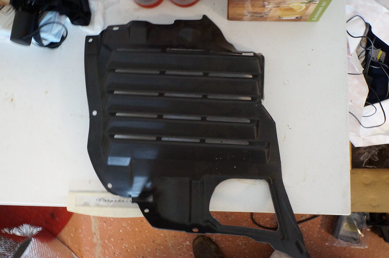

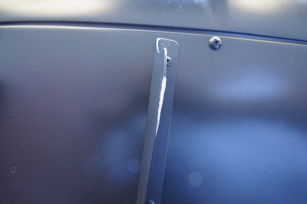

Latches are nice and tight now. Once that was done I also replaced the forward splash guard on the passenger side front fender. It's this piece:
I managed to break the old one at the bottom where the large opening is when I was putting everything back together after the head replacement. It wasn't really hurting anything but the new one was only $32 so I figured why not?

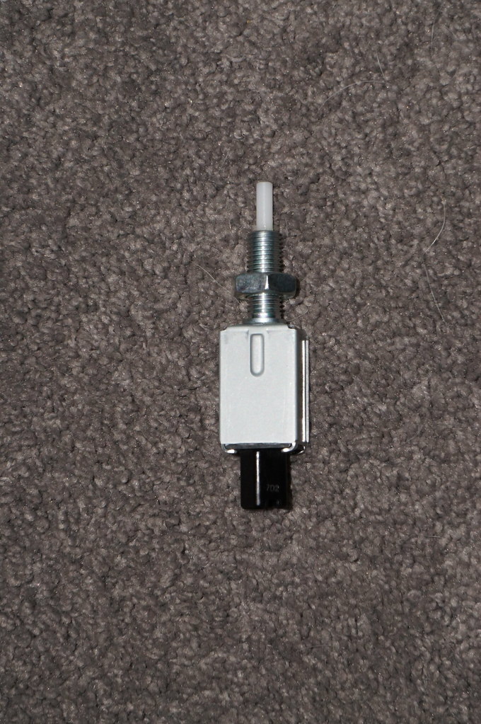

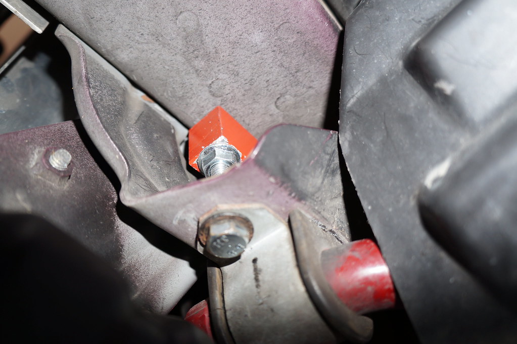

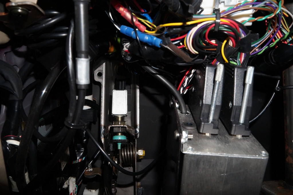

So the switch I am talking about is the one on the clutch pedal that is closest to the driver. Mazda number here:
Here is what it looks like:
And here is where it goes:

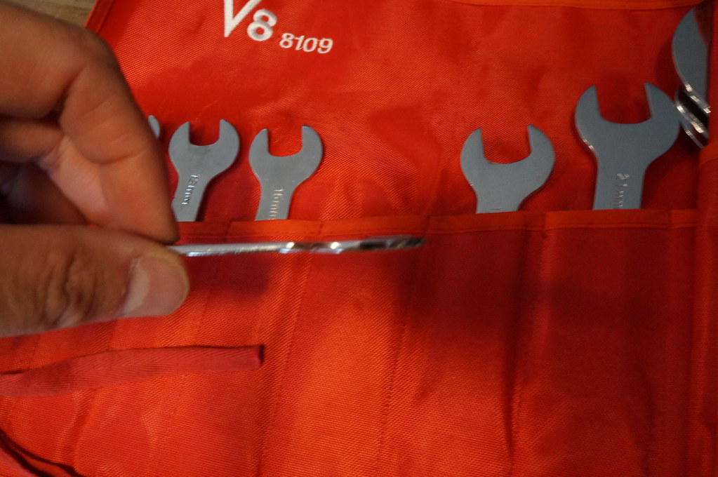

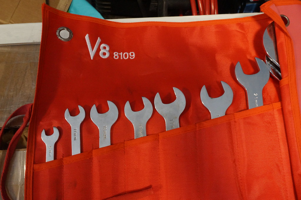

Note the lock nut on it is what allows you to set the height of your clutch pedal. Getting access to this is much easier if you have the seat removed and also remove the plate below the steering column. A set of thin wrenches make this job easier, as so:
You can see the thinness compared to a normal wrench:
On to the test. Unfortunately this did not solve my issue and the cruise still didn't work. On to the next possibility.

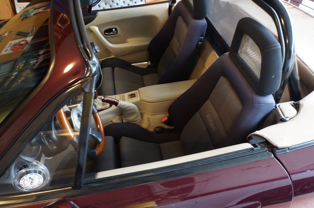

Finally in case anyone has forgotten what the Recaros look like installed, here they are:

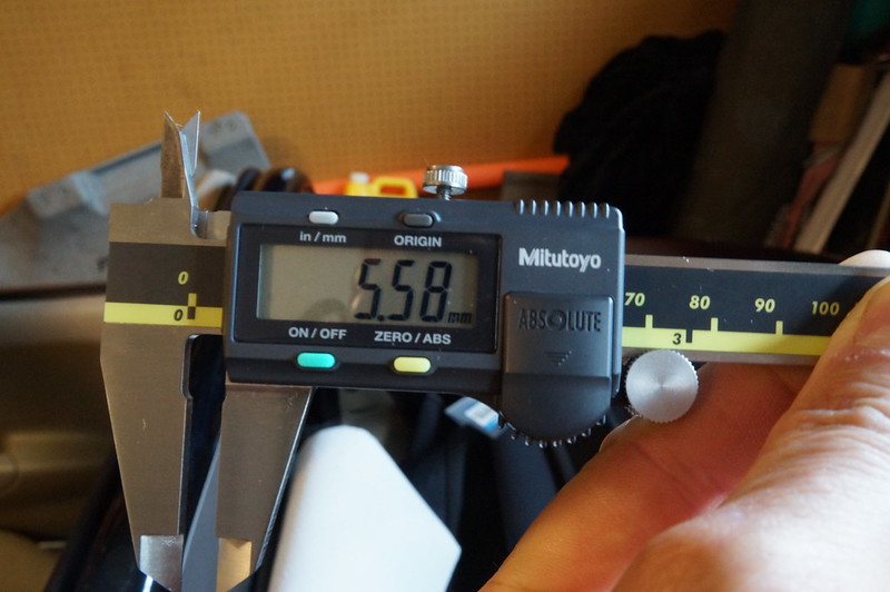

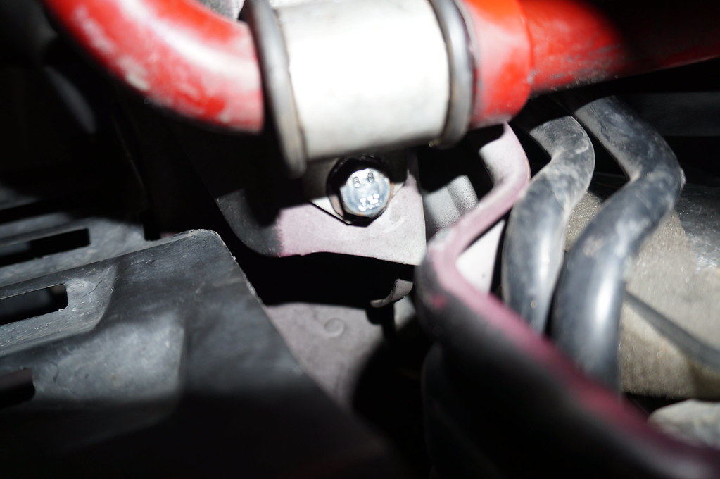

Next mission was to install the RB front sway bar bushing blocks, and troubleshoot the cruise control some more. I looked at the cruise first. Figured I'd take a look at the vacuum hoses to make sure I had no issues. As it turned out I did have an issue, and a big one. I was an imbecile. PSA, a vacuum motor (what the cruise actuator is) works a lot better when it is connect to a vacuum source. Way back when I was getting frustrated with this I removed the connection to the actuator so I didn't have any leak issues. Had to make a run to Ace for a tee (I am also running this line to the boost gauge), then made the actuator connection. Got back from a test drive, and I had cruise control again! Note, the problem was down to that clutch switch I replaced. I haven't heard of anyone else having this problem, it is usually the pad on the clutch pedal missing but it makes sense. How many times is that switch cycled during a normal drive?
While I was at Ace I looked at M8 X 1.25 bolts again. Ended up buying some that were 50mm in length. After the vacuum hose connection (but before the test drive) I hoisted her into the air and pulled the engine belly tray. Removed one of the bolts from a sway bar bushing bracket and checked it against the tap I bought the day before. It matched up so I knew I had the correct size. I then proceeded to check the tap against the new bolts. Again they were fine. Next was looking at the longer bolts I had bought previously. What I found REALLY pissed me off. Three of the bolts were the correct size/thread pitch, the other one was M8 X 1.0. Some fidiot had put it back into the wrong package. What is ironic is I had just had a conversation with an employee at the very store a few days ago about how people can't put **** back in the right place. I had checked the bolts against each other but totally missed that one was off.
With that mystery solved I proceeded. Removed all the stock bushing bolts and chased the threads with the tap. I then ran one of the longer (60mm) bolts in to check for clearance. It was bottoming out so I decided to remove a little length. Here's a tip, if you are cutting a bolt down put a nut on first prior to removing material. Once you get the length you want file the end of the threads to put a bevel on them (I used a thread file I have) and then remove the nut. It will clean up the threads for you so you will be able to get the bolt started. I cut them down to about 55mm. Then I put everything together. I found the blocks I have weren't drilled correctly so it was tough getting them on both bolts. After some trial and error I ended up starting the bolt enough to get the locknut on and have about 5mm of thread showing, then putting the block in place. After that what worked best was to run the bolt all the way up while backing off the locknut slightly so as not to jam it up. If you do it correctly you will end up with the bolt tight and the block close to where it needs to be so you minimize the amount you have to tighten the locknuts (and trust me, you want to do this because of the tight quarters you are working in). I was thinking about putting some blue LocTite on the threads for the locknuts but couldn't really get in there. Since I was short one longer bolt I ended up using one of the new 50mm bolts in the front position on the driver's side. Thanks to interference with the lower radiator support on that side that is what I needed to do anyway. Even then it was tight, if you look at the four o'clock position from the bolt head in this picture you can see the shiny spot where the bolt head rubbed on the bracket while being tightened (couldn't get the camera to focus on that spot):
Here is how they look, notice how they match the color of my front sway:
When you tighten up the locknuts be sure to go back and forth, front to rear and retighten the nuts. I had to do this many times on each side to be sure they were all tight enough. This may have had something to do with how mine didn't want to slide easily over the bolts, but it's good practice in any case.

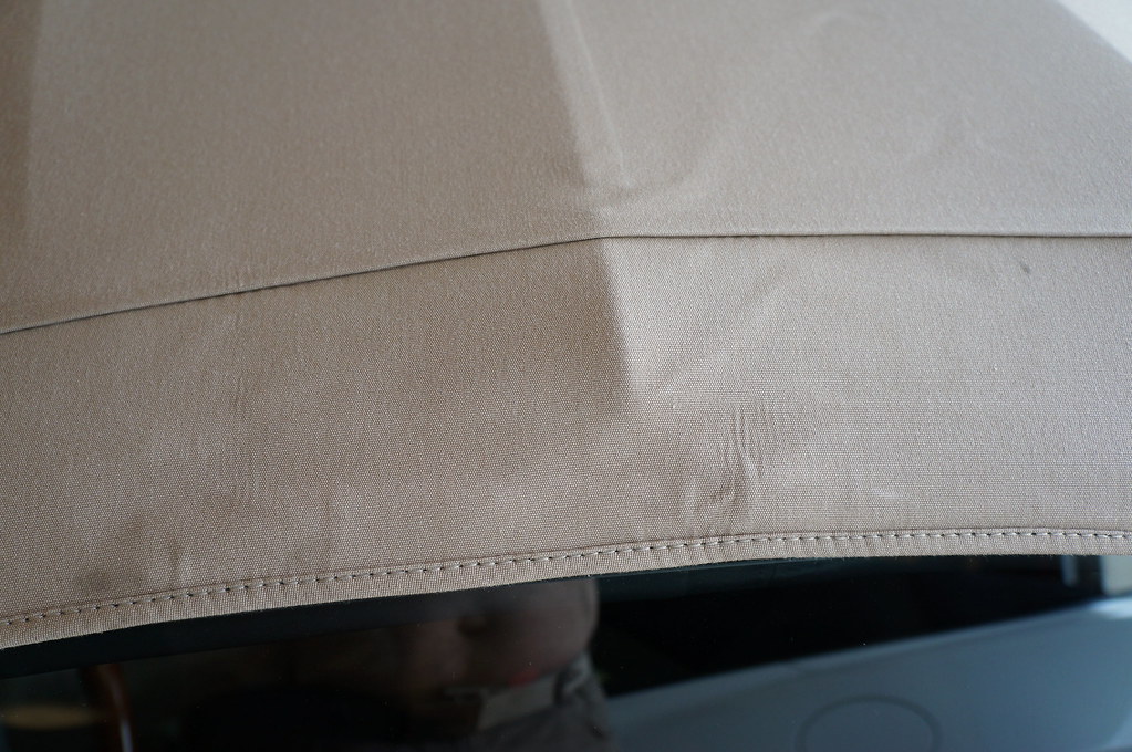

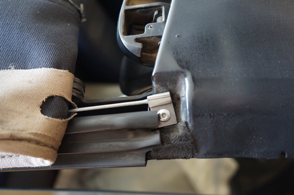

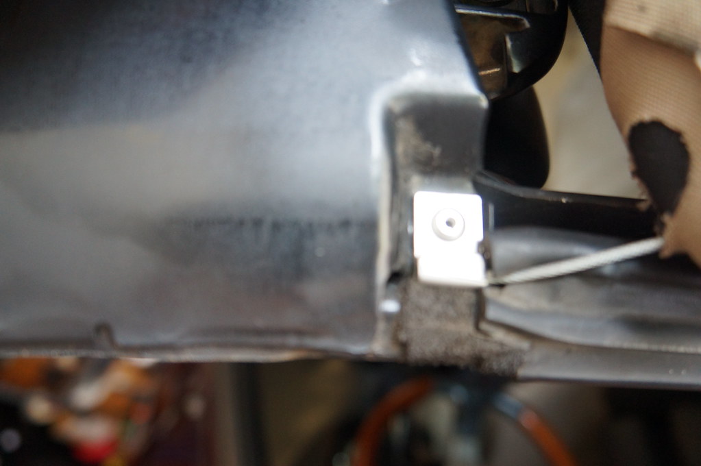

I was doing some reading on M.net and found that the crease in my soft top above each window was because I had installed the tension cables incorrectly. While I was waiting for her to dry for the waxing I figured I would take care of that. It's fairly simple to fix, you just pull the top back off the front bow also removing the front weatherseals and channels. Here is how it looks when it's wrong:
And here is how it looks when it is correct:
Note this was taken on the opposite side from the incorrect installation (so you aren't seeing things. Well maybe you are, but not in relation to this). I used 3/16" dia pop rivets with a grab of 3/16 to 1/4".
This is an easy mistake to make with aftermarket cables as they are different than the factory ones, and as you can see from the initial picture the tab fits very nicely in the recess in that configuration. The proof is in the pudding though, here is how it looked when the cables were wrong (note the crease above the window):
Here is how it looks with the cables correct:
I expected it to smooth out over time (it did). It was interesting that the top was now easier to latch despite the cables having more tension on them.

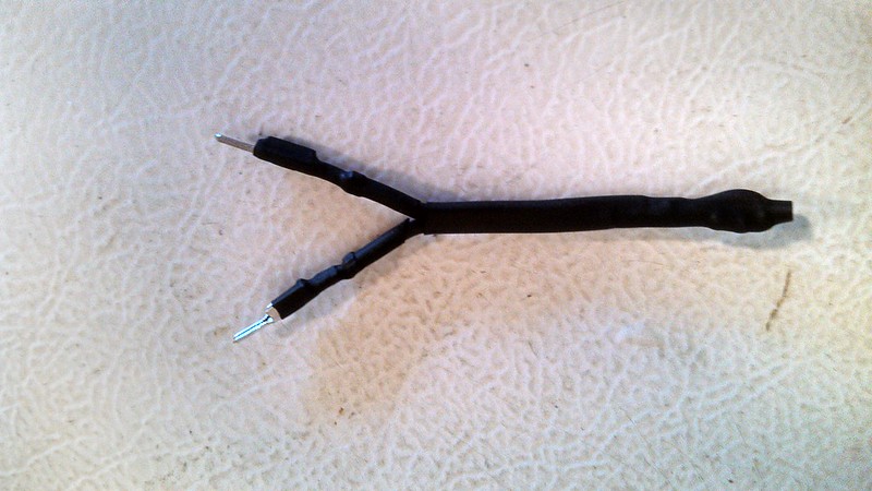

I went ahead and cut the connectors off the GS airbag resistor and soldered them onto one of my 3.3 ohm resistors. That was installed then.
