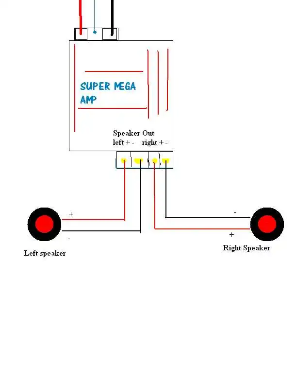

I just got an amp and I'm trying to hook them up to my component speakers up front and I'm having trouble figuring out what to do. The power, ground, and remote turn on, and rca's are all connected. I just don't know what to do about the connecting the speakers. Its a 2 channel amp and there are four slots for speaker wire the right and left positive and negatives. I'm stumped on what to do next. Any help is greatly appreciated.
its just as the amp says, the + - for the left go to your left speaker or tweeter, or if you have a component set that came with crossovers, like my Kappas came with crossovers.
the + and - for the left goes to the crossover for the left speakers and right with right
I made a crappy diagram, hope it helps

I think I understand now. So I can just cut the speaker wires from the deck and connect the wires not connected to the deck to the amp? So the wires for the speakers on the deck are not used correct?
