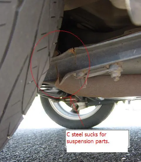

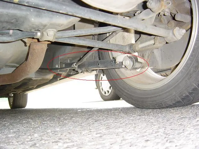

Bent trailing link
I spun out this past winter duirng a snow storm, but it's not until recently that I've notice my alignment is off... so I check all the wheels... look straight, but upon detail examination yesterday on my passenger side rear suspension....
:( Looks like if I bounce it couple more times it'll snap... so what is that part called? Lower control arm? If anyone can identify this part I'd be grateful so I can go to the parts store and get it asap... thanks in advance

NICE! Thanks everyone! :D So let me ask you guys this... (I know nothing) what's the benefit of having a upgraded trailing link alone? Since if I go purchase these I'll be installed these alone without anything else...
HOly crap, that doesn't look good.
For the record, lower control arms will always be perpendicular to the direction the car travels.
Yeah, I agree, thanks for the info about the control arm. Hehe feels like a noob now for not knowing that...
And I ordered the AWR trailing links and should be in Wednesday. I think their tube steel construction could prove to be much stronger than the C steel it originally has.
Yeah, and it's going to T-storm in Jersey too... yukes... I hope you won't spot a silver P5 on the shoulder missing a wheel or something... :D

Benefit? You'll be able to ride more walls without cracking it again. ;)
