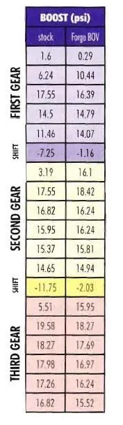

So, which valve would you rather have?
That "POS" supposedly leaking stock valve actually held boost higher than the leading aftermarket valve, the Forge, in 3rd gear and higher where there is load on the engine.
The chart is in the published comparison by Grass Roots Motorsports Magazine on a gen 1 MS3.
Me, I'll take the one that holds higher boost under load when I need more power rather than the one what "recovers" quicker when granny shifting around town. The Forge "felt" more snappy. The stock valve allowed the engine to make more power. I'll take power, thank you.

I posted the chart on the comparison between the stock valve and the Forge ver 1 from Grassroots Motorsport Magazine. That is hard objective evidence that the stock valve held higher boost once the car got into third gear, where there is no power hold back.
And the claim that the Forge valve is inherently inferior to its aftermarket competetors is simply . . . unsupportable. Again, go over to the MSF board and spend a little time to see what the power users are actually running . . . usually either the stock bpv or the Forge, unless the are custom tuned to run full VTA, usually with big turbos, and then preferences change based on need to hold much higher boost than the K04 could ever produce safely.
The stock valve holds solidly well above the safe limits of the K04 turbo.
In order to really compare a stock bpv vs bov's. Compare them all, not just the forge! Ever see dyno charts for the RSX forums or for the Si forums for the K20A2/Z1/Z3 motors? They test each header to compare which header puts down the most hp and do several dyno pulls....This is a real comparison.
Just because there is one magazine indication the stock bpv held boost longer/better than the ver 1 forge, does not indicate the fact the bpv is better!
Provide hard facts or dyno sheets that show the stock bpv is better than any aftermarket bov out there. And it also depends if the car enthusiasts is running VTA or Recirculating. I for one "am recirculating"
