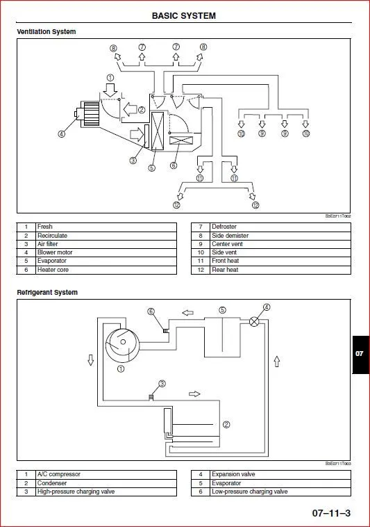

The drawing below shows the heater core is inside the cabin. And of course it is hot, but there is a valve that directs air away or through this heater core.
I think that initially if there was no airflow in the system heat from the heater core of course will linger around. And it is expected to heat up the area of the evaporator too.
The volume of air in this area will initially by hot. Until carried away by moving air into the vehicle and I assume after a while, Temperature of air in the evaporator area will approach that of the moving air (from inside the car - recirc on or from outside - recirc off).
So the bypass valve will work (I see them in many cars when I go to the junkyard). but the problem it is trying to address may not be that much of a problem. The design of the system is such that air does not flow through the heater core if you don't intend for it to do so.
Following is from the 'Technical guide' that used to be floating around the internet.
http://www.mazdas247.com/forum/attachment.php?attachmentid=194017&d=1336921139
Here is a view of the various vanes.
