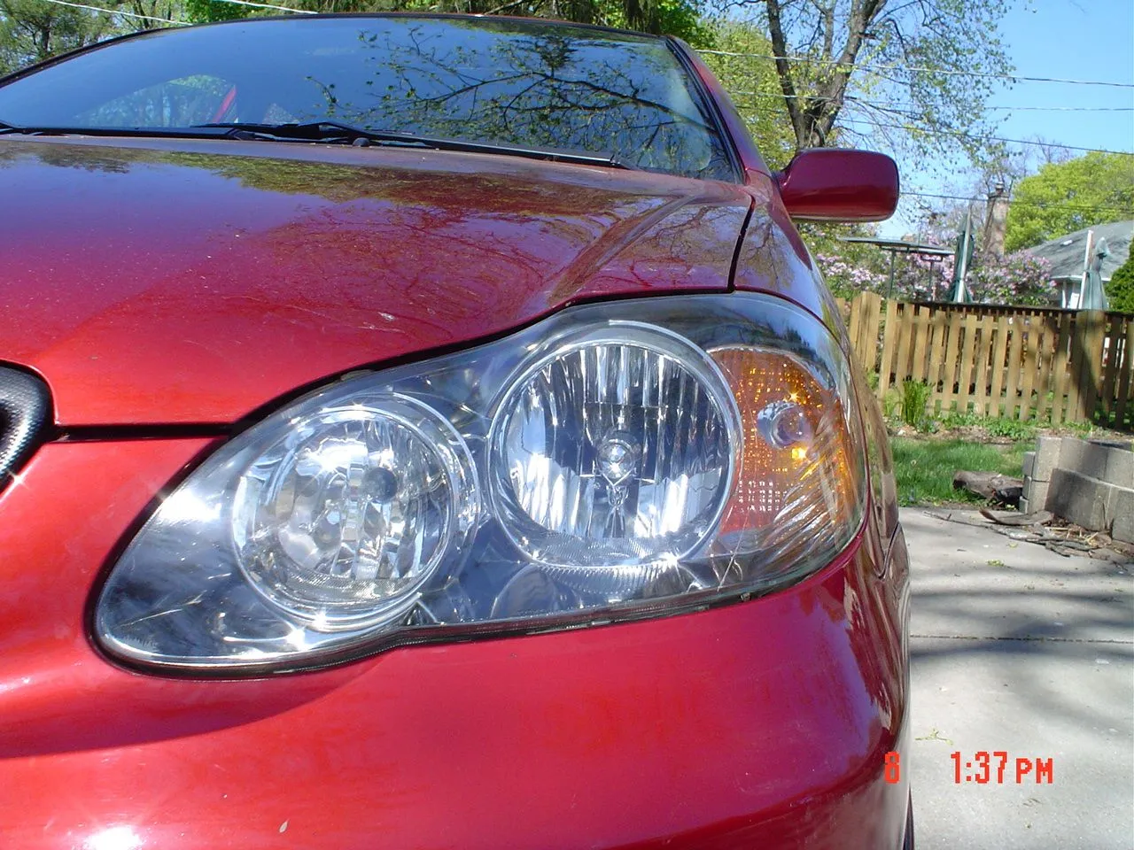

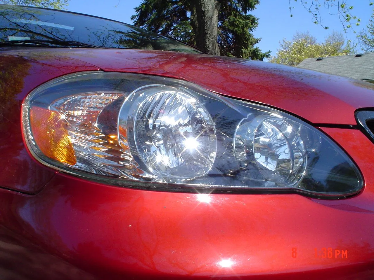

Here's the end result. Make sure you completely cover with sealant; applying more after leads to smeared sealant. I missed a tiny spot on the corner of one headlight and I was more concerned with protection than cosmetics so I added more. It's barely noticeable but you don't want to have to reapply. I suspect spray application would be superior to wiping but you have to find a source for the stuff (which smelled like varnish).
In my opinion they look brand new and well worth the trouble ....

Nice job and thanks for the follow-up pics! Would you recommend going with this brand based on ease of use, results, and price?
It's very good ... ultimately time will tell how the sealant/protectant holds up. The video link I found for the Turtle Wax version looks to do a similar job but for half the price - might be worth investigating that one also. I suspect any of them are good as long as they include sealant/protectant. Sandpaper, rubbing compound are easy to source. The only thing I'm not sure of replicating would be the sealant.
Anyway you slice it, $20 for the Sylvania version is inexpensive. As I said, Turtle Wax version is $10 locally. As mentioned, and as you can tell from the pictures, they look like new again!
