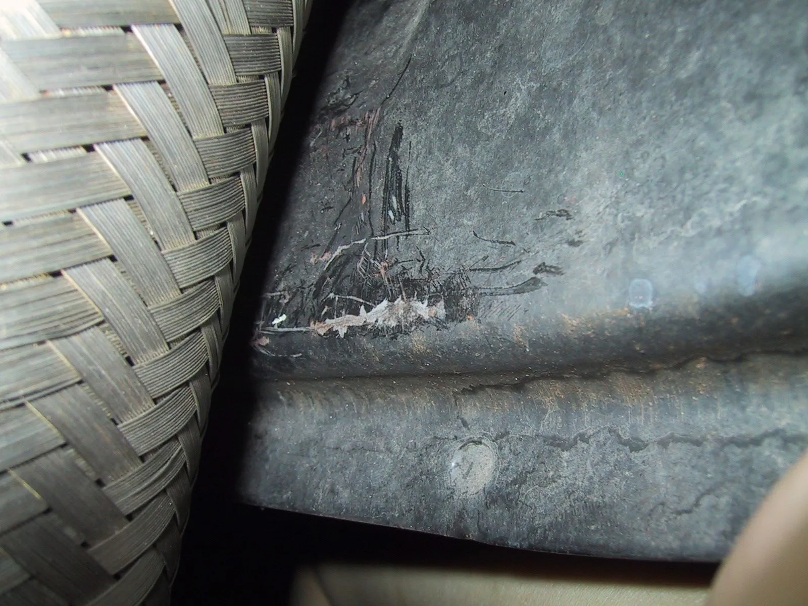

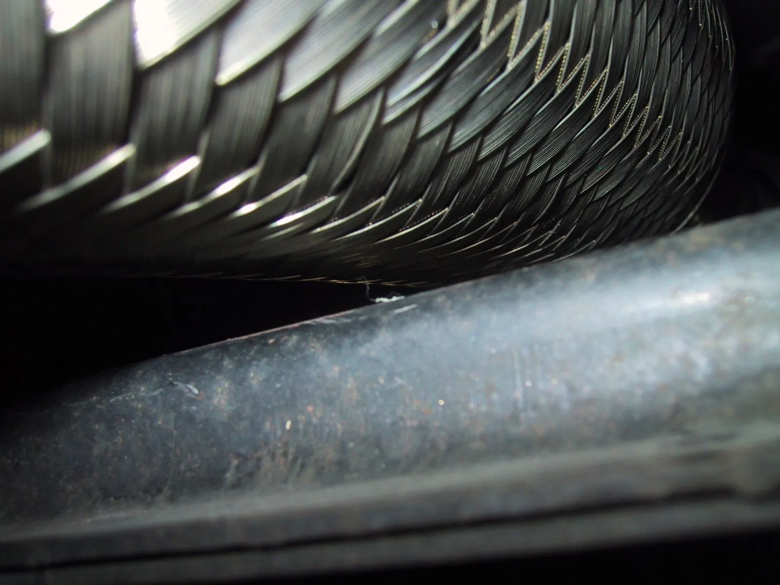

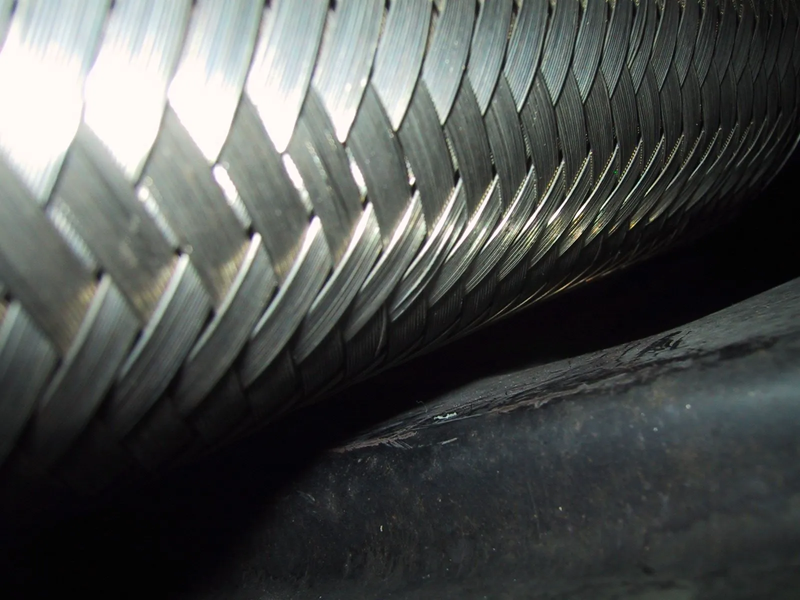

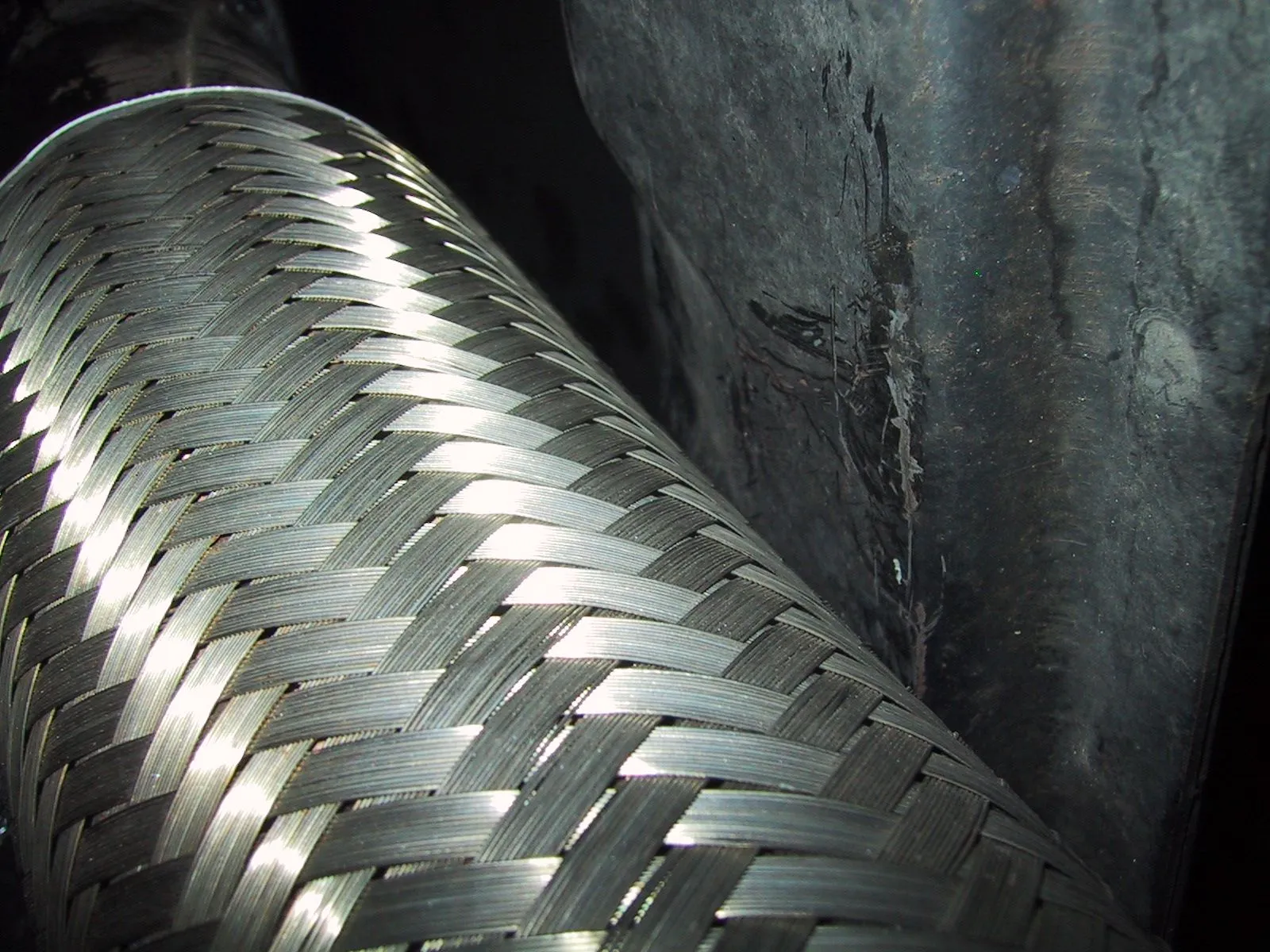

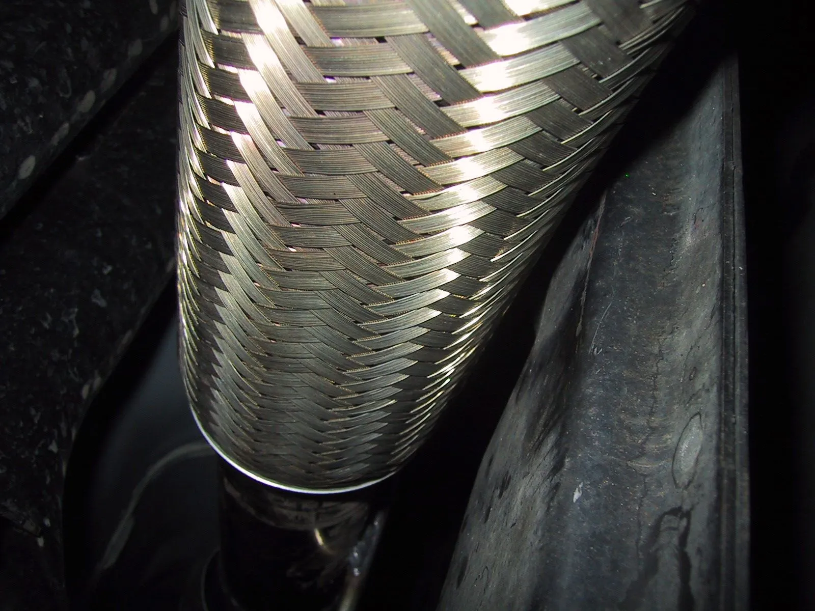

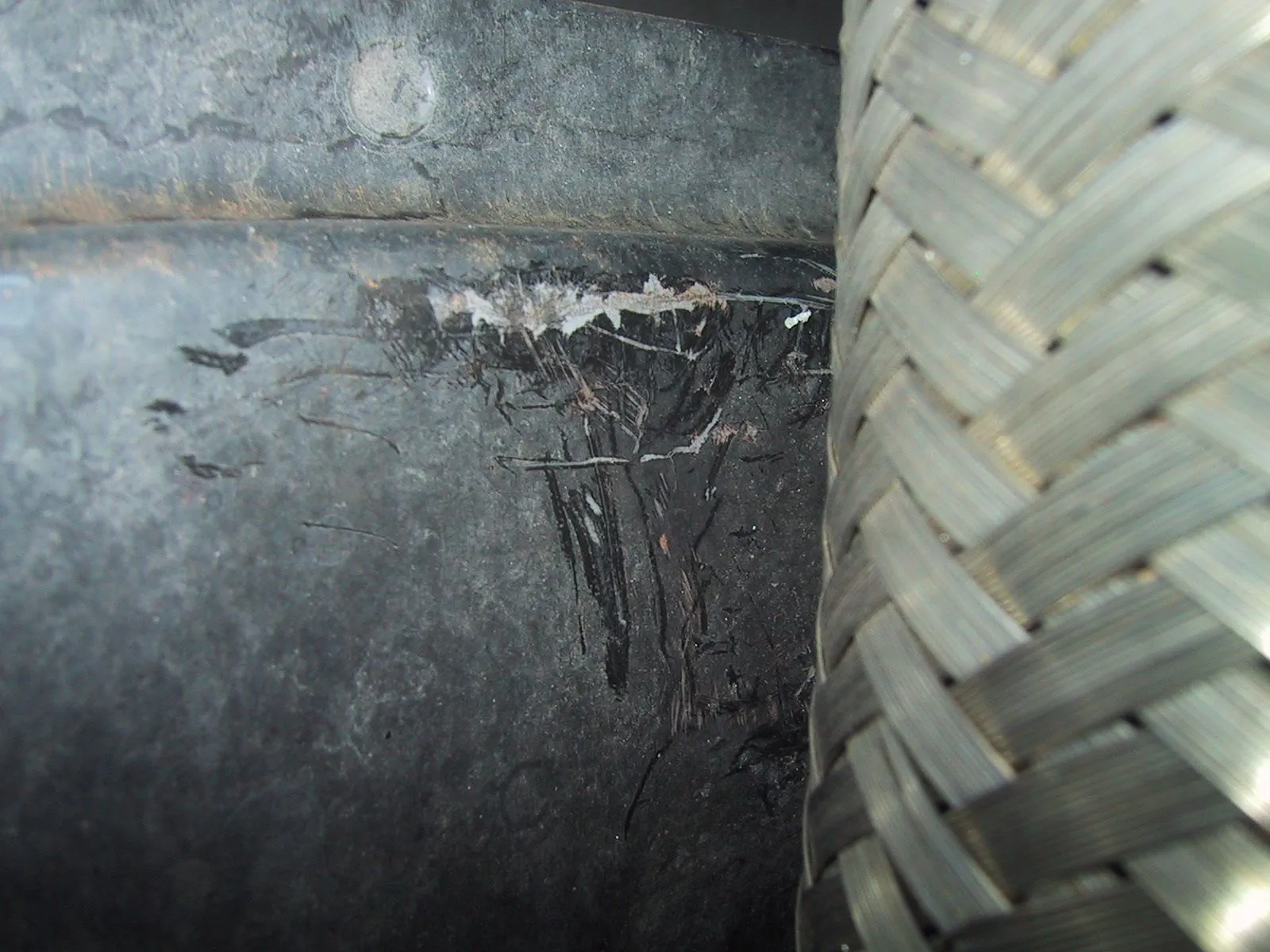

I tried the stock bushings because I thought the same thing. That made it much worse. I took some video. I will try to upload it somewhere. It's 6mb and it shows some pics also. It doesn't show it hitting the crossmember but it shows how it could and the pics show some evidence also.

damn, that sucks. it's definitely the flexjoint rubbing up on the frame when you rev hard.
Mayeb there is some way to either secure it more or put in a hi-temp rubber stopper on the frame to prevent the vibration
