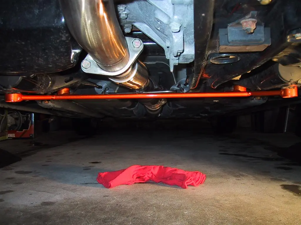

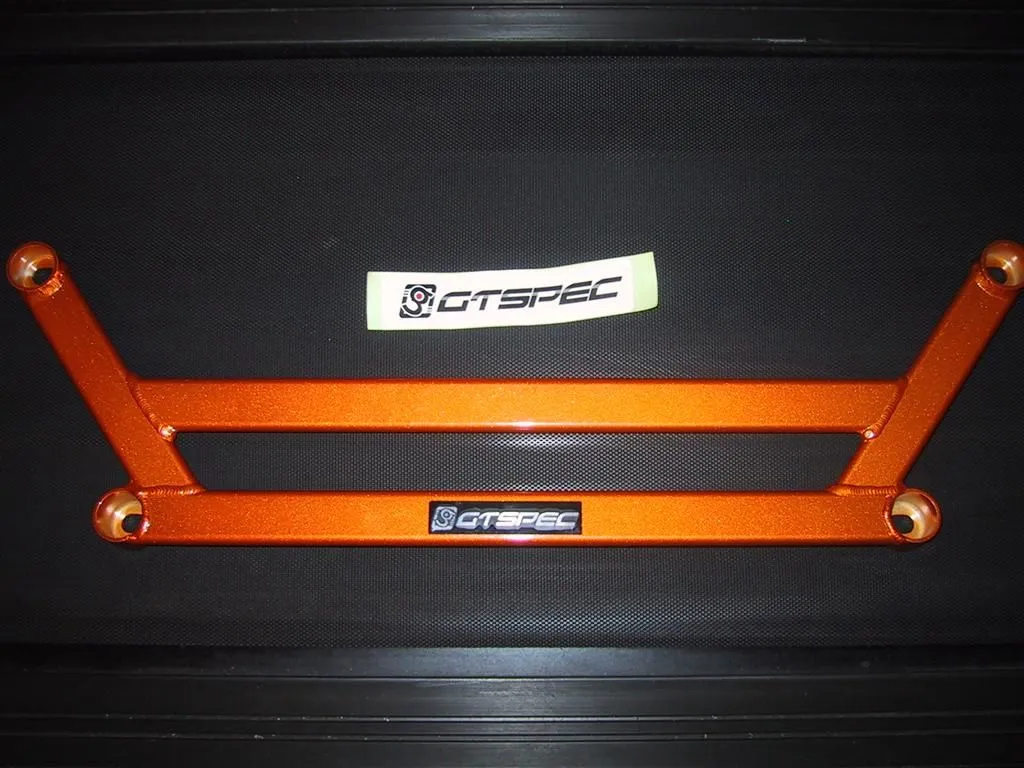

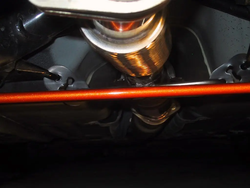

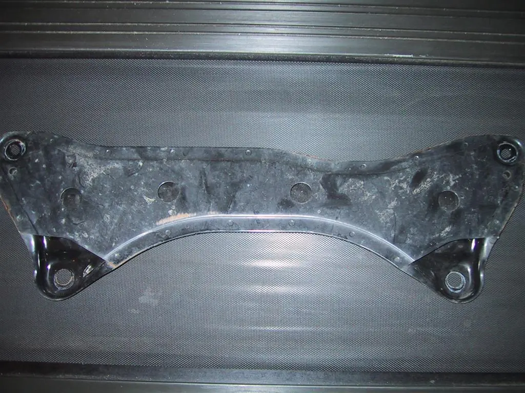

Okay, all fixed. Got the 4 point ladder from Corksport and all is good. Here are a few pics.

The Ladder bar looks pimp......a friend of mine just ordered one for his P5, cause his high flow cat was hitting his crossmember.....pretty much your situation. From looking at those pics, it should be fine.
wow i like that alot. how was the install? noticable diffrence? i like alot of the gt spec stuff prob goign to be my next mods.
Real easy install. Four 17mm bolts and and that's it. No noticeable difference but it weighs a whole lot less. The bar feels like three pounds and the old piece feels 10-15lbs. One of these days, I will weigh it. Anything to help weight reduction.

hey protegespeed! do you think the ladder bar will work on the MAM motorsports midpipe because mine is also hitting the cross member and I too have tried washers but to no luck! -J
