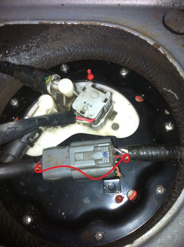

Question, the electrical plug that clip in on top, I notice mine was black taped but one of the wires were cut or ripped off. Can anyone tell me what this orange wire is for? Image added as attachment.

It looks like the orange wire goes into the connector and comes out as a brown wire,... Which is what your picture appears to show.

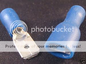

You could get a couple of these and pinch them on at both sides of the connector to rejoin the wire. (bypassing the connector):
Or two of these and a two inch piece of wire to join them:
You could peel back the black covering on either side of the connector snip the wire on the left side of the connector (make sure it's the same wire and pin on either side of the connector) Pinch on a butt connector and a two inch piece of wire then join it back to the wire on the other side of the connector with another butt connector.
Thanks for he great info, I guess it's not normal to be cut, ill try an rejoin them. Is soldering a terrible idea if I cover the area well? I get nervous with gas.
Soldering is fine,... I soldered a dripping gas tank before,.. it's not hot enough to get to ignition point. (I put out a lit cigarette in gas before,... just as a test)
If your fuel filter is new then there should be no gas or fumes anyway.
Soldering is always the best way to join wires. Using shrink tube makes a really neat job to go with it.

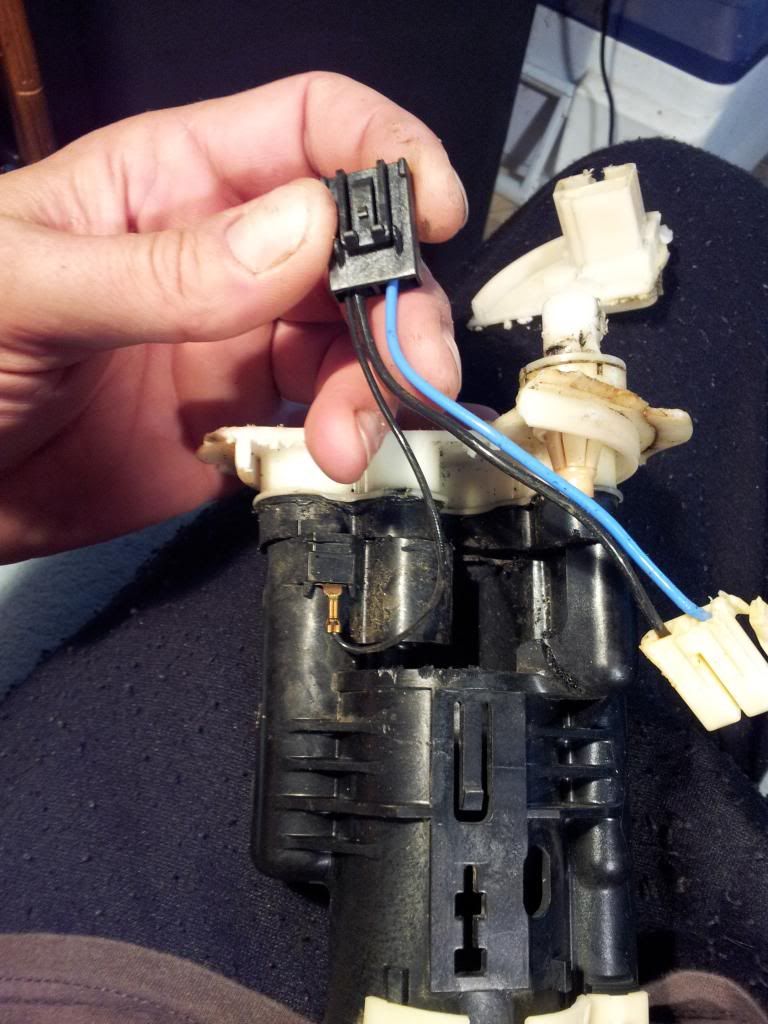

http://www.image-hosting.net/images/messageboard/gotzoom/Protege 033.jpg The Black wire at the bottom of this, to the right near the grey connector, where does that connect? changed the pump on mine and can't find where that wire goes. any help?
I'm not 100 % sure but I think that black wire isn't used. It's been a while since I did mine but I'm pretty sure there was a wire that didn't connect to anything.

I remembered that I still have my old housing so I went and took a picture.
It looks like that little black wire connects to the other black wire inside the black connector.
That wire goes to a tab in the housing but doesn't go anywhere or do anything ??? I'm 95% sure you can just leave that wire the way it is or try to plug it back into the connector.
I do recall that wire. It was connected when I pulled out the fuel filter assembly. The plastic housing may be hiding where the other end of the connection is going. Considering they took the time to mold that into the assembly and add a ground connection, I do not believe they did it for no reason.
If that's an old fuel filter assembly, I guess you could always cut it open to see if the ground connection goes anywhere. I threw mine away.
My housing was already cut. That wire simply goes nowhere. I figure maybe some other car uses the same filter housing and it's just extra for our car. It looks like perhaps another terminal would plug into it on the housing but there is no such terminal for our car.
