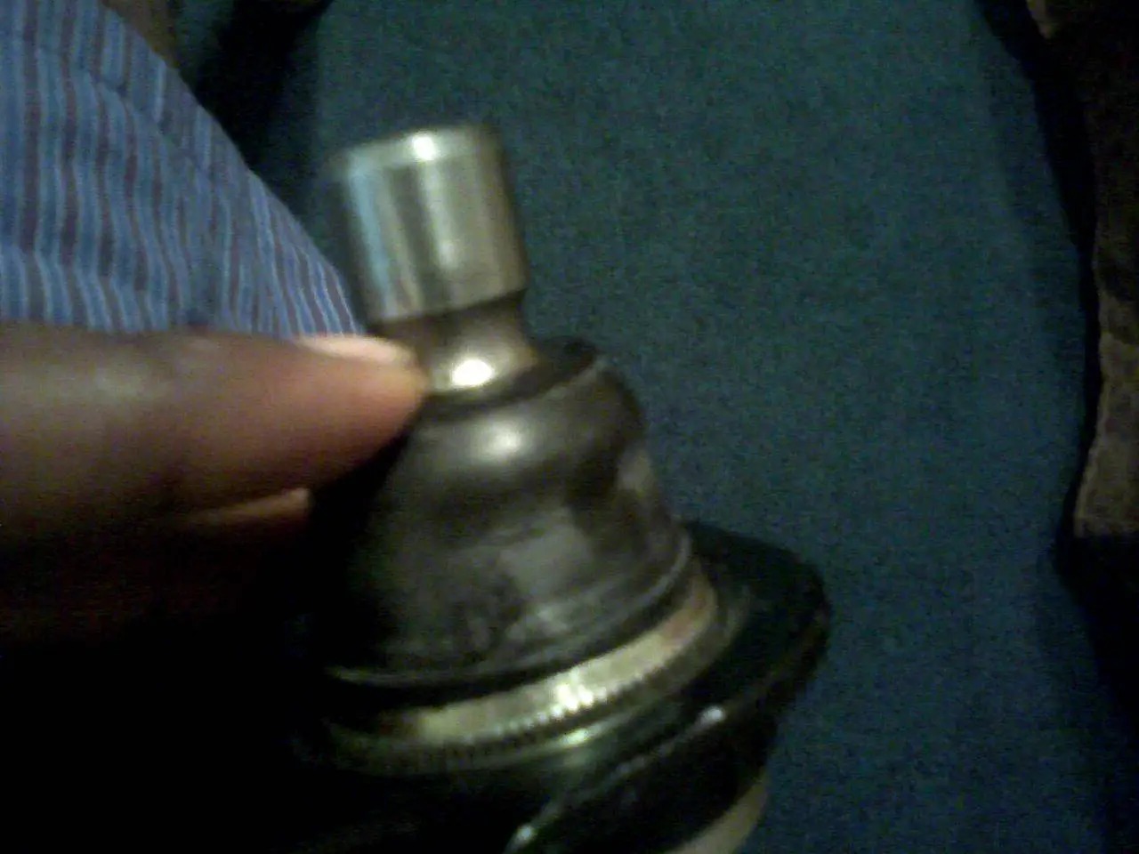

i bet its becuase the clamping bolt that i ddint remove, but onyl un bolted runs through this grove on the balljoint??
so, did you figure it out, red? looks like you have to remove that bolt, not just loosen it.
