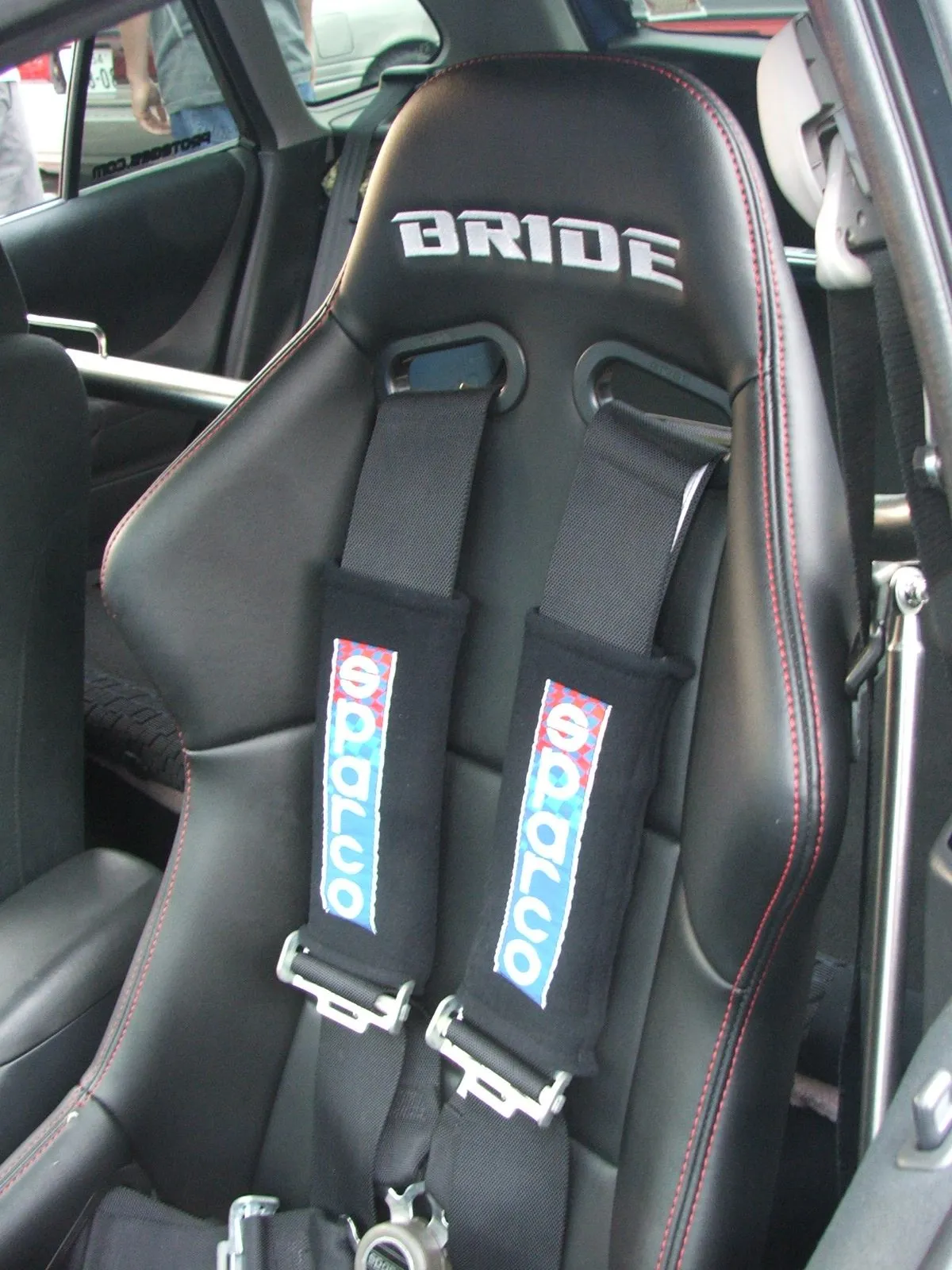

The sparco wrx harness bar will work. I know this for a fact because I've had one in my car for over a year. I've had many a member PM me about this after seeing it in pics of my interior. You will need extended bolts for the b pillar, and spacers to accompany them. You also might want longer bolts for the base of the support tubes. You can use the stock seat belt bolt position there, but the stock bolt is not long enough if you also plan on anchoring a harness belt there also. The install is fairly plain and simple. Follow this pdf of the install instructions for the wrx as a rough guideline:
http://www.sparcousa.com/resourceFiles/42.pdf
If you can't obviously tell from the instructions, you need not do step 3 as you will be making use of our stock seat belt mounting location rather than cutting the carpet or w/e you have to do for the wrx.
I hope this information helps. I too was looking for a harness bar solution when I came across the "rumor", and decided to take a shot. It works:

<-- owned lol. That bar is soooo similar to the wagner bar, and the pictures I remember of it. The car it's installed on has black sparco seats just like those, the bar was black, the support tubes mounted in the same place, and the radio looks very similar to that of a protege's. If I had looked closer though it's defiantly a wrx. Anyways, getting in and out of the rear seat isn't any different from stock.... well nearly no different. Might be easier since you have something to grab onto lol. However, something I didn't consider until after I installed the bar was this. Yes, there is still lots of room in the rear seat for passengers, but what would happen to them if you were in an accident? Would it be very safe to be seated behind that bar in a head on collision? I'm always very weary as to putting anyone in that rear seat now.
