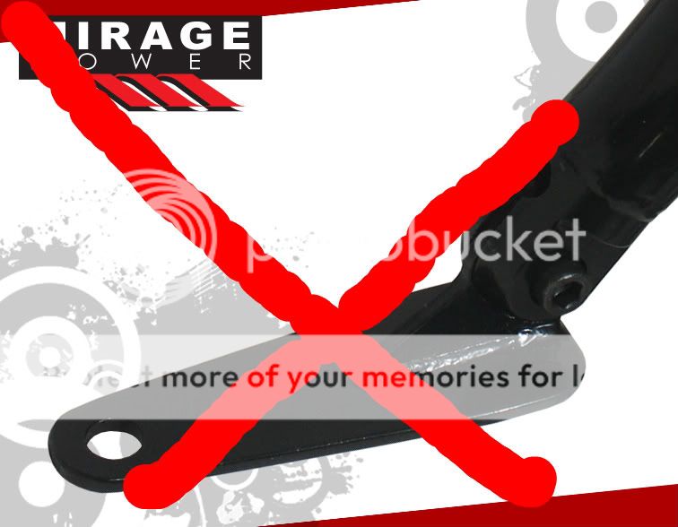

When looking for the harness bar make sure you get the one with the welded ends. Not this.

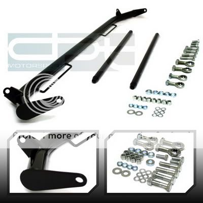

This is the one you want.
