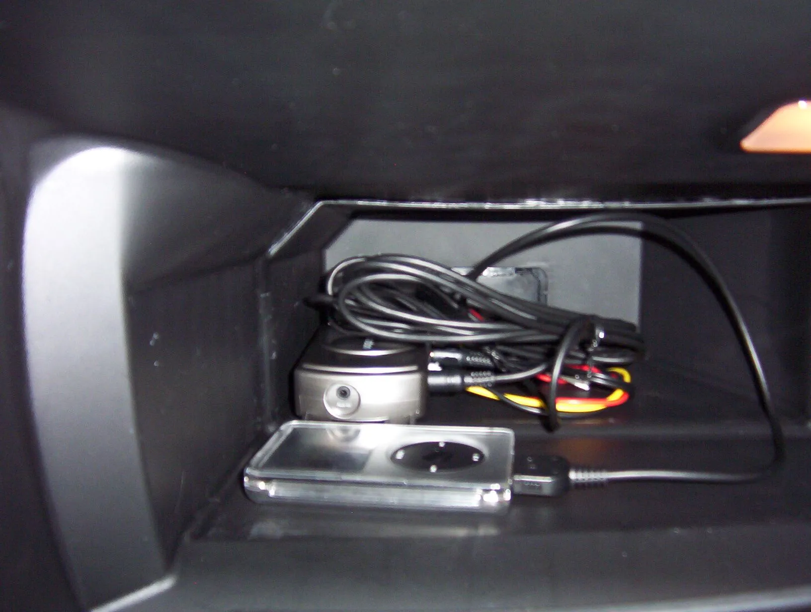

oh, btw, if you wanna see pics of my install i can send it to ya. i put the brain in the glove compartment (works well for hiding wires) the display is on the dash right of the steering wheel and the knob is between the cig lighter and the passenger airbag light.

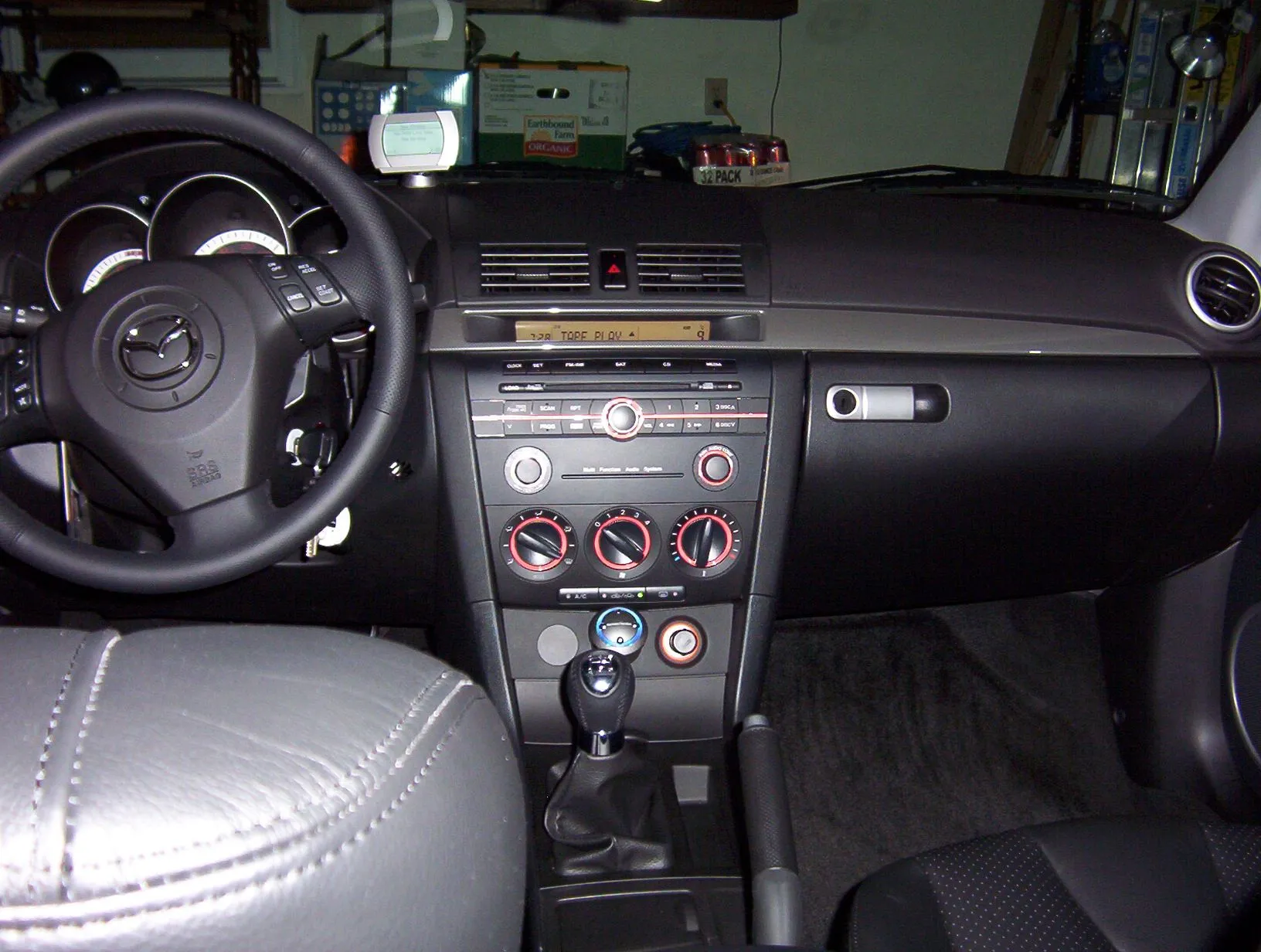

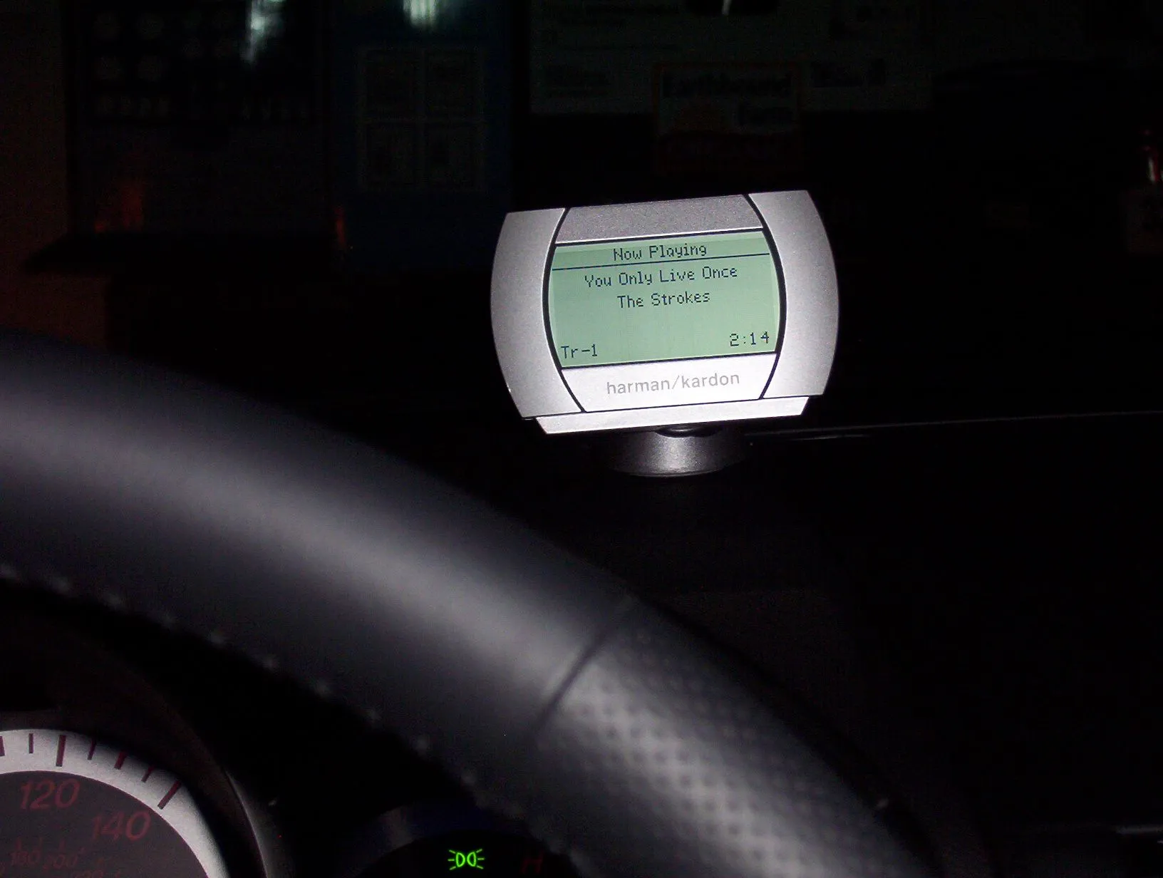

i attached pics of my finished install...
basically i ran everything through the little flap in the back of the glove compartment. i snuck the wire for the display through the vents on the dashboard, and the control knob i drilled a hole through the plastic.
