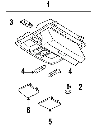

Good idea, thanks. What is the best site to find OEM mazda parts with diagrams?
EDIT: I went to mazda-parts.com and found the attached pic. Does it look like the clips are in front (ie, facing front of the car) of the console to you? Tough to tell because you can't see the back.

Any idea if that screw in the diagram has to come out first?
i would assume so but keep in mind i do not own a cx anything so just be careful when doing so. My friend has wired his TOMTOM and scangauge(i think thats what its called anyways) in the same way on his 3! I might do the same later on down the road.

Anyways, thanks for your help. I unscrewed the two screws, which loosened the assembly, and then pulled it down by working the headliner over the clips in the picture with a flat head screwdriver. Even with the screws removed it's still tough to remove the assembly.
