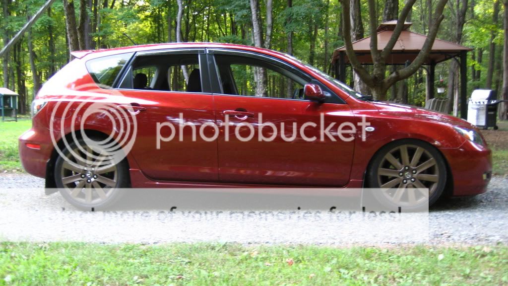

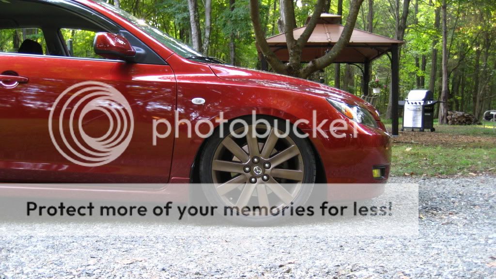

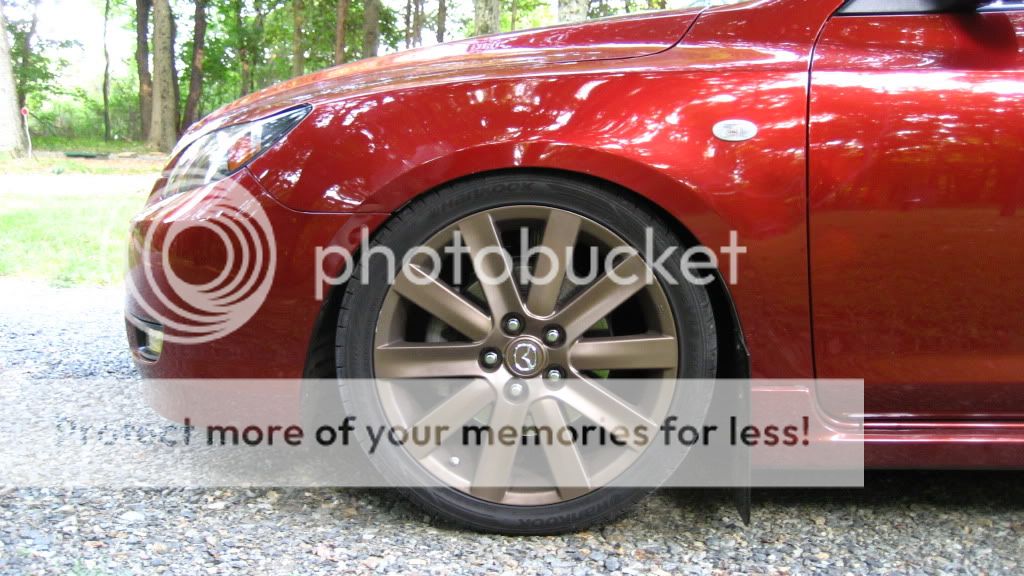

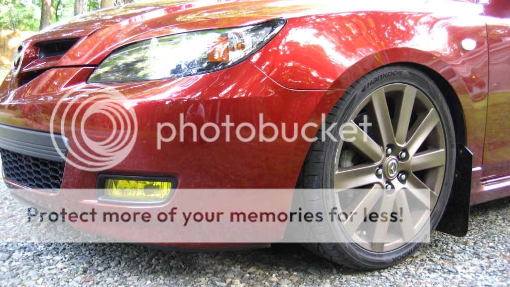

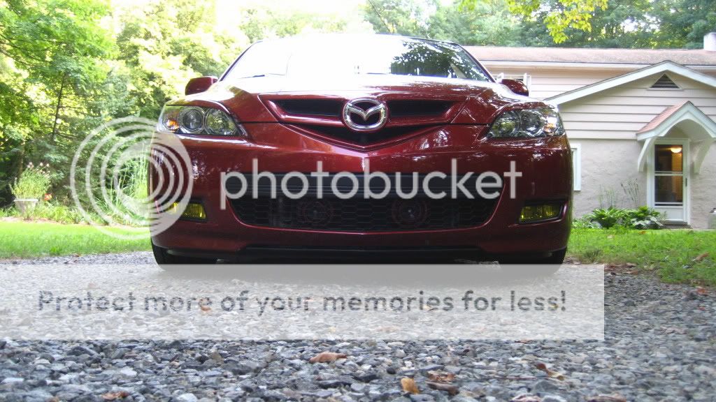

H&R's sure go down in the front. (godown) It's JUST tucking the tire tread. It rubs like crazy on the inner fender liner while rolling but not on the outer fender. I can turn to full lock in either direction without rubbing. I'll either persuade the fender liner with my BFH or raise the front up a little after I see how low the rear will go.
Rear install is tomorrow. I already got the more difficult rear camber arm installed today so hopefully tomorrow will be smooth sailing.

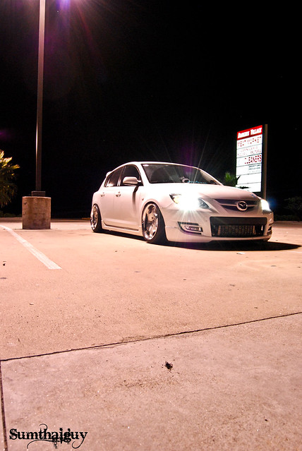

i would say BC's because of the adjustability features that the H&R's lack. mainly front camber and dampening/rebound all around. i know many just set it and forget it but i think its better to have the ability to adjust more if needed/wanted. especially if you go looow, it will induce a lot of natural camber. then youre stuck there unless you get the kmac plates.
i havent had any problems with my set and mine go pretty low lol. granted im on the "low" package from BC and custom shorter springs for ultimate adjustability in the front.

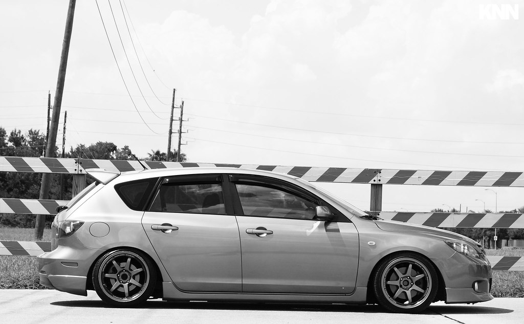

more @ http://www.mazdas247.com/forum/showthread.php?t=123781872

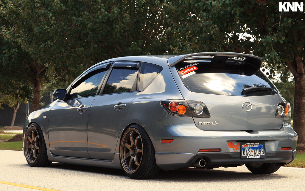

buddy's mazda3 on regular BC's. and keep in mind that hes on 17's

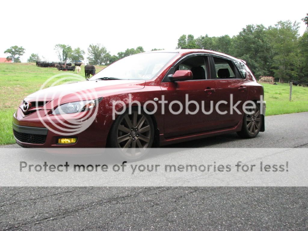

Once you install the rears, because the angle of the car will change the front won't seem quite so low, but that's still pretty tight to be practical for the street.
Looks GOOD, though. :D

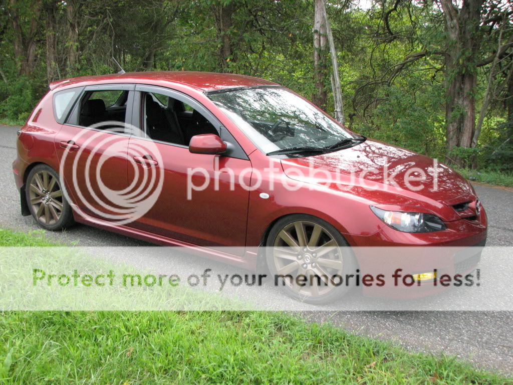

Getting the rears on definitely evened out the rake. It's a little raked but the front needs to go up for winter so I am not too worried about it. Most of the rubbing is gone though. It only rubs while turning aggressively above 30mph. In the spring I'll probably remove the adjustment collars from the rear springs to see how low it gets then.
I am very impressed with the ride quality and handling. It does not hover like some cars slammed on coilovers do and the ride is very nice and stock until you hit a bump. I think it will be smoother when I raise it up for winter.
If it's only rubbing on the very inner part of the fender liners, you could try adding small wheel spacers (either 3mm or 5mm) so the tire is in the taller part of the well. Look at how it's rubbing to see if that'd even help or not though, but it might. My 18x8 rubbed the liners up front in similar situations (rarely, but it was possible) when dropped on coils at +50 w/ 225/40/18... but at +45 they never did. And now they're at +40 and still don't (but with more than stock camber).
That's a good idea. I'll have to see where the majoriyt of the rub marks are when I take the wheels off again.
