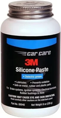

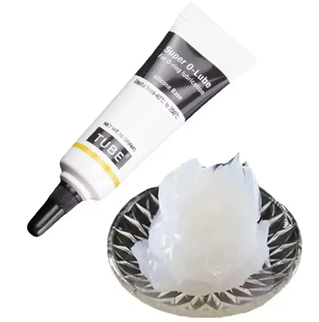

Hey,
I want to grease the guide pins in the caliper and wondering if generic silicon grease for rubber up to 200 degrees should be enough for this job
Thanks

No, I’d go with a grease that is specific to brake applications. That will ensure the rubber doesn’t swell up or crack due to incompatible grease. I’ve used both CRC and Permatex and they worked great.
