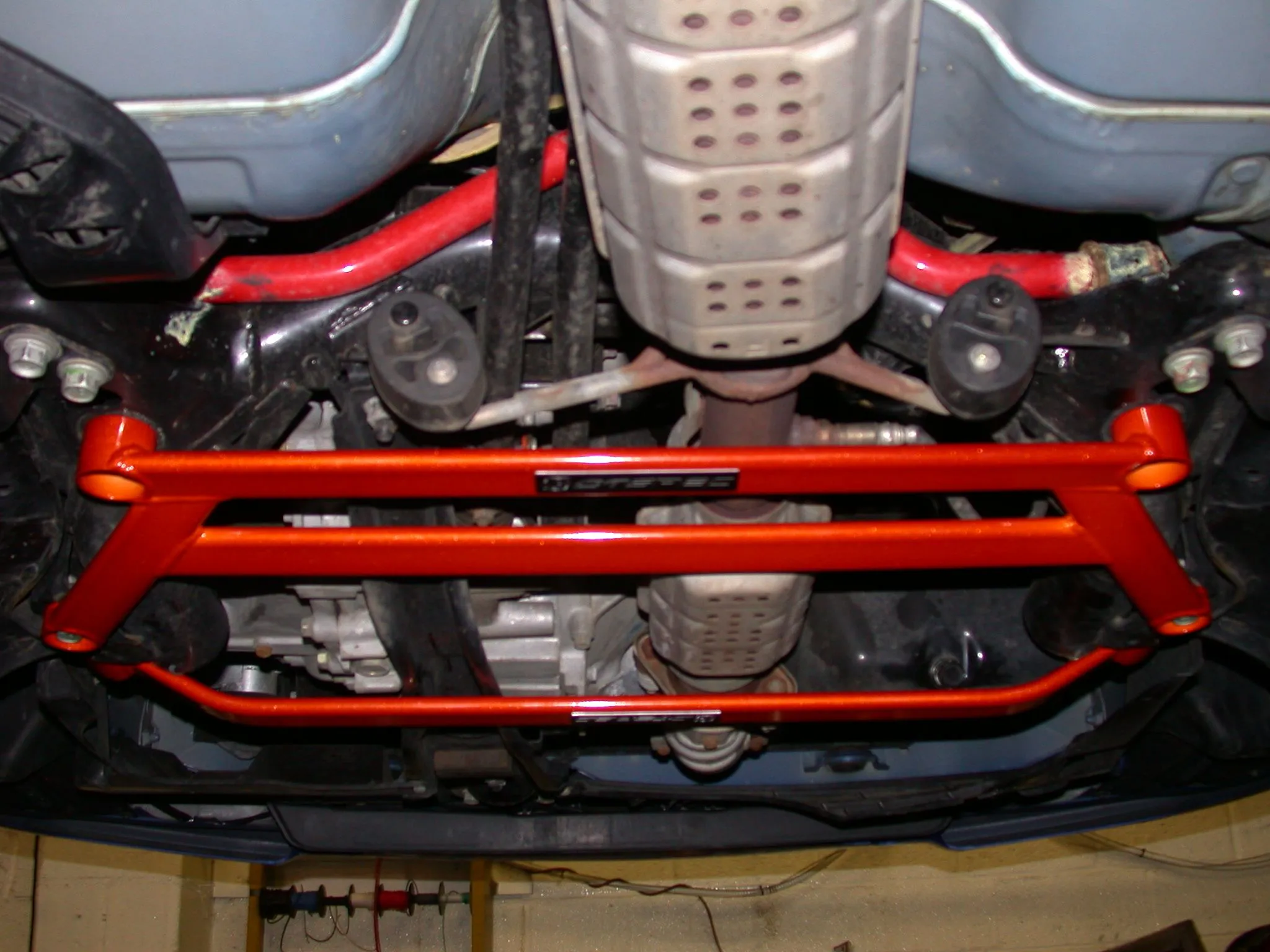

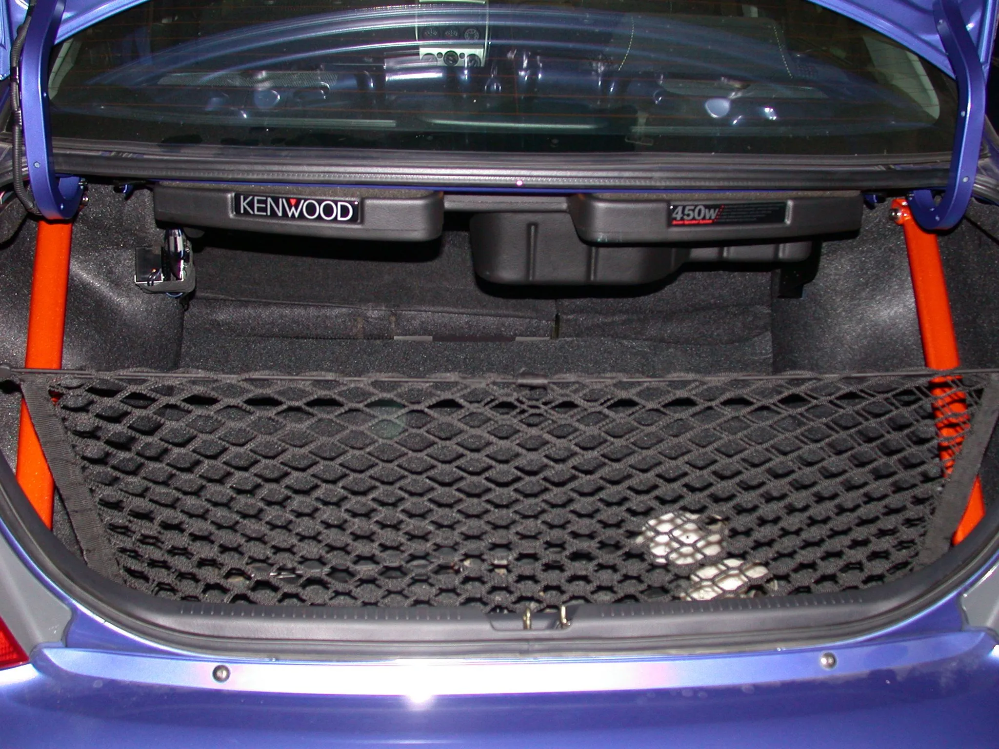

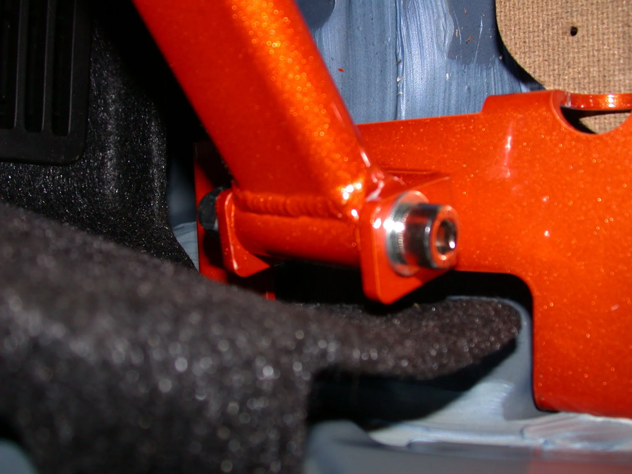

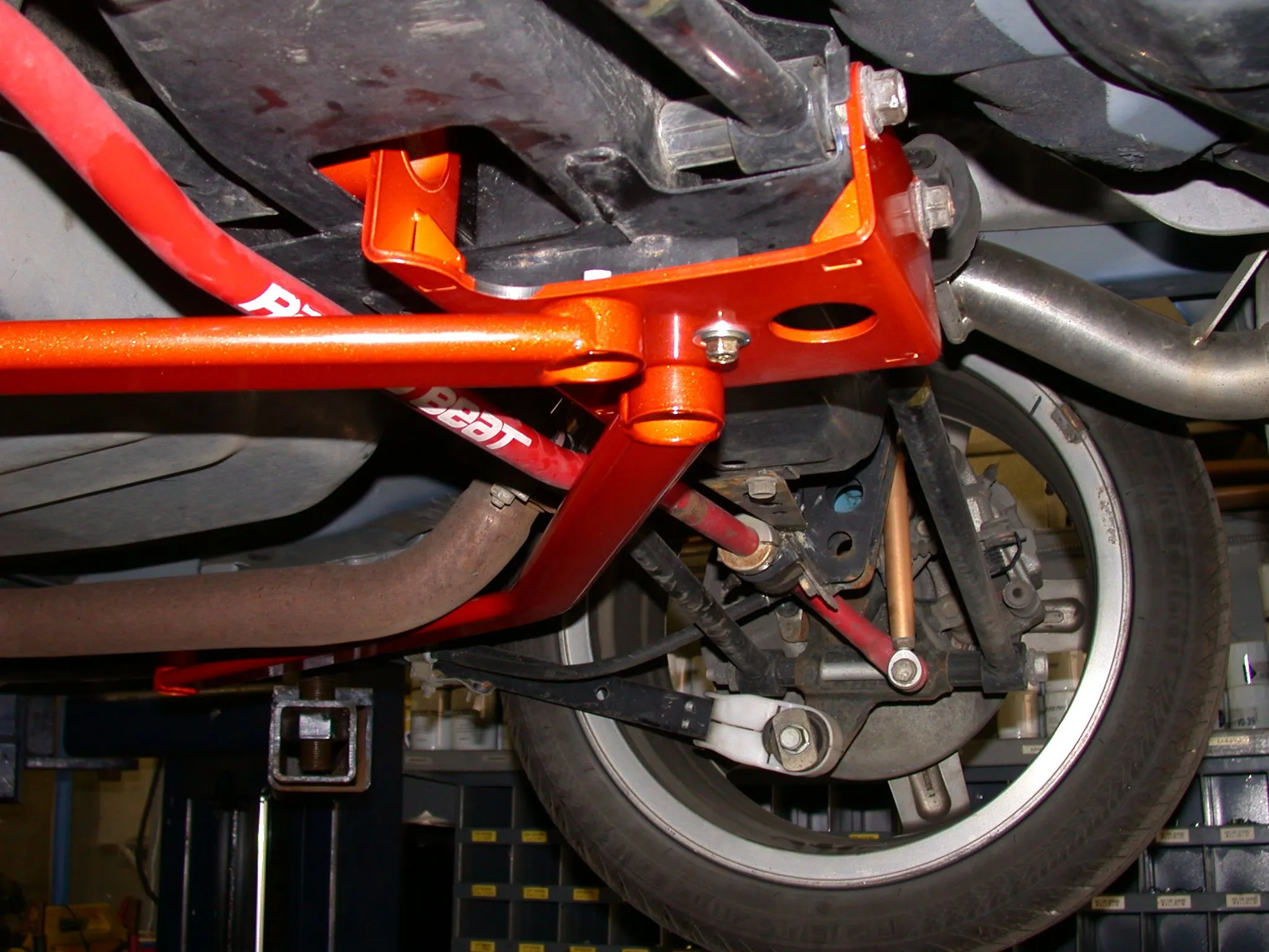

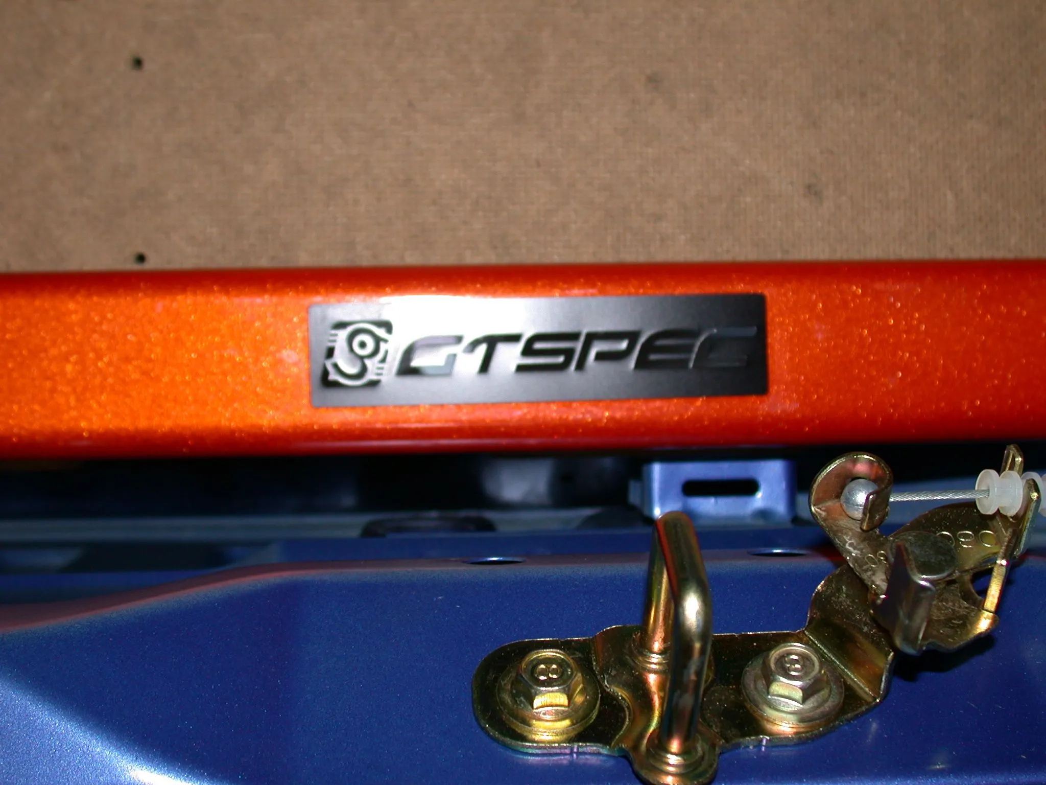

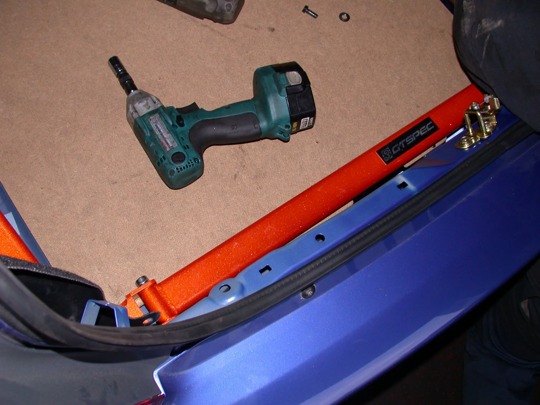

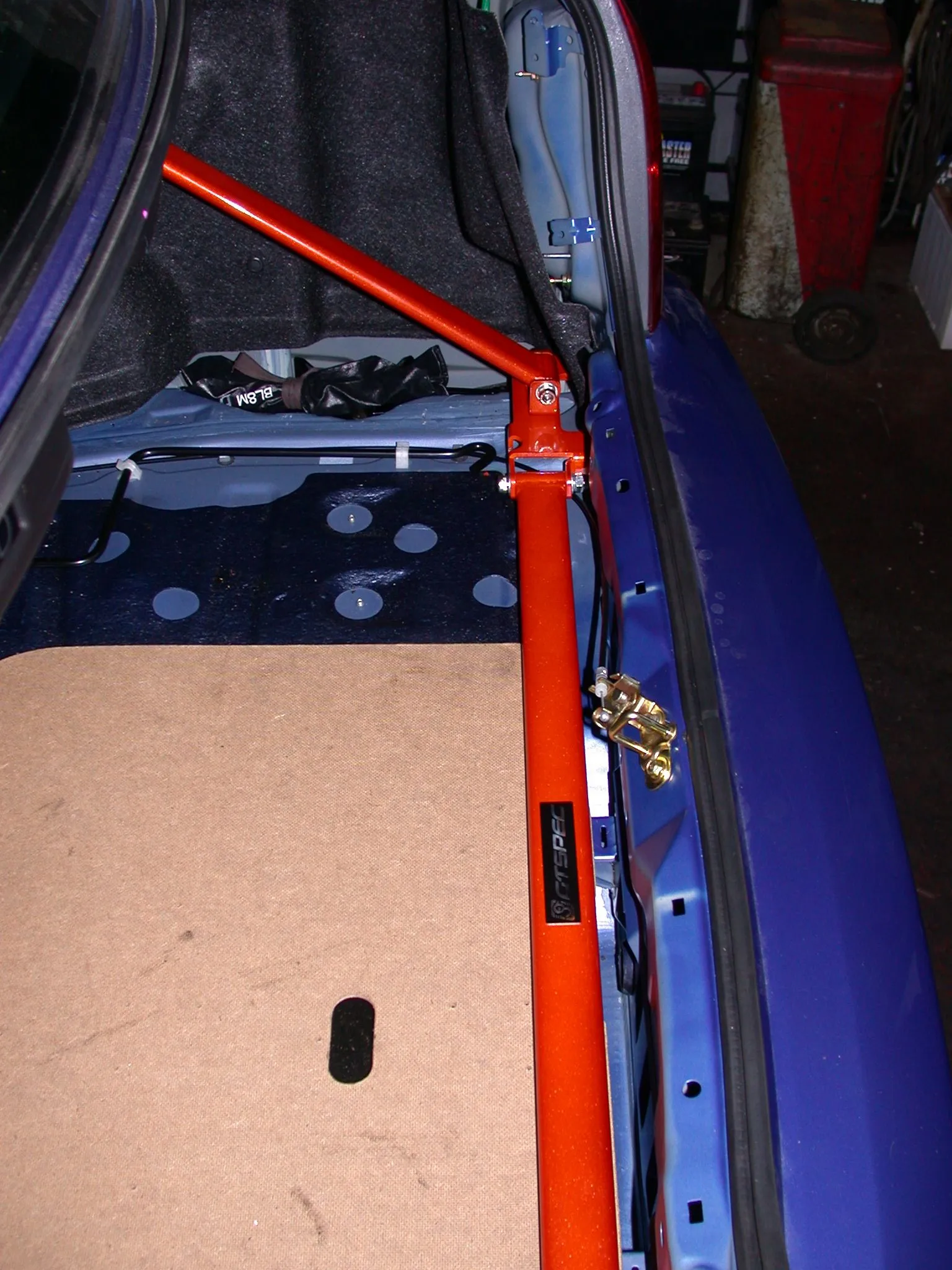

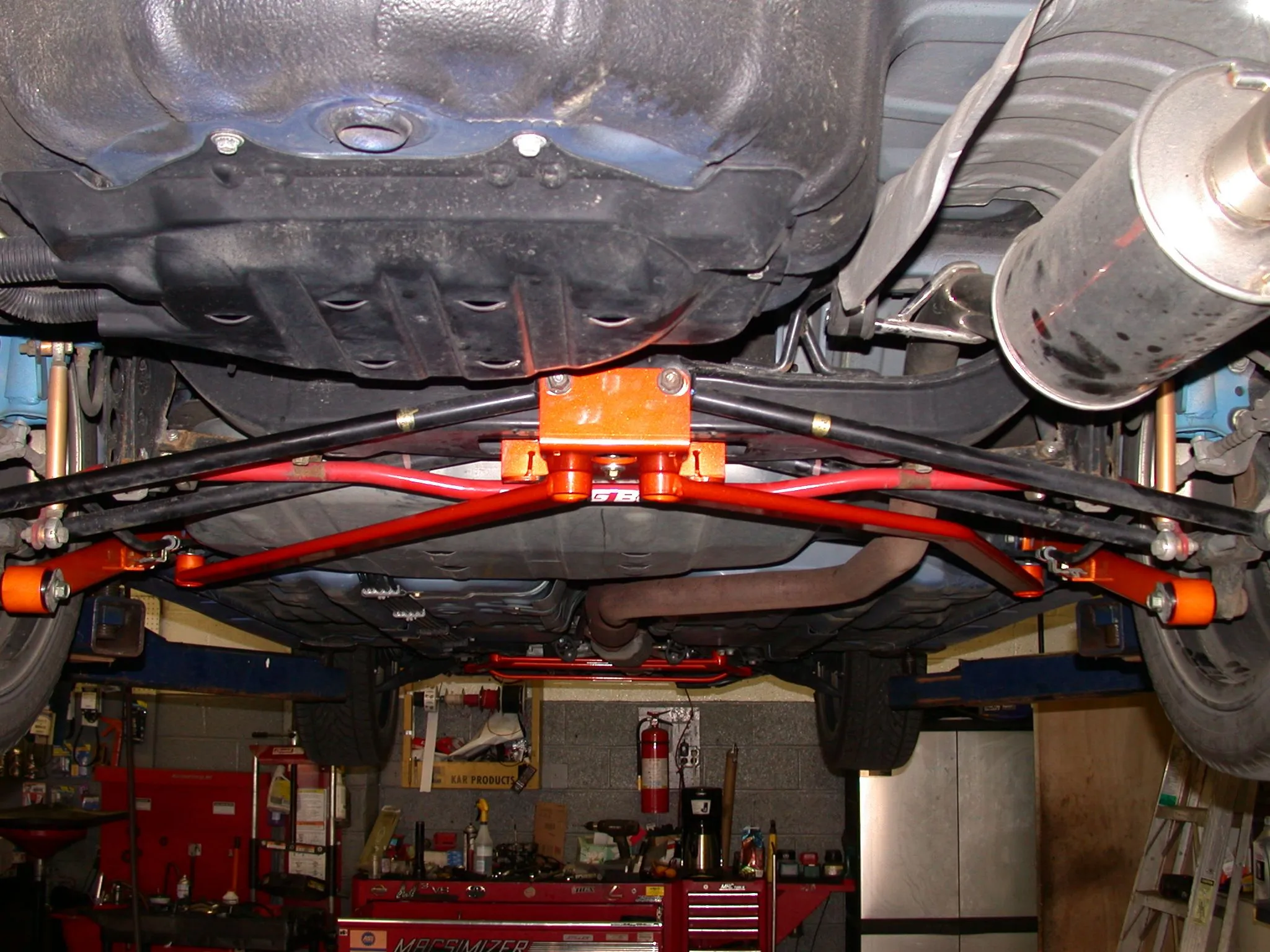

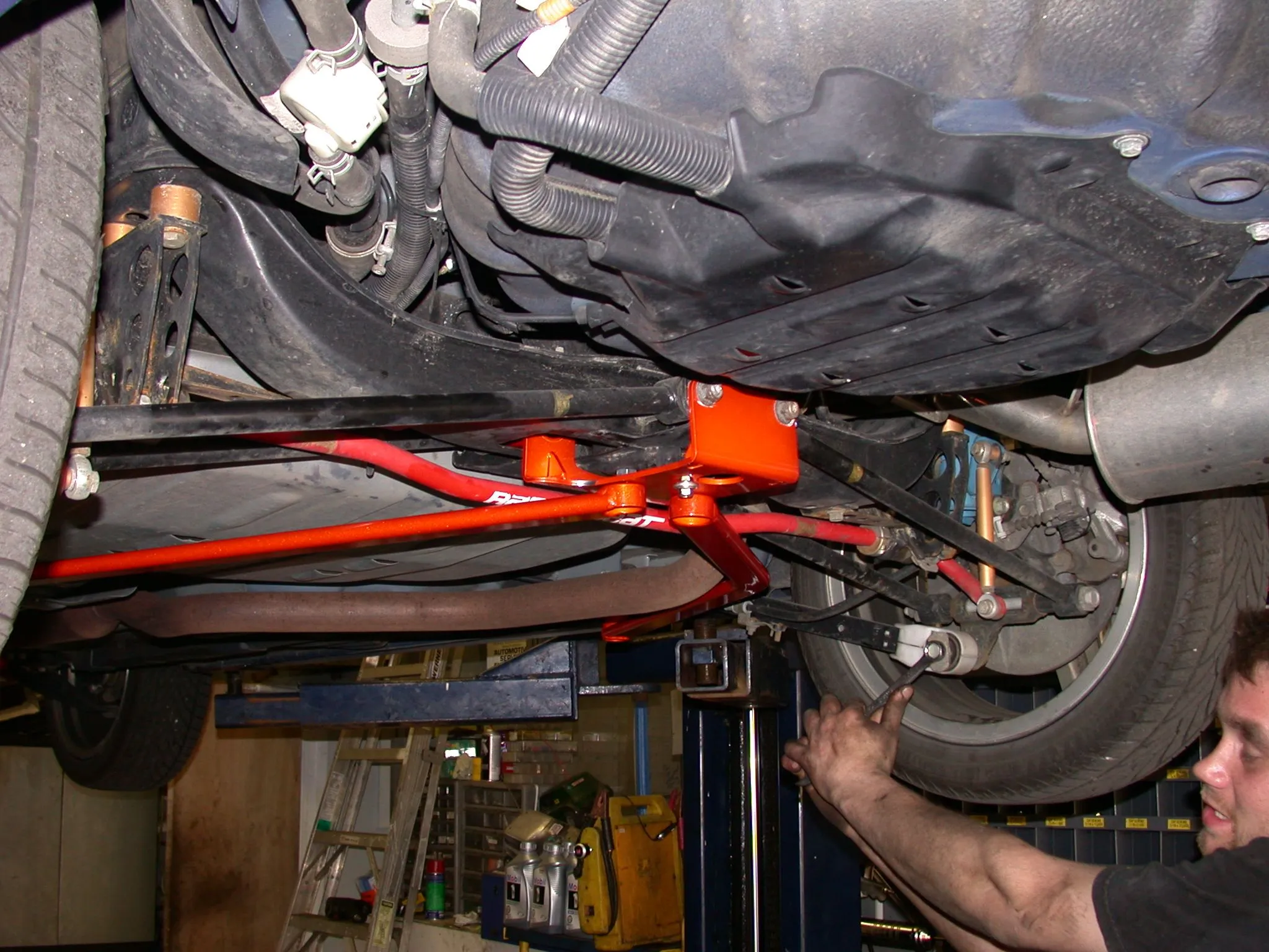

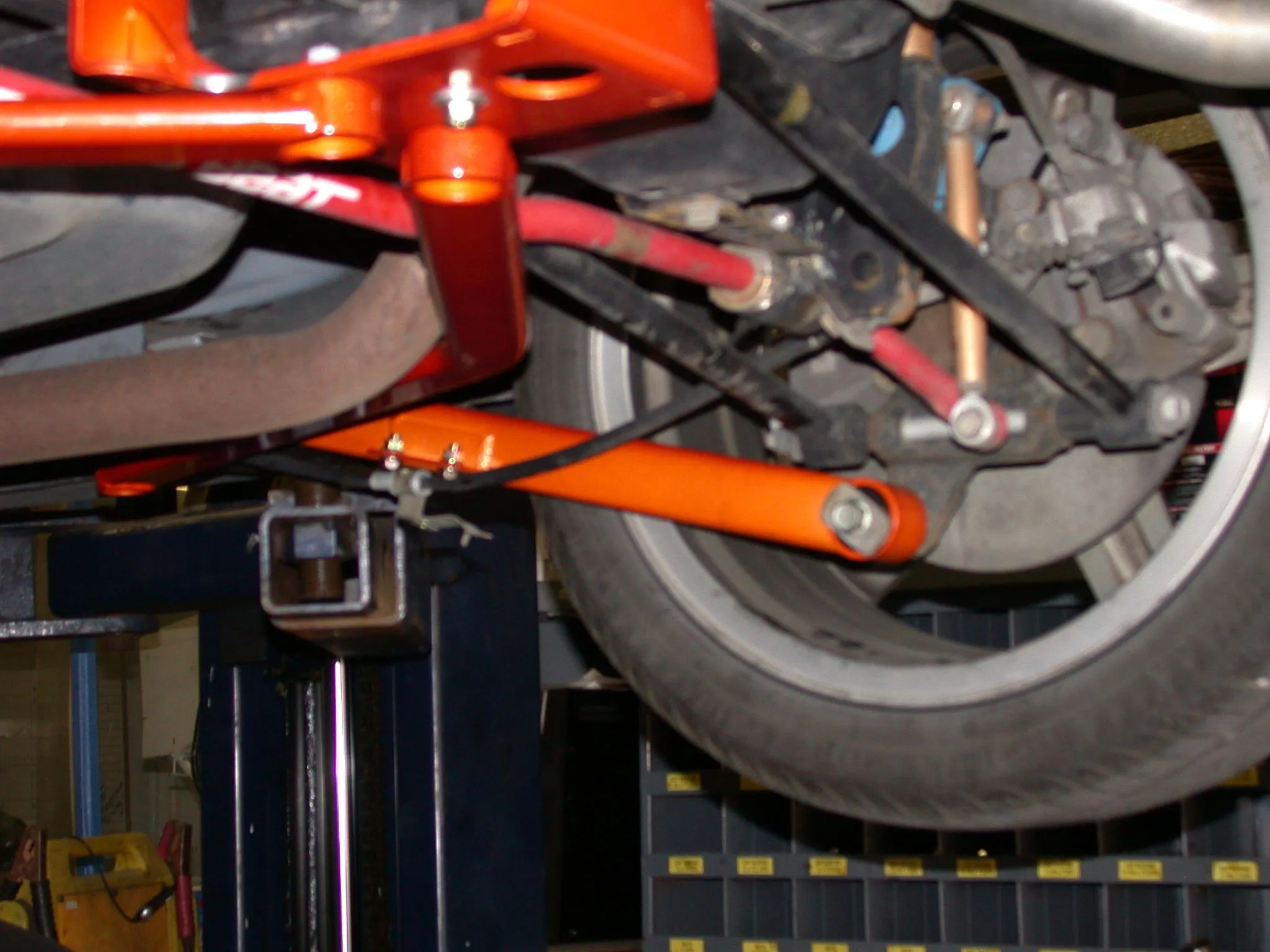

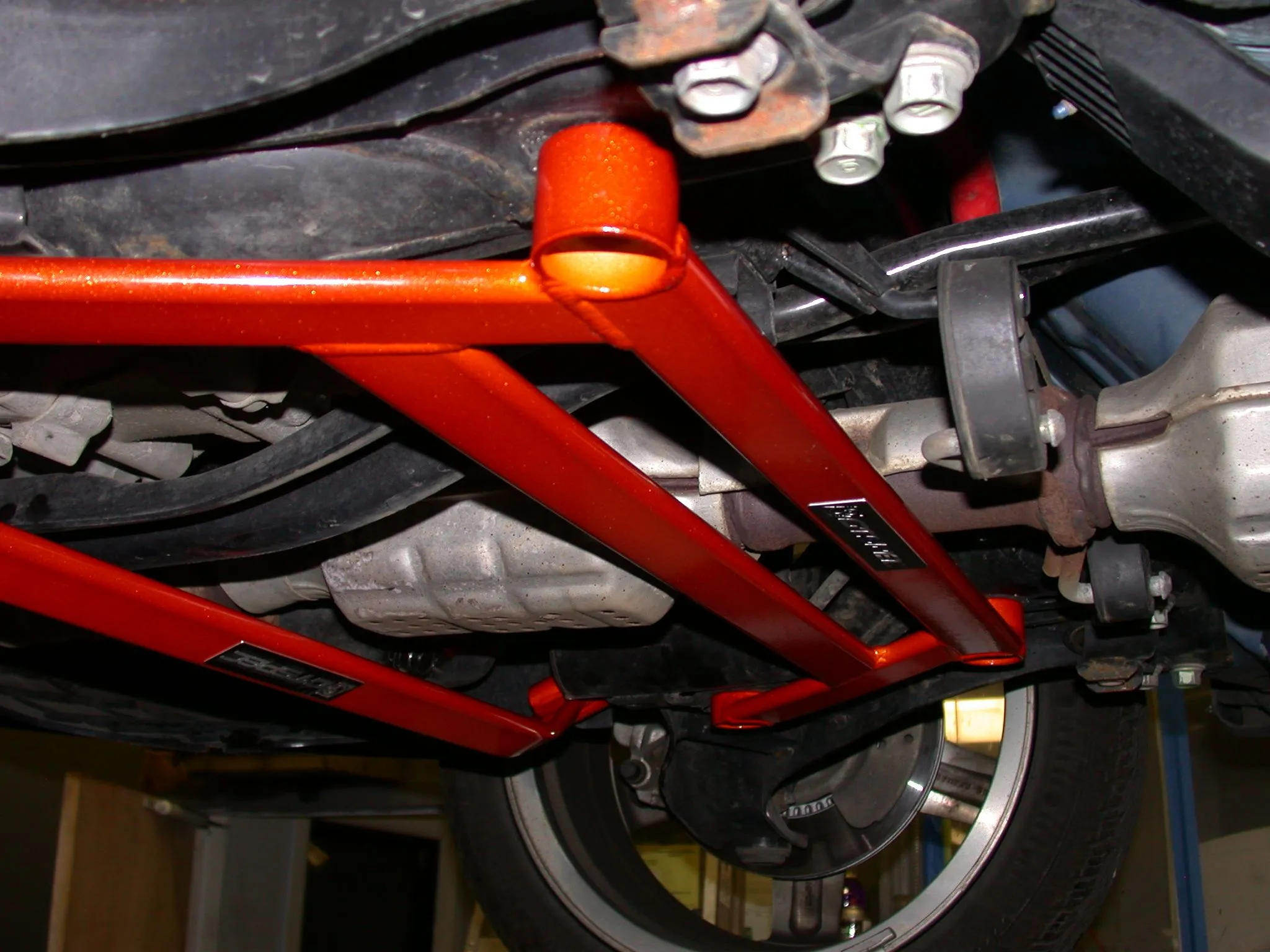

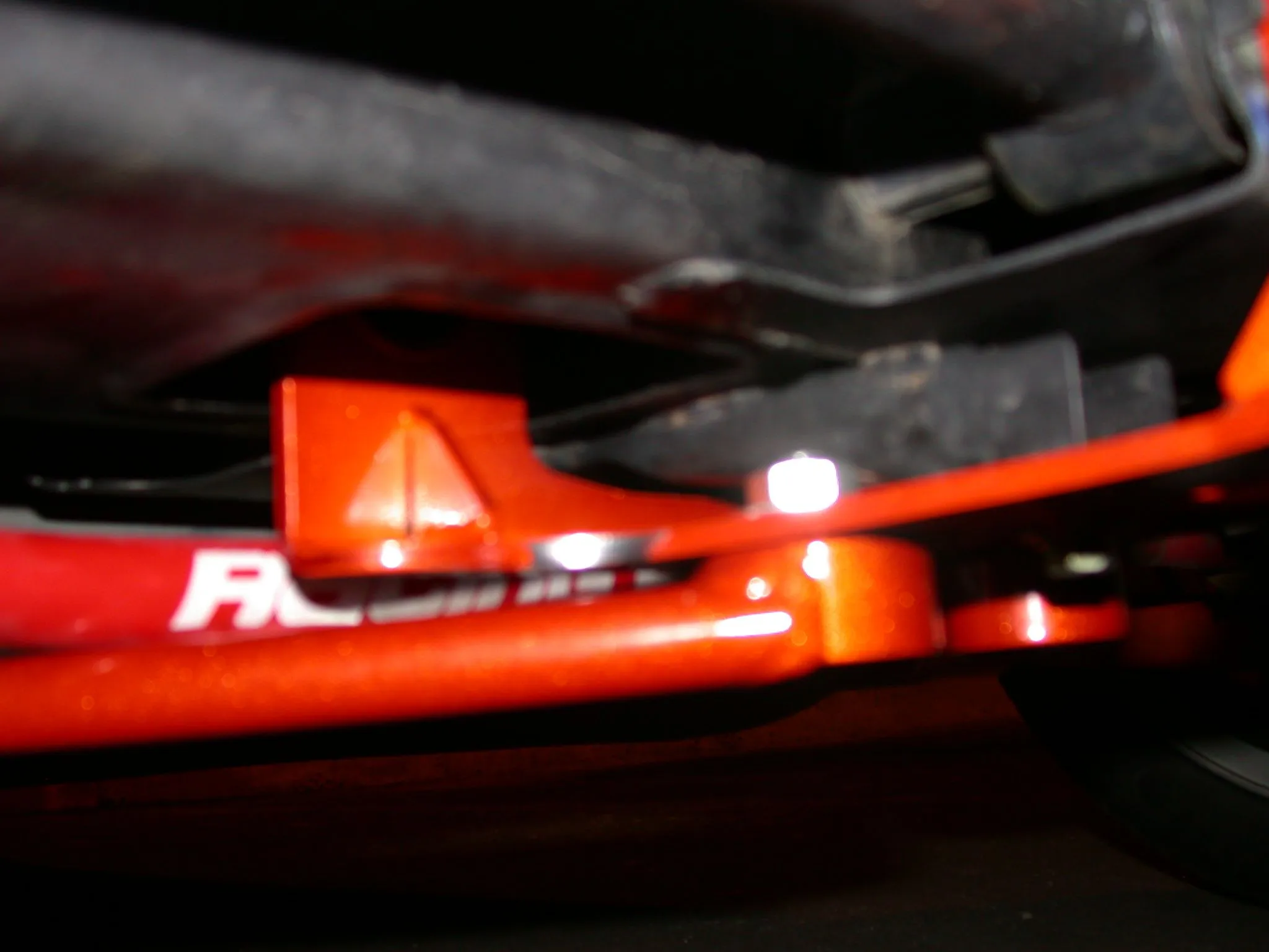

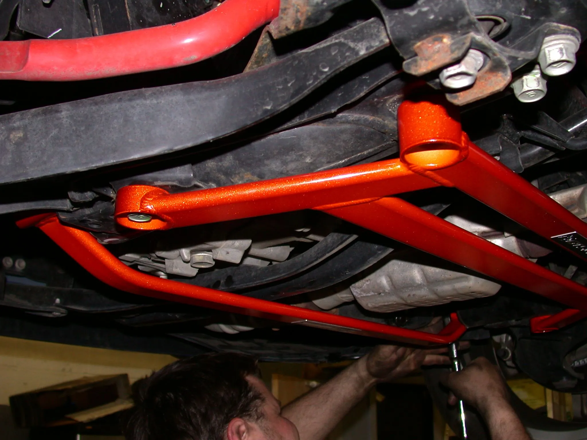

Just got the parts installed. Again props to Jayson from Ravspec for his customer service and a great price.
The following parts were installed:
4 Points Ladder Brace
Front Lower Tie Brace
Front Strut Brace
Rear Link Reinforcement Panel
Rear V Brace
Rear lateral Arm Brace
Trunk Reinforcement bar
Lateral Linkage bar (trunk)

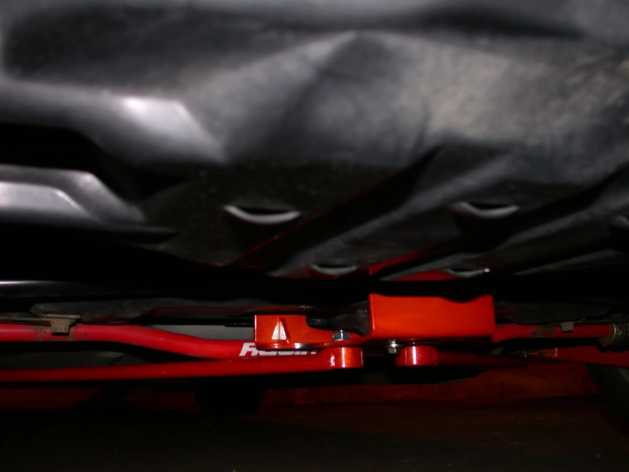

There was only one major problem with the install that we didn't expect. The Rear V Brace hits the rear sway bar due to Dave's Klunk fix. Maybe some kit of spacer will fix that problem. Other than that I'm happy with the kit.

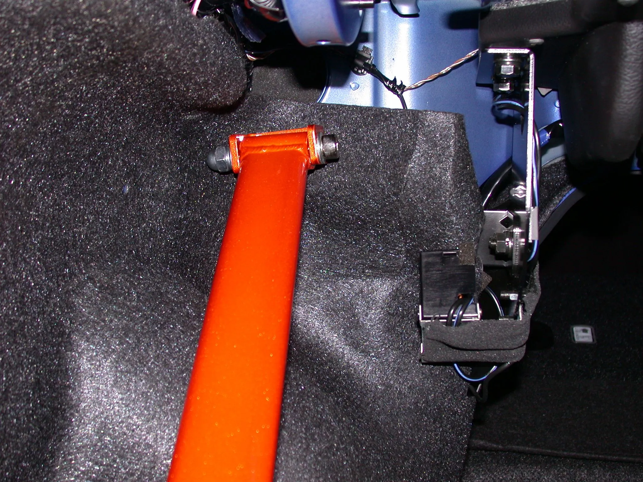

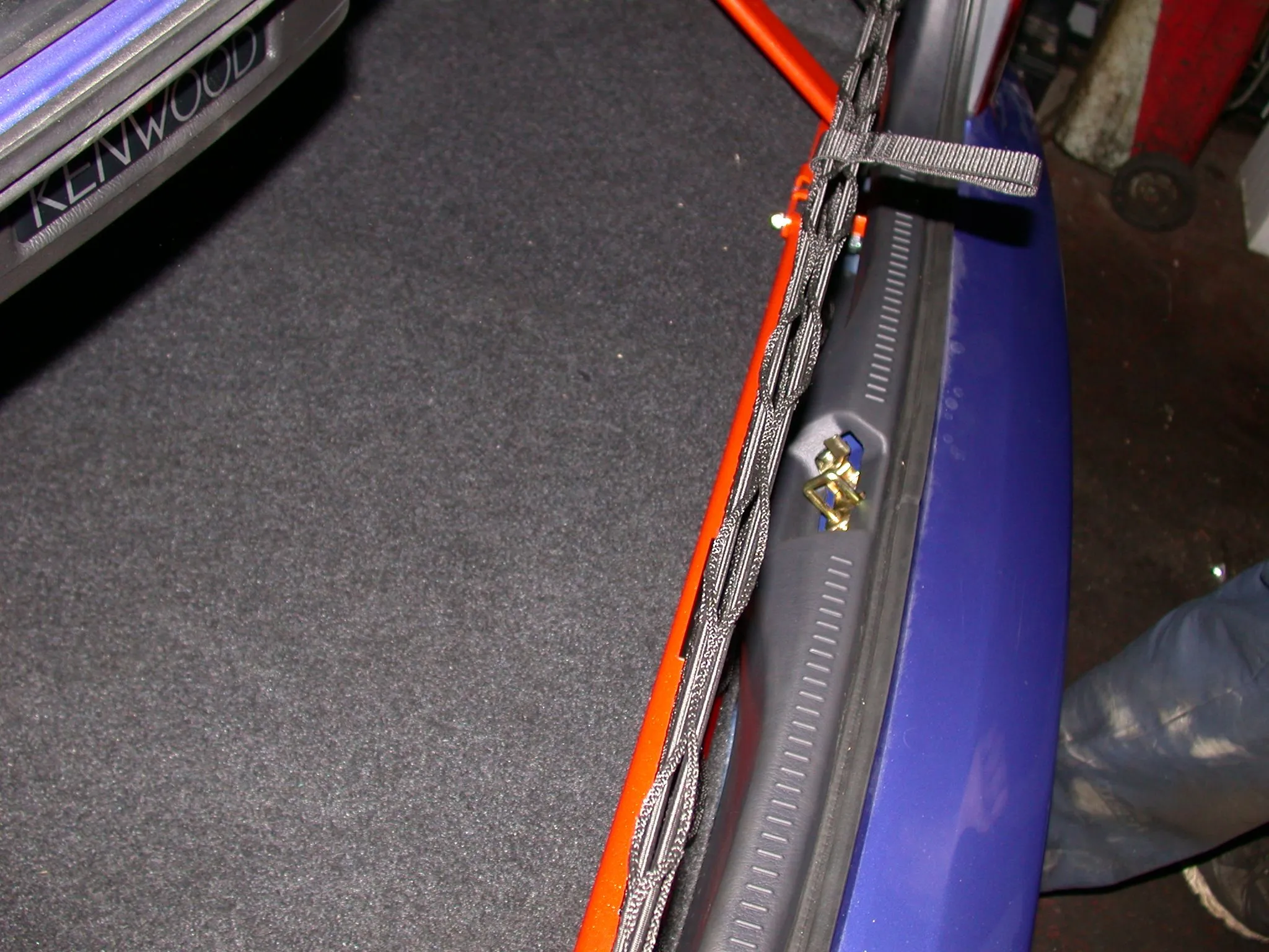

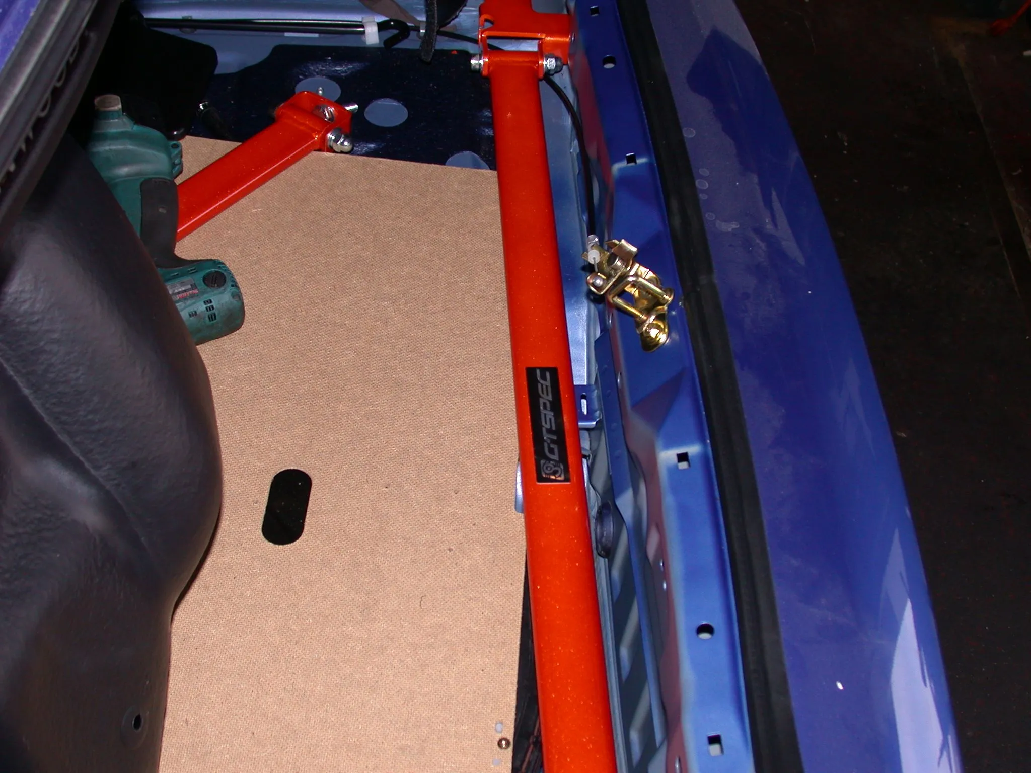

I tried to install the stuff myself, but ended up at the mechanics the next day. The bolt underneath the car was tight and I couldn't get the car up high enough to get the breaker bar in correctly. If you have the tools and you feel confident in your skills then it's not too bad. The trunk bars did require you to cut some of the plastic off (the piece that holds the cargo net). For the cross linkage bars, we needed to drill a bigger hole, since it was made as a direct bolt on to the rear strut bar.
I just need to fix that popping noise and then I will be 100% happy with the results. Maybe the endlinks need to be checked.
With just a 5 min impression, I believe it's a moderate increase in handling. I still haven't had a chance to take it to my fav spot yet.
