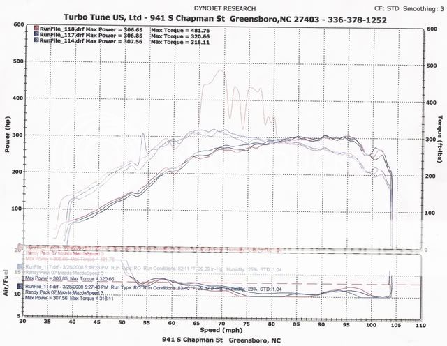

UPDATE
heres my numbers....BUT I believe I had a boost leak on the dyno. Two nights ago after having violent fuel cut for 2 days in 40-45 degree temperatures.... the leak turned into a breakdown. The intercooler hose blew completely off the throttle body. I had only put about 20 miles on the car before the temps dropped the following day. So either the hose came loose parked during the night, the drive home, or I was leaking on the dyno. Plus.... I am currently running about .5-1.0 point higher on my a/fs(wot after boost hits) than what we tuned for. this would lead tyou to believe..... boost leak!!!
After reattaching it.... SECURELY!!!. My fuel cut was gone and the car was considerably faster than it had been the day it came off the dyno. Its evrything I had hoped.... and more. Its frightening. Ive been driving it hard the last two days.... VERY hard. No problems with the engine.
Car is at 18 psi... no boost leaks. Running fine. Fuel added low, pulled high. Timing advanced 1 degree up top. Ive got endless discussion on the other board. But heres the graphs of the original dyno session done last friday.
I hope to get new graphs up next week. We still have work to do. Im posting these dynos, but I do not consider them indicative of the power Im currently making
Also consider this dyno is notoriously low. I have made 10-20whp more on the other dyno in town. Derek88, my buddy here, made 248whp on his peak run with mscai, racepipe and an iced intercooler on the same dyno. He was lower before we iced it.
fwiw....our cars are at about 3100rpms at 50mph..... 6000rpms at 95. We were running it right up to the rev limiter. Sorry I have speed instead of rpms in the a/fs.
Can't wait for the new stuff. I'm really glad you're taking such a cautious approach with this new snail. I have high hopes for the new graphs.
ahso......damn, we if you could get a higher res image? I wanna rub this in my s2000 loving friends face.
dude... wait till I dyno again. I had a boost leak with this one. I'll give you a dyno over 350whp, when I get back on. I gaurantee it. It'll be within the week.
Wow the A/F in these cars are crazy! Once the reflashes come out you should be able to tune it even better to keep the a/f above 10.5.
